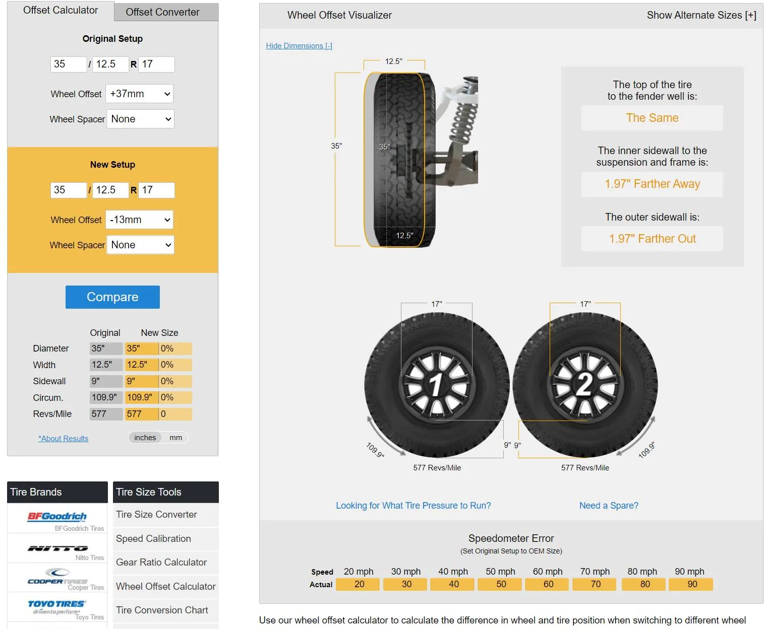

People Work?
Stock Mojave Rims 7.5"/ +37 mm offset
New rims 2" wider (1" each side of centerline) -25mm
+37-25 = +12 (to maintain same outer and inner)
You're buying much more negative offset (poke) than you need to buy.
12.5 tires will naturally relax a bit more on the wider rims, but a 0 mm offset would be much more practical and functional, without throwing so much force away from the hubs and adding undue stress to your components. Plus, it will keep more tire under the fenders and reduce winter slop and mud on your doors and rear fenders.
Also check your state's laws regarding tires protruding beyond the fenders.
