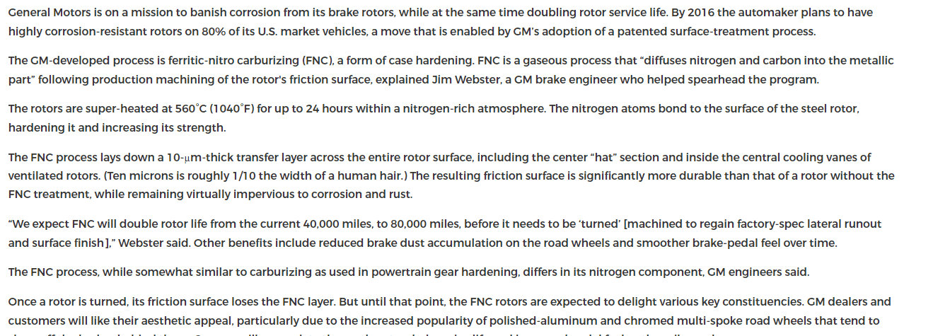

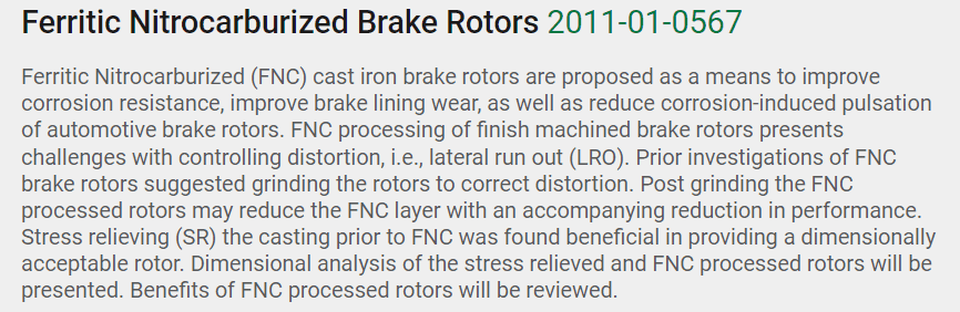

You aren't doing road rally or circle track racing, etc.
I just can't see any need for fancy FNC coating when your truck won't be sitting on a lot, or sitting around in weather to worry about rust. Wear? Look how long the originals have lasted.
Stock brakes are more than fine - the coating isn't going to give you "better" brakes, just that the rotors will resist rust when sitting, and MAY, I said MAY, last a teeny bit longer. OTOH, my bet is that I could take your current rotors, refinish them and get another 70-80K out of them.
Skip the coating unless your truck sits a lot in moist conditions.
IMO, a lot of what people do when talking about "I put better brakes on" is more some sort of "look, mine is now better" when they likely won't stop any better than mine will.
Then ironically, they make braking worse by much bigger, heavier tires and wheels. There goes any advantage they thought they had, OTOH, at least it will stop as well as a stock JT would.
Skip the FNC, IMO.
May still be some work to do on them. They may give longer life, but not necessarily better braking.

Looks like it's more for appearance, perhaps longer life (40K to 80K miles? Geesh, I beat that easily already)

The coating on the rotors gets removed soon as you go down the road. The pads remove it. You can get the rotors cut. Just have to watch out for how much metal was removed. I haven't really looked into the brakes yet for the JT. But from what I've seen. The rotors are all the same for all models.
