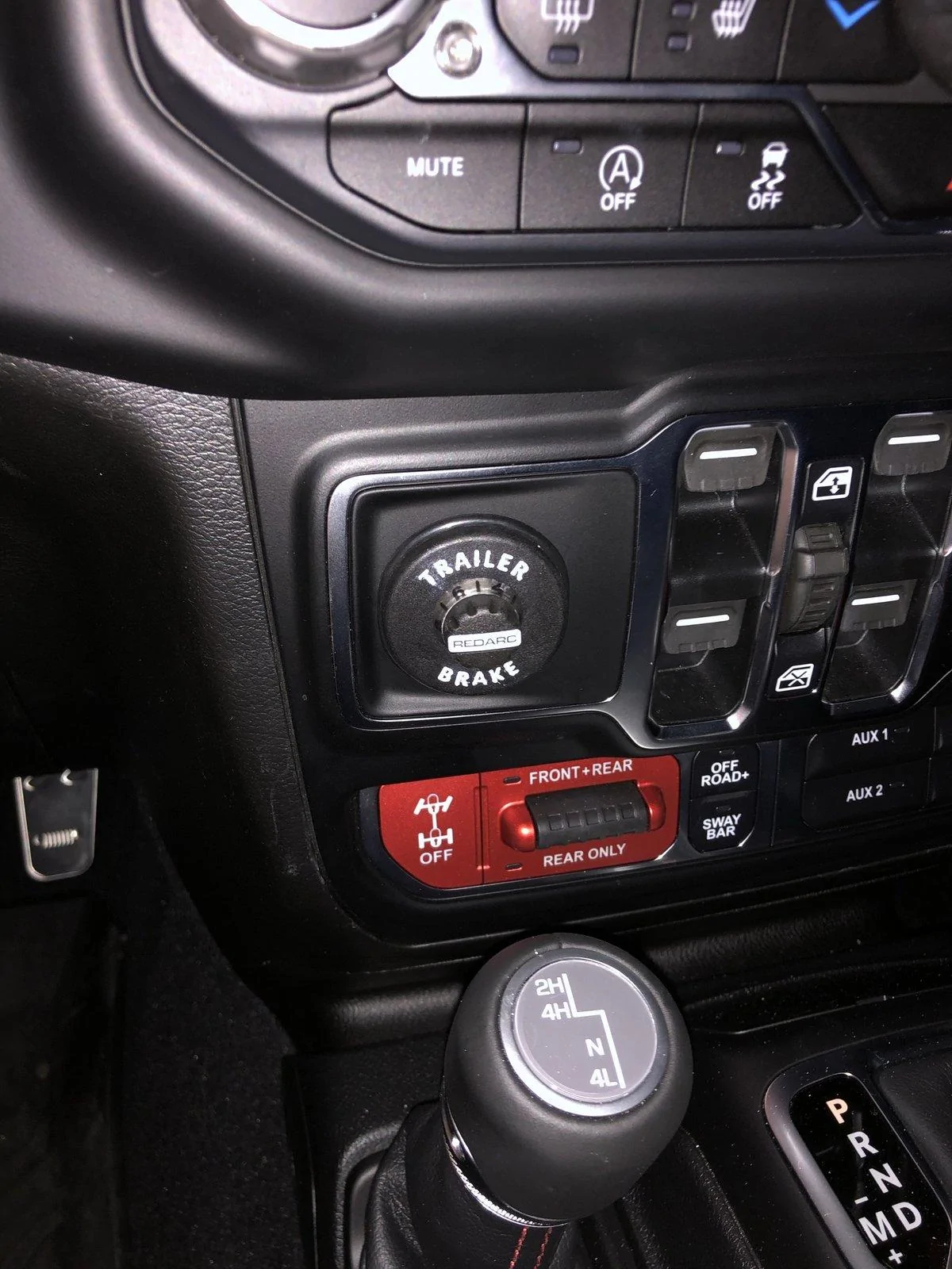

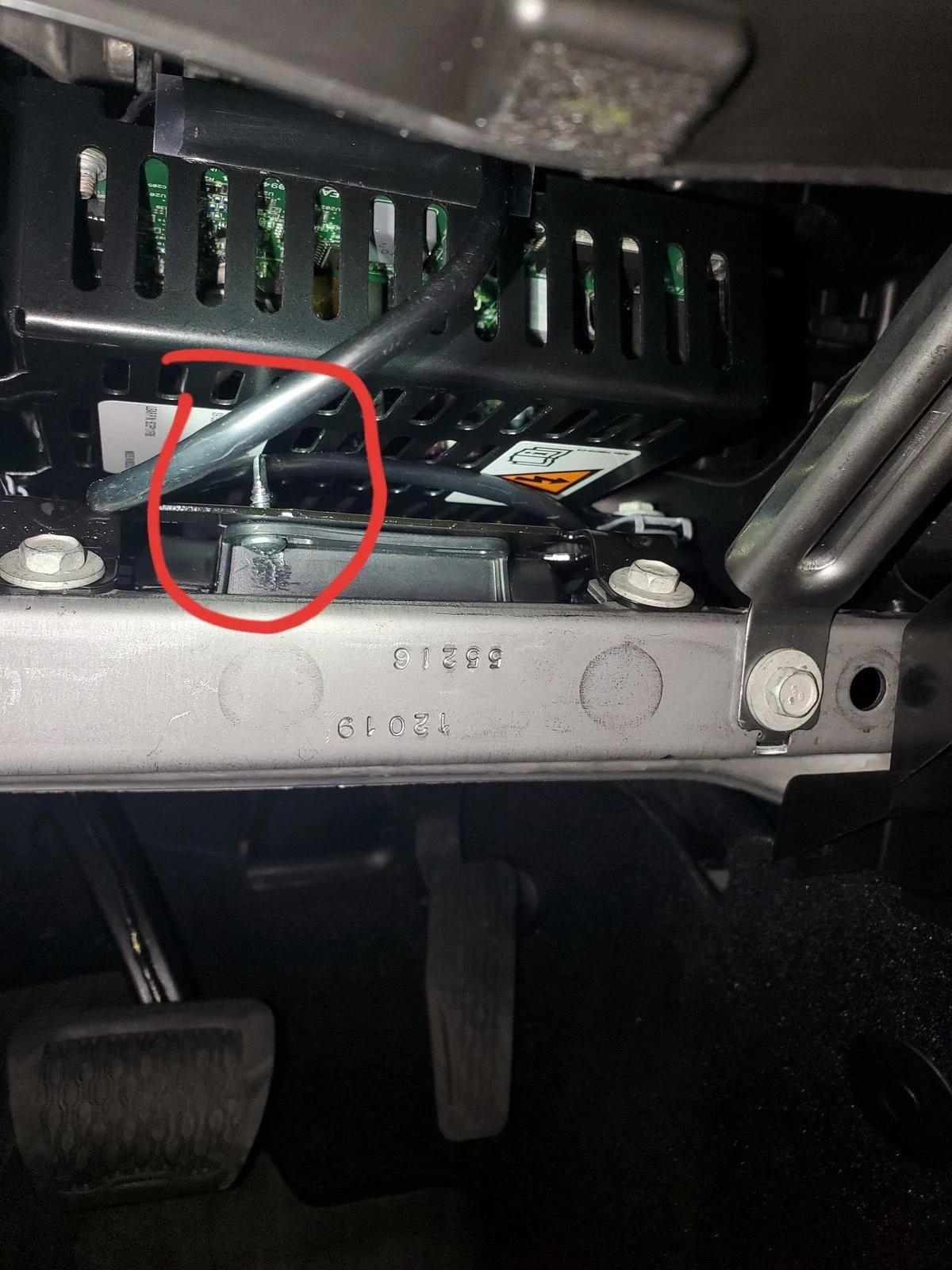

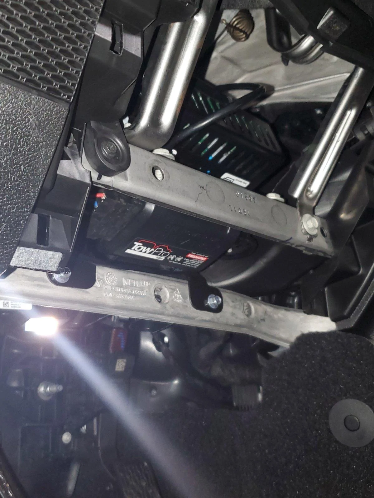

I guess I'm of the minority of wanting a 12v port on dash, I just used the "vent" on lower panel a few inches to left of where the miss drilled holes photo. I know it's there for a reason, but I think that's a better one. As easy to reach and out of way. I'm not likely to hit it doing something with other dash controls or vice versa. I just mounted the control box on back of same panel consolidated stuff for easy access to troubleshoot if needed. I temporary mounted on with 3m tape until I was sure where I wanted it. FYI the tape comes off easy for a short time after if not prepared with alcohol wipe down. Being new plastic is off gassing and release compound from moulding.

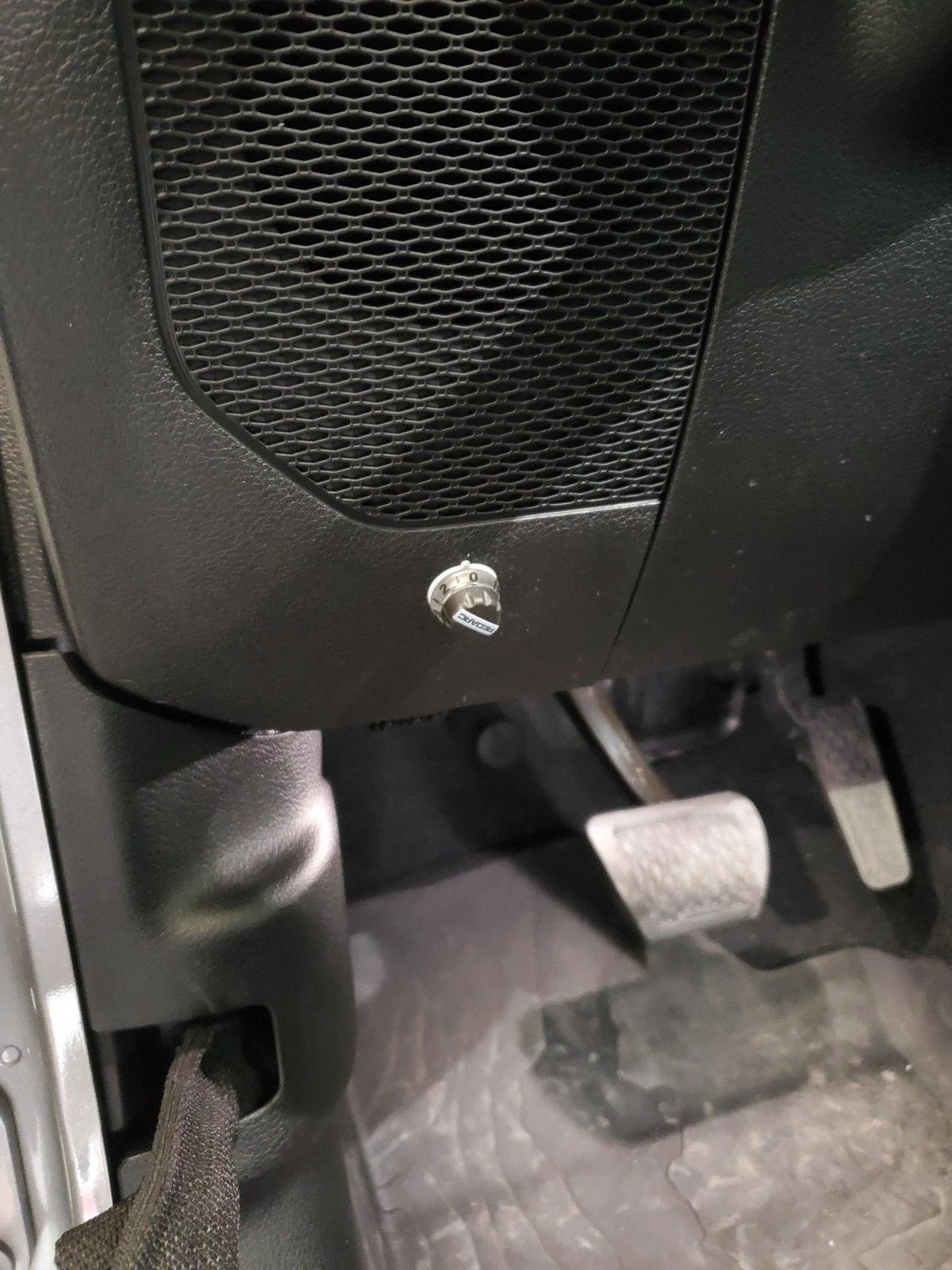

So I just wanted to throw this out there for the two left handed mechanics like myself. I tried to install the redarc electrical brake controller on my Gladiator today. Followed the same steps and techniques that was posted on here previously and ended up with a hole in my dash. I found that installing it by the bottom left side speaker to be super simple and far more forgiving it you screw something up. So moral of the story is if you plan to install it by the push button start make sure your holes are 100% in the right spot because there is no forgiveness in that angle of the panel. See pictures below where I ended up placing it.
I'm planning on installing mine in the same space you did under the left side speaker. Anything I should know beforehand? Are you still happy with that location? Does that panel come off?

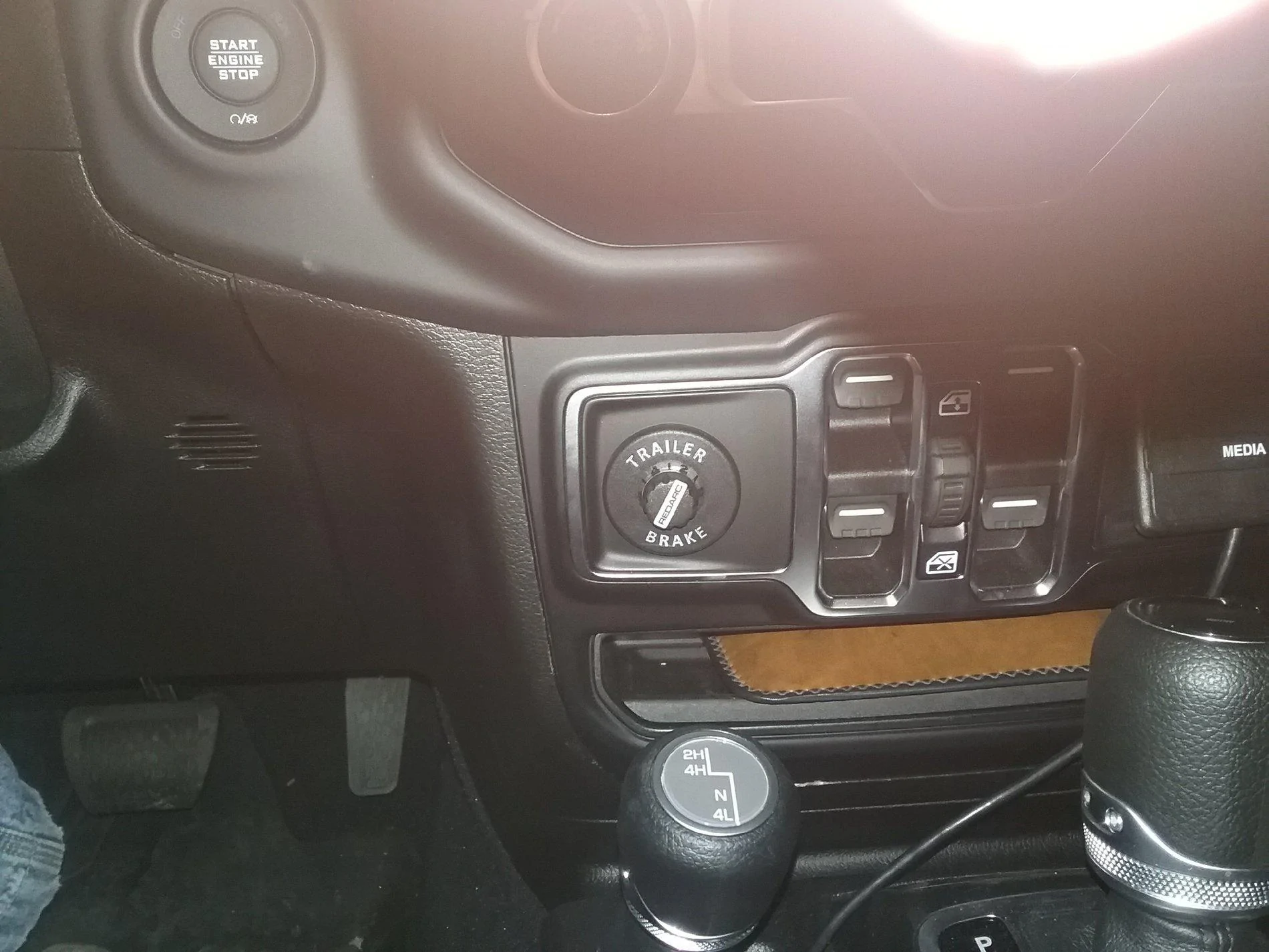

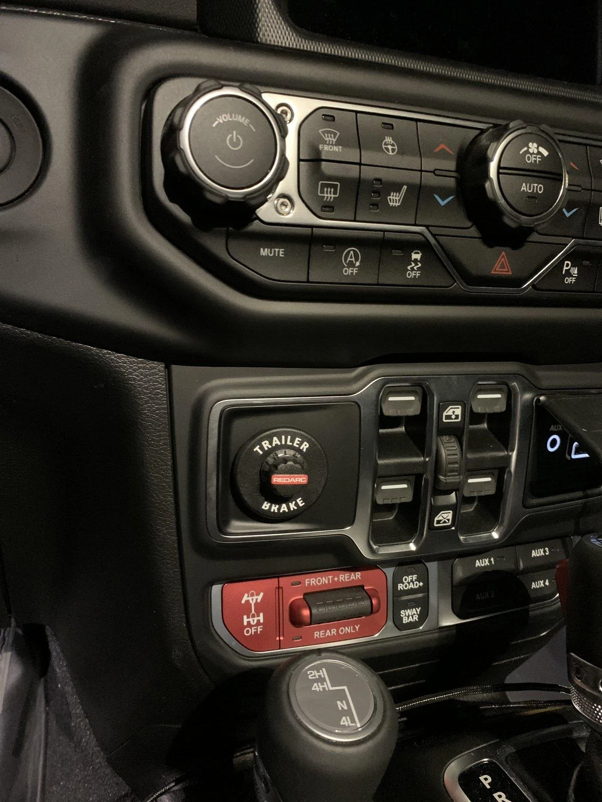

This is where I installed the knob for my Curt controller. I didn't want to drill any holes, and this was the only smooth piece of plastic available for the 3M tape to adhere to. It is also easy to reach.

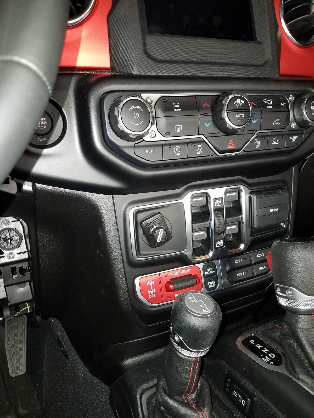

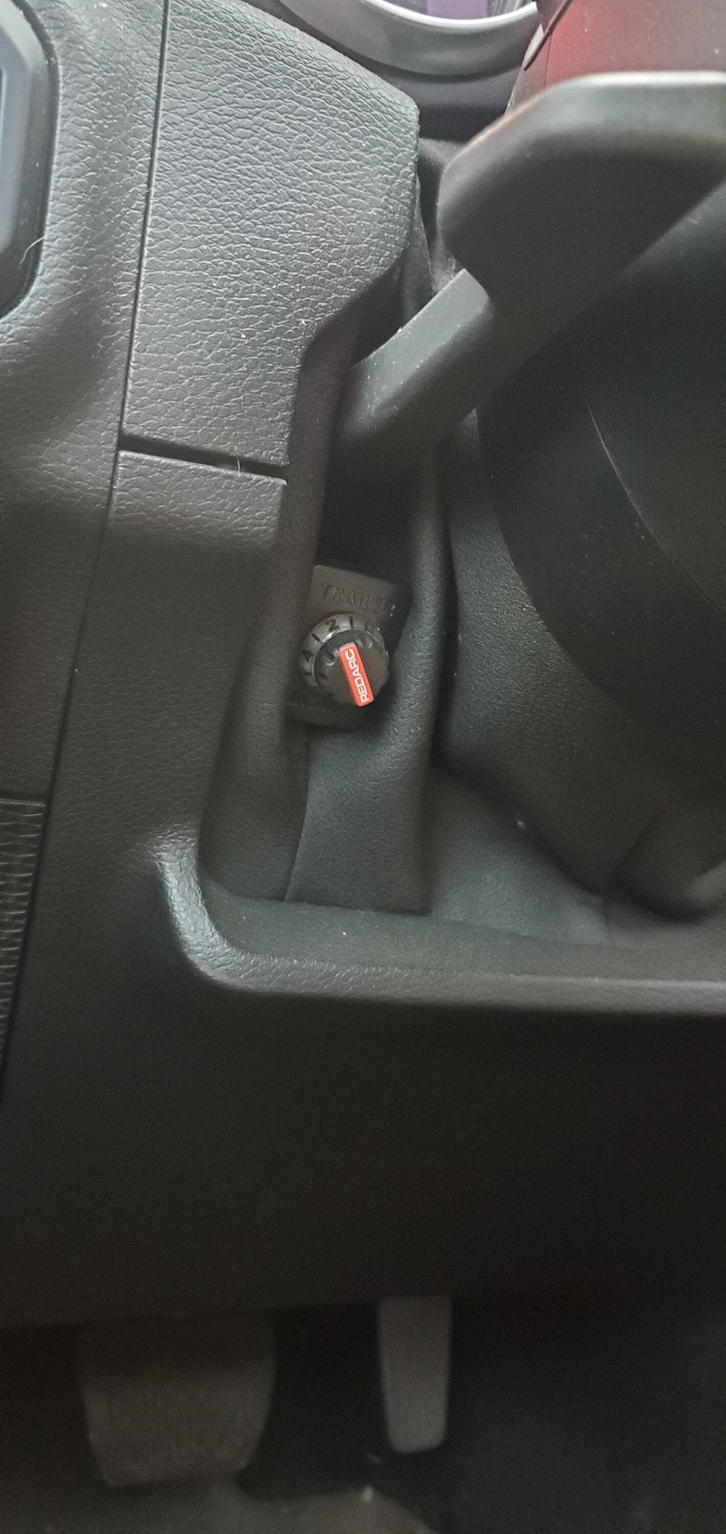

I could find a place I was completely happy to permanently install it. So I just placed it here. I kind of figure I won't be using it much, and when I do I don't need to fiddle with it.
