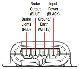

Now, the next question -
I got a great long reply from Redarc.
He recommended the TPH-001 harness. He said they work fine as they are but...
>>I would suggest the TPH-001 harness will work, however it must be noted that when you press the override button on the brake controller, the brake lights will not be illuminated.
This is only a law that is upheld in the state of California <<
and I would prefer they DID light when I push that button, but it's not a show stopper.
Apparently the TPH-001 is a direct plug-in with no wire swap.
My question for the group -
Does the TPH-001, which is for the 2014-2020 Cherokee (and I assume Grand Cherokee) have the diode??????????????????????/
The TPH-020 does, you have to switch blue and black wires. That's no big deal at all.
With the TPH-020 will the brake lights on the trailer fire with pushing the button???
Does the TPH-001 Cherokee harness have the diode.
It will not fire the trailer brake lights with the push of a button.
He also suggested the adapter/bezel -
https://redarcelectronics.com/products/tow-pro-universal-mount
But it seems to me this one would work in the 12v outlet position in the JT -
https://redarcelectronics.com/products/switch-insert-to-suit-gmc-isuzu
For the bezel, definitely use the round one, the one he suggested is more of a universal fit and would look weird on the dash. I also don't think it's big enough to fill/cover the 12v outlet.
For the harness I believe the trailer lights won't fire on any of them with the diode. The reason is that signal that would normally be sent down the brake light wire is blocked by the diode. This is needed to keep the computer form freaking out when it sees unexpected voltage on that line. They do make kits you can add at the hitch connector which will always fire the trailer lights by catching a 12V signal being sent to the brakes and activating them. The Tekonsha one I saw was like $70 and since it's a very infrequently used item, I did forgo it. In CA, I believe they are required (shocker).
I have not used or seen the TPH-001 in person so I can't speak to the diode on it, but I did shoot out the TPH-020 with my multimeter last year and confirmed it did have the diode.
  • Like
Reactions: KVJ
180
29,567
35,165
I'm about to send in the order - and the round bezel is the one I'll get, the controller is a no-brainer, he sent me the owner manual in PDF - looks great to me.
The harness - makes me think that the Jeep harness, the TPH-001 would work as is and if it won't fire the trailer lights it must mean there's a diode there as the RED wire is brake light signal.
Here is what REDARC sent me in their email response -
Our TPH-001 harness we list to fit Cherokee’s 14 – 19 we have confirmed it works with 2020 Gladiators.
https://redarcelectronics.com/products/tow-pro-brake-controller-harness-to-suit-jeep-tph-001
Please check out the Trail Benders Overland video here, confirming the TPH-001 harness fits the 2020 Jeep Gladiators:
However, one of the reputable overlanding workshops has recently commented, “the TPH-020 harness worked great (after switching the blue and black wires). I think moving forward that's the setup we will order for the JL Wangler platforms.”
They purchased the TPH-020 for a JL Wangler and swapped around the Blue and Black cables, this adaptor harness is originally suitable for the RAM trucks.
Blue is brake output - 12v to the trailer brakes, black is input power to the controller. Odd that would be reversed in the RAM but whatever.

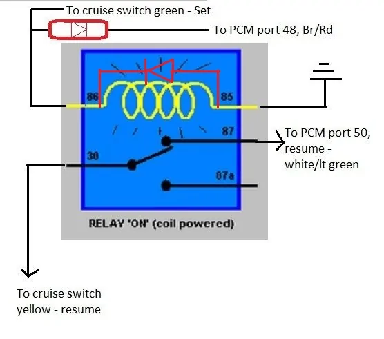

It would be simple to devise a system to trigger brake lights at the trailer when that button is pressed. But like you said - rare would be the time I'd actually need that function or want it.
Jeep Gladiator Will this combo do for Redarc install in JT? trailer-controller-wiri

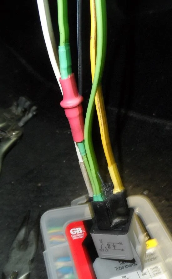

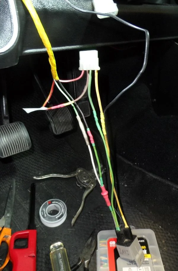

Here's how I rigged a 1982 NOS (new old stock) AMC Eagle cruise control switch to operate the cruise control system of the Jeep engine and PCM I put in my car - that took some figuring as I wanted the Jeep cruise control to work in the car but the controls were pretty much backwards and in a different combination than AMC used in the 80s - the result is perfect control over the cruise built into the 1994 ZJ PCM using my 1982 AMC wiring and switch.
Jeep Gladiator Will this combo do for Redarc install in JT? cruise-relay-on-diode-3
Jeep Gladiator Will this combo do for Redarc install in JT? cruise-relay_2272
Jeep Gladiator Will this combo do for Redarc install in JT? cruise-relay_2273

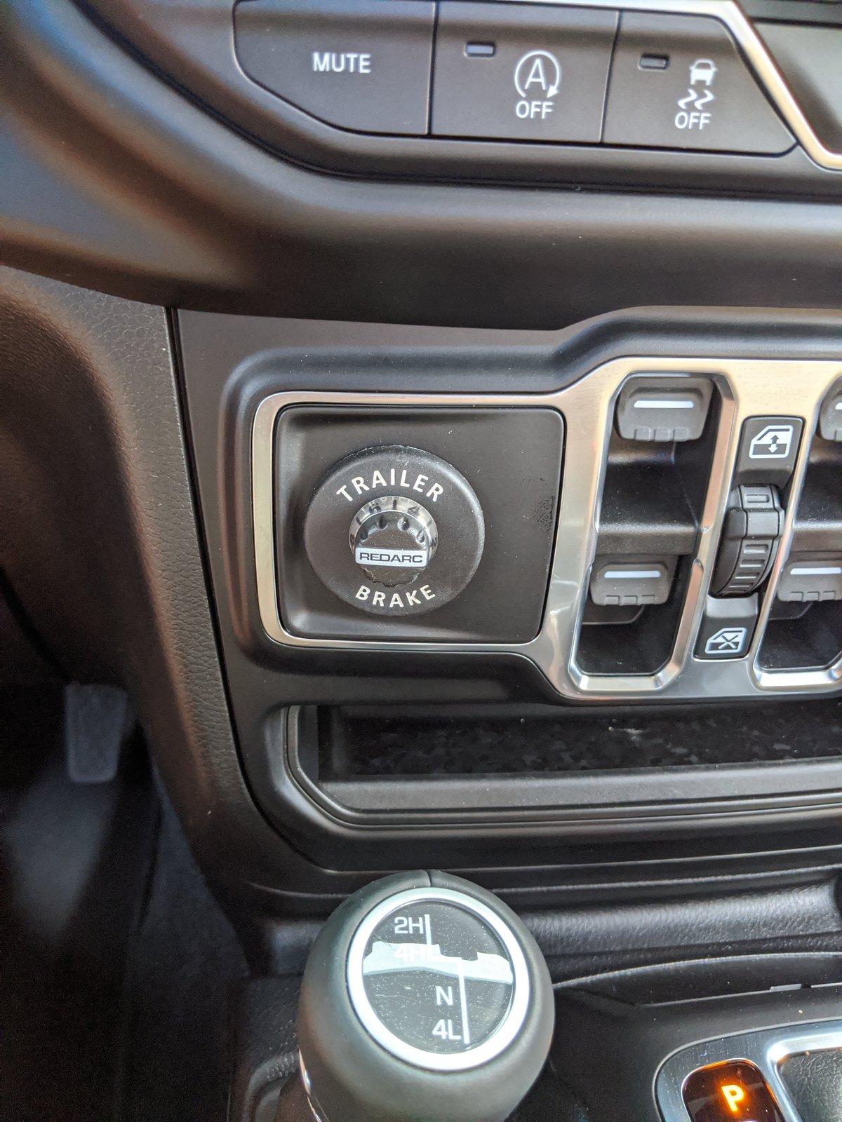

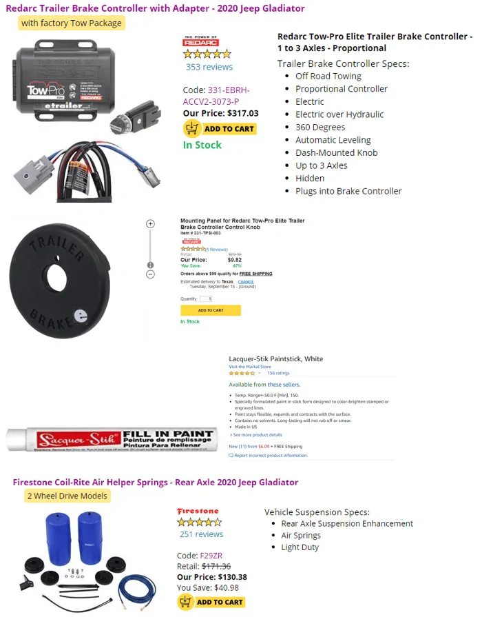

Here is the parts list from my install... Went very easy and was done in about hour and half for the controller. Install for the air bags took about hour to install....Works great on my last trip to Ouray Jeep Jamboree 2400 miles!!! Heading to Black Hills SD Jeep Jamboree and then to Yellowstone in a few weeks... Good luck with the install and big shout out to this forum for all the help!!!
Jeep Gladiator Will this combo do for Redarc install in JT? Trailer brake
Jeep Gladiator Will this combo do for Redarc install in JT? 1599585546572
Jeep Gladiator Will this combo do for Redarc install in JT? MVIMG_20200830_111144
  • Like
Reactions: KVJ
180
29,567
35,165
I couldn't tell by the pics - did you use the 020 Ram Redarc harness?
You are pulling a fair load with the Jeep on that trailer, with an Overland (what I have)
I like the looks of the install in the 12v outlook spot and how the white lettering helps.
I plan on filling the letters to match the other lettering in the Jeep - Not as steady as I used to be - but also did the orange in these gauges, pointers and scale areas.
