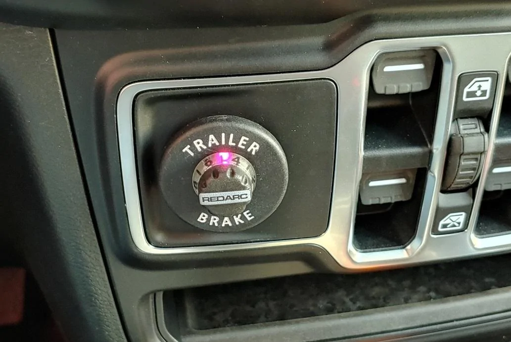

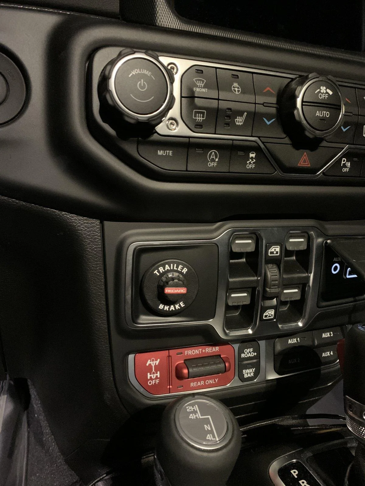

I couldn't tell by the pics - did you use the 020 Ram Redarc harness?
You are pulling a fair load with the Jeep on that trailer, with an Overland (what I have)
I like the looks of the install in the 12v outlook spot and how the white lettering helps.
I plan on filling the letters to match the other lettering in the Jeep - Not as steady as I used to be - but also did the orange in these gauges, pointers and scale areas.
I used a Lacquer-stik to do mine and it worked pretty well You basically rub it into the letters and then I used a rag to clean off the excess. A spot of WD-40 lightly on the rag cleaned it right off. I like how it brought the letters up flush, so they almost look silkscreened on.

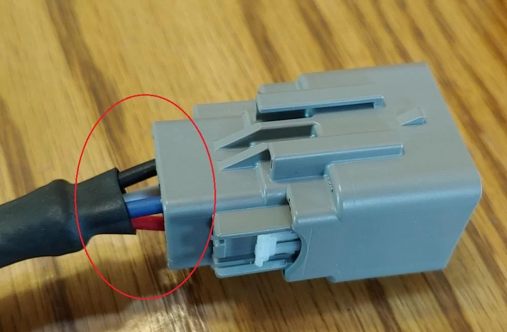

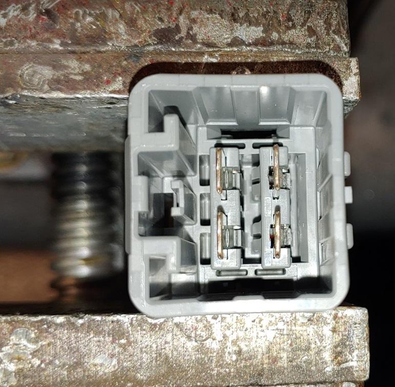

This is the end of the Ram harness that connects to the JTs harness. Note the black and blue wire positions as they are originally. You need to swap those two. They are power + (black) and power from controller to trailer brakes (blue).
Jeep Gladiator Will this combo do for Redarc install in JT? 1-20200914_135315

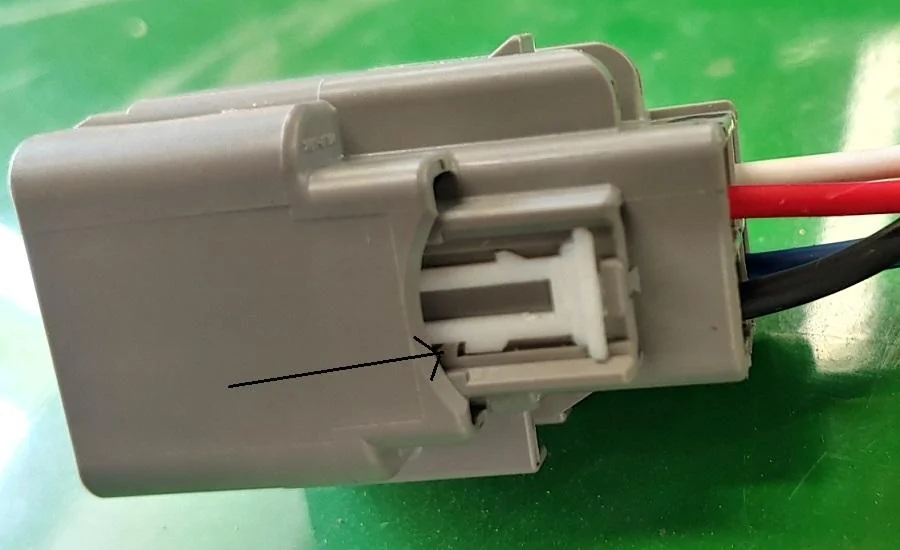

The connector has a white plastic clip that secures the terminals in place - you need to release and remove this - careful, so you can put it back later.
Release these (both sides) and carefully push the tabs forward, toward the open end of the connector. I lifted the ends, and used a probe to push the sides inward (arrow) on one side to make it easier.

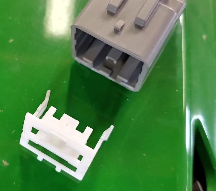

Here is the piece you have to remove to switch terminals. You need to put it back later to secure them again.

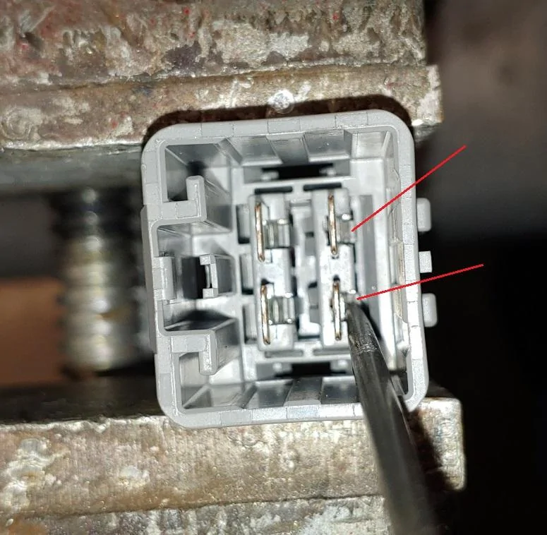

Using a narrow, sharp pick or similar tool, gently push the gray lock tabs to the right (as shown in this pic) and pull outward on the wire at the same time. I put this in a vise with smooth aluminum jaws to protect it and allow me to move the clip with one hand and pull the wire with the other hand.

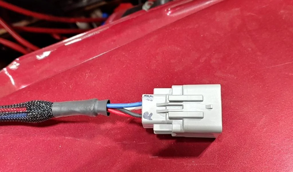

Switch the black and blue wires, push them back in until they click, and put the white retainer back in place - until it clicks. Now it should look like this. I marked things in case I got interrupted somewhere in the middle!

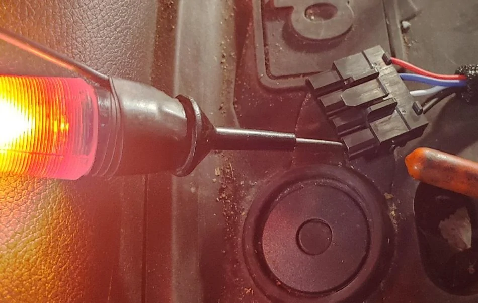

To verify (call me paranoid, not wanting to blow anything up) I checked that the black wire at the controller end actually had live BATTERY power when the other end was plugged into the JT's harness.
Jeep Gladiator Will this combo do for Redarc install in JT? 7-20200914_145710_HDR

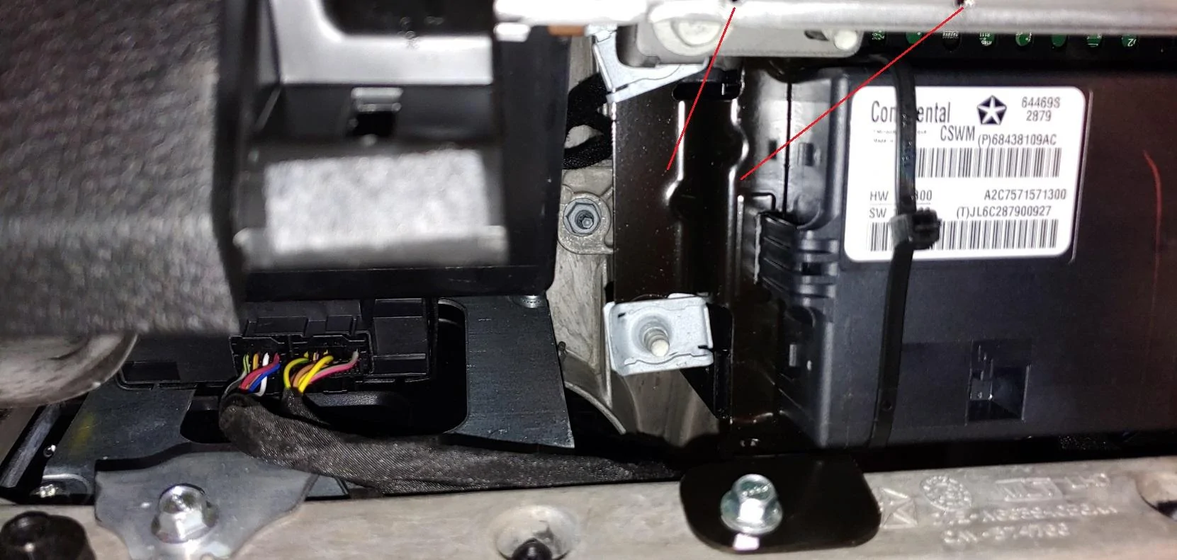

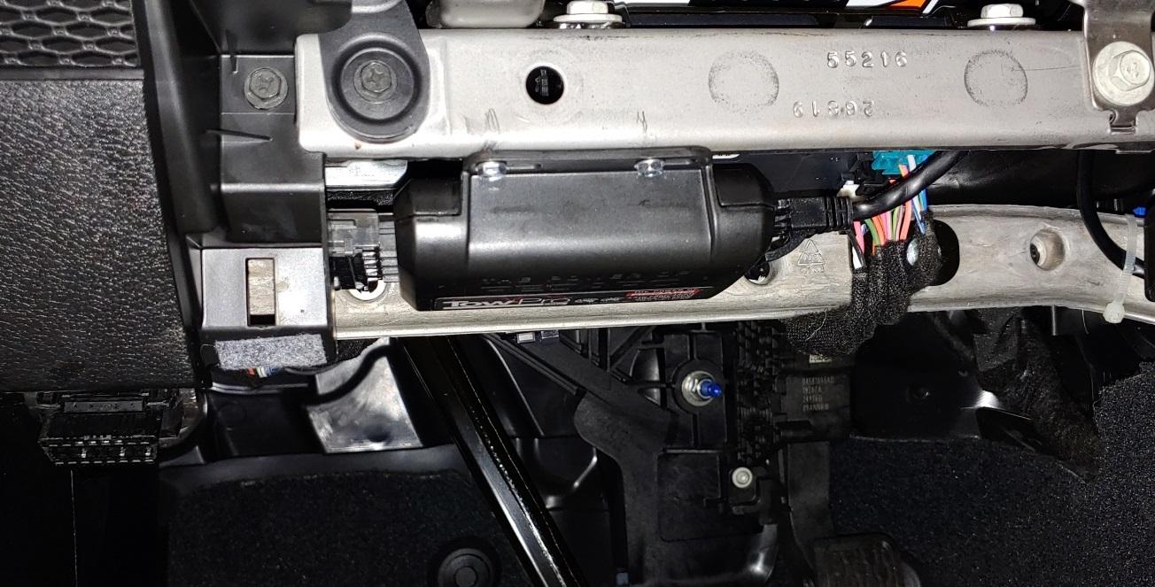

A lot of folks I've seen pics and videos by put their controller where I have the red box drawn. Simple, you drill straight forward, secure, easy access, all yes - but - you have to clip off parts of the plastic trim because the trim won't go back on otherwise. I didn't want to do that - and found an easy spot for it, no trimming involved.
Jeep Gladiator Will this combo do for Redarc install in JT? 8-20200914_171326_HDR

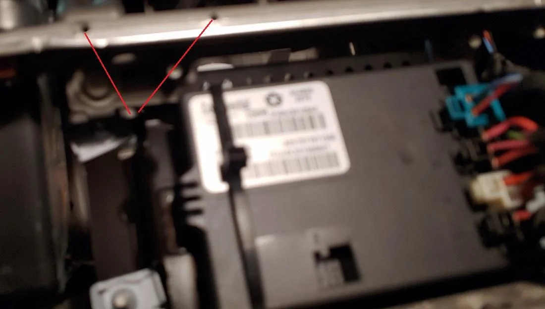

I double-checked, nothing there that might be blocked as far as access or air flow, so I marked and drilled the holes indicated (red lines)
Jeep Gladiator Will this combo do for Redarc install in JT? 9-20200914_152133

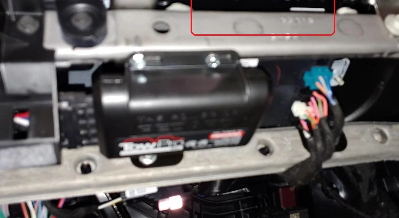

A better shot (focus) of the holes drilled and what else was up there -
Jeep Gladiator Will this combo do for Redarc install in JT? 10-20200914_152214

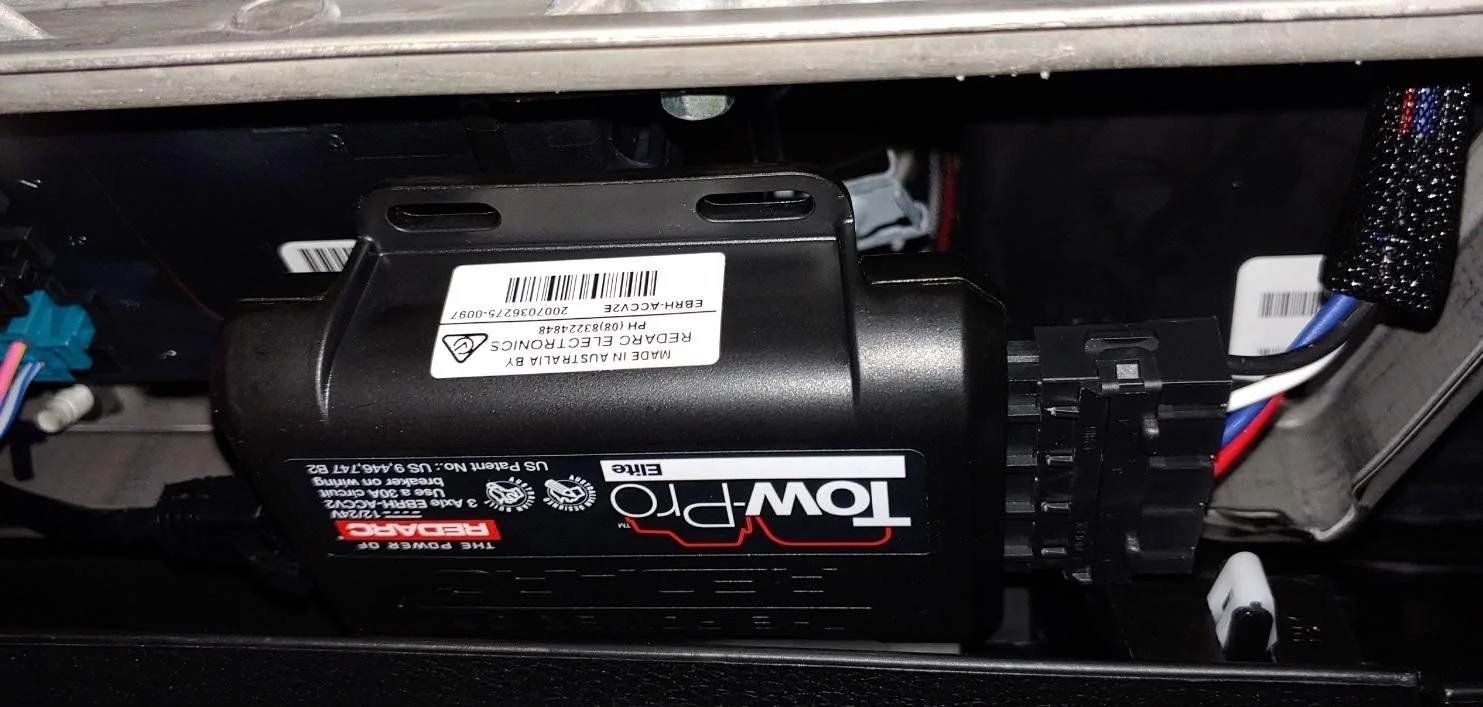

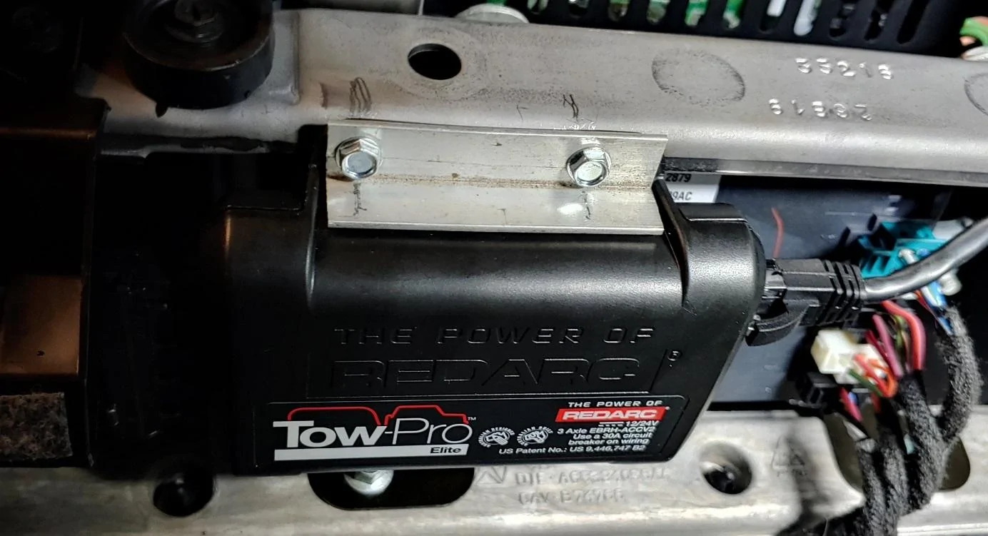

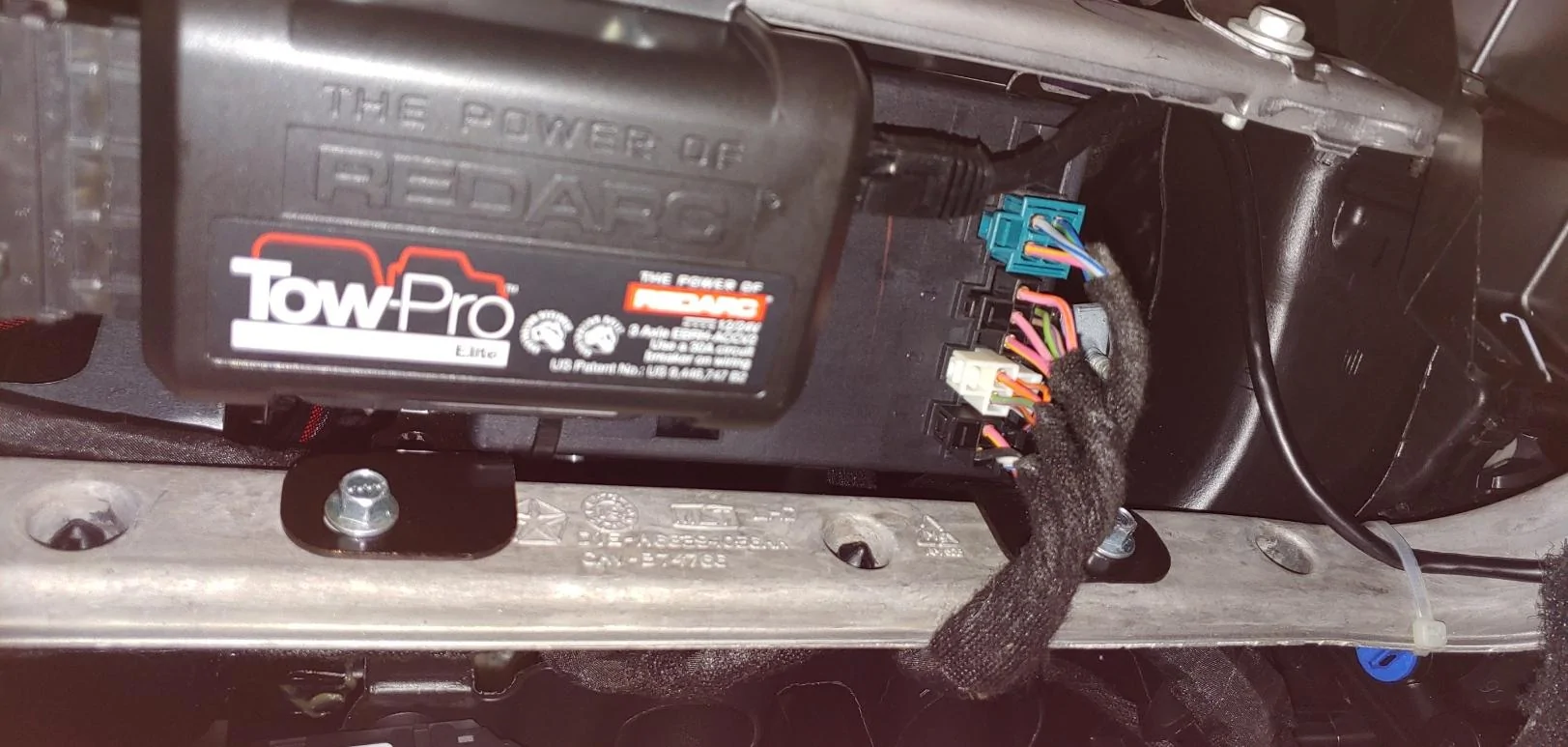

Here it is, screwed in place on the bottom of the brace. I could still access the firewall connections if I desire to put in the security bypass cable to use jscan, etc. if I want to. And there's easy enough access for the controller wiring.
Jeep Gladiator Will this combo do for Redarc install in JT? 11-20200915_111801
Same thing, just a view from below looking up.
Jeep Gladiator Will this combo do for Redarc install in JT? 12-20200915_111836
I decided to reinforce a bit - took a piece of aluminum angle, cut to length between the controller mount braces, and drilled - no washers needed, it's one loong washer plus the angle helps prevent the controller from vibrating. The angle is snug against it.
Jeep Gladiator Will this combo do for Redarc install in JT? 13-20200915_114640_HDR
I snapped the cover back in place and this is a shot showing how it all clears. This is looking up and back toward the seat.
Jeep Gladiator Will this combo do for Redarc install in JT? 14-20200915_115020

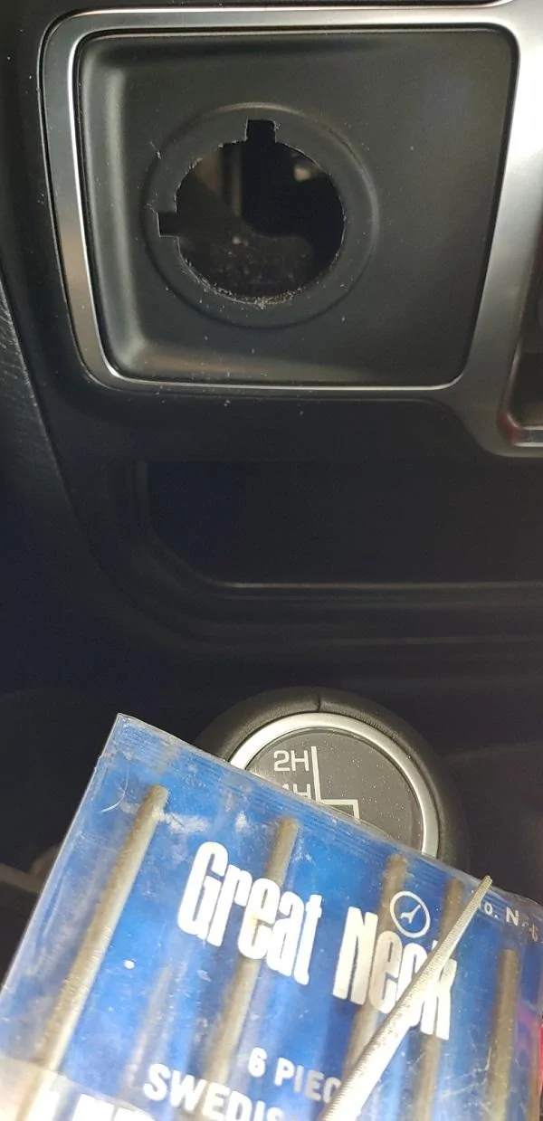

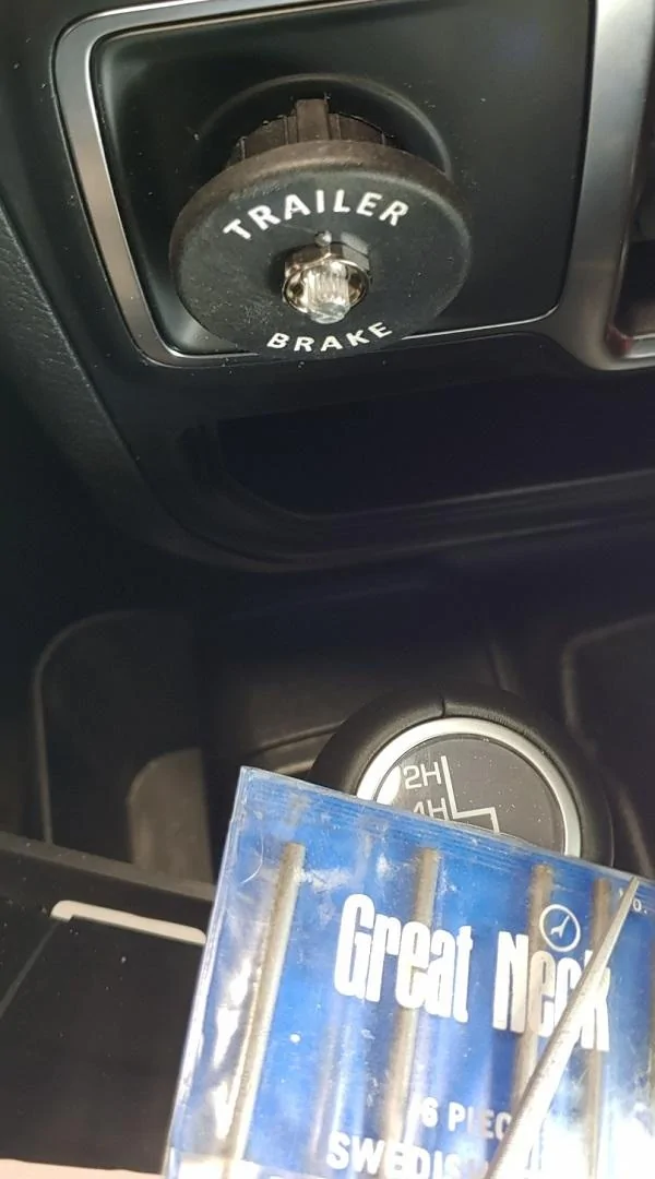

I used my fine jewelers files to make the notch for the controller knob bezel - SNEAK UP ON IT, be patient, file, test fit, file, test fit.
Jeep Gladiator Will this combo do for Redarc install in JT? 15-20200915_104850

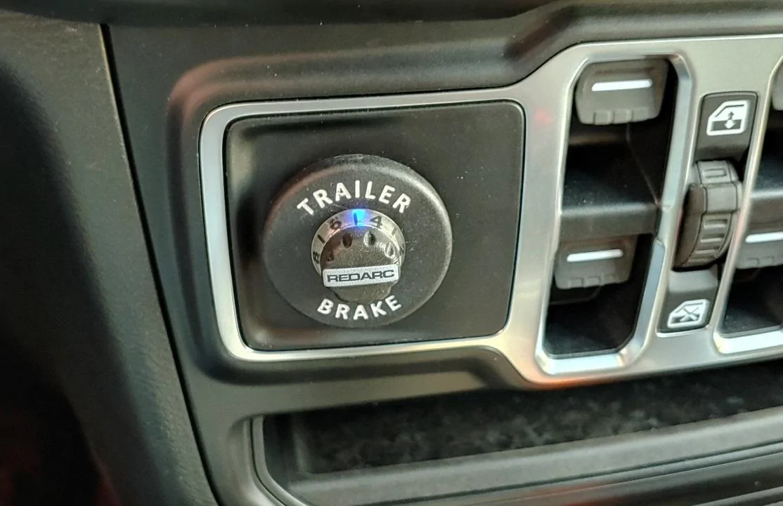

Test fit - perfect, snug but not tight.
Jeep Gladiator Will this combo do for Redarc install in JT? 16-20200915_104838
I hooked up to my trailer and drove it around a few miles, multiple stops and turns and hills etc.
Jeep Gladiator Will this combo do for Redarc install in JT? 18-20200915_144204_HDR
And in brake mode (don't worry, I was in my driveway going about .0001 mph so I wasn't snapping pics on the road while driving)
Jeep Gladiator Will this combo do for Redarc install in JT? 19-20200915_144213_HDR
