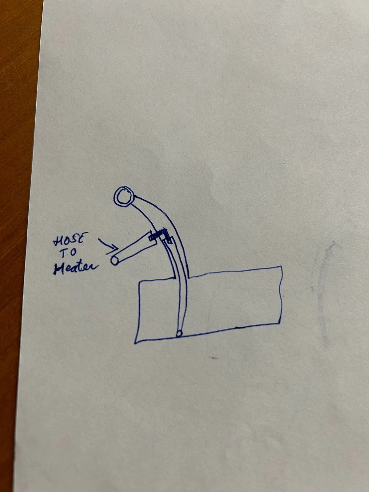

How about drilling a hole into the removable fill neck tube, low enough to clear fuel nozzle. Weld on a 90 elbow barb fitting, with one end pointing down toward the tank and run a fuel resistant hose down into the tank. This mod is easily reversible by just capping off the external barb end.

Sounds like a good idea, but somewhere I read there were 2 flapper valves in that tube, one higher and one lower. I also have read you cant get a tube down there because of the lower one. Is this right or is my memory just messing with me again?
There's a thread here on the "fill neck mod" that removes the two flappers that are up top. I too am looking for a way to pull fuel out for a diesel heater. Likely going to go with a standpipe type that comes in through the fill neck. But if you figure out tapping into the fuel return I'd be interested.
