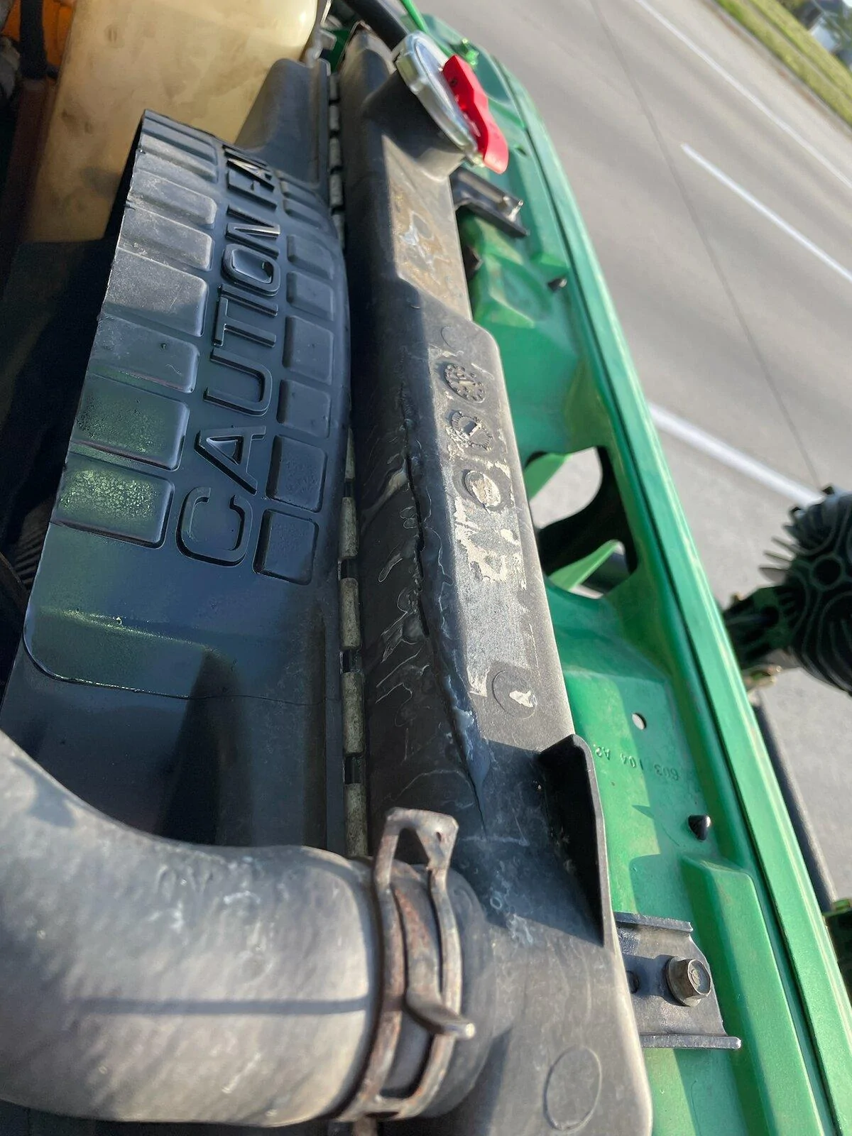

Yeah, been around the block with radiators, cooling systems, etc. - worked in a shop along I80 and saw my share of cars towed in with over-heating. Building more power into engines, adding AC, etc. - radiator changes and swaps.
Blown radiators? Hmmm, oh, you mean like this - plastic of that size likely doesn't have the strength to handle the pressures required to prevent boiling. even 14 psi working on that large an area means pretty hefty force. It's no wonder these things exploded.

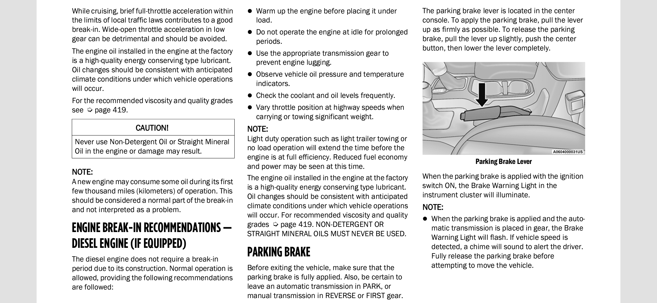

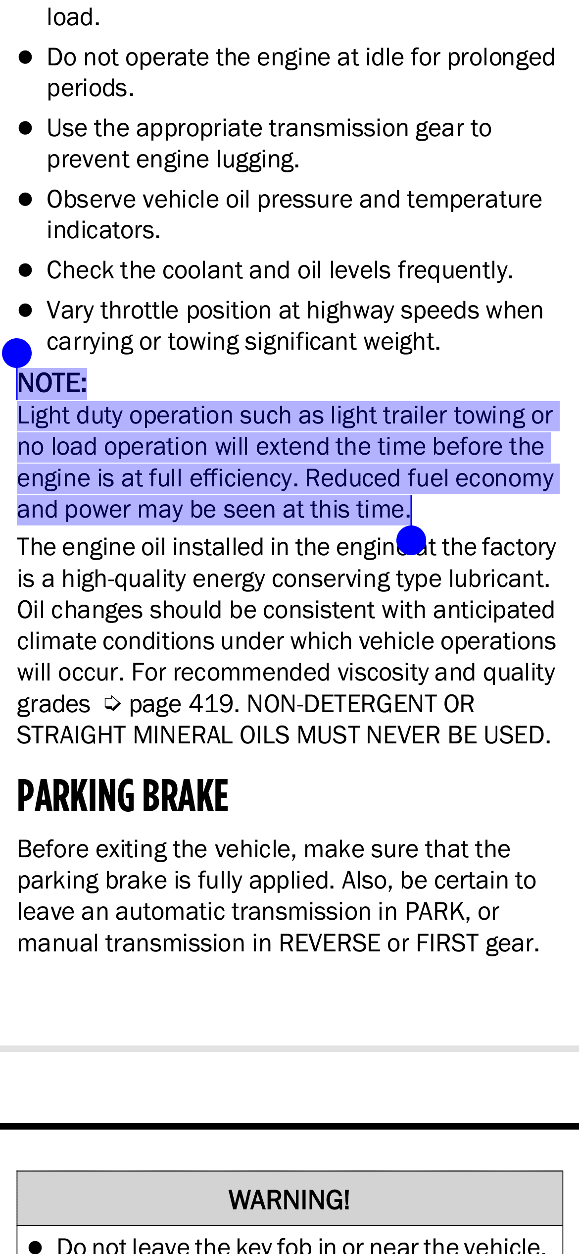

Interesting the manual for my 2022 has a Note for the Diesel engine. “NOTE: Light duty operation such as light trailer towing or no load operation will extend the time before the engine is at full efficiency. Reduced fuel economy and power may be seen at this time.”
Is this different in your 2021 manual?

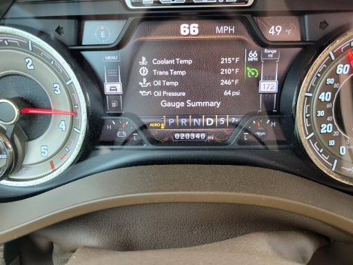

You don't want to lug the engine. If the grade is really steep, my truck will downshift to either 4th or 5th gear. It's good to lockout 7th and/or 8th gear when towing, or maybe even 6th gear if you're in the mountains. It really depends on how much you are towing and the gears you have. For reference, I just towed our travel trailer through NM, AZ, CA, NV, UT, KS, MO, IL, AR, OK, and TX (7,000+ miles of towing) and locked out 8th gear the entire time.
Let's talk about speed. The fastest I tow with my Ram EcoDiesel is 63 mph. When towing up long steep mountain passes, my top speed is typically no higher than 45 mph.
Keep in mind, I believe the max torque is 442 lb-ft @ 1,400 RPM on the Gladiator and 280 lb-ft @ 1,600 RPM on the Ram.
I've towed over lots of mountain passes and didn't see anything over 3,500 RPM. It didn't matter if I was towing in 4th or 5th gear, 3,500 RPM was the highest I saw. I pulled an oil sample and it looked good. See attached.

On my Ram EcoDiesel, you can see where I have 8th locked out, but the truck is currently running in 5th on a steep mountain pass towing 7,000 lbs.
