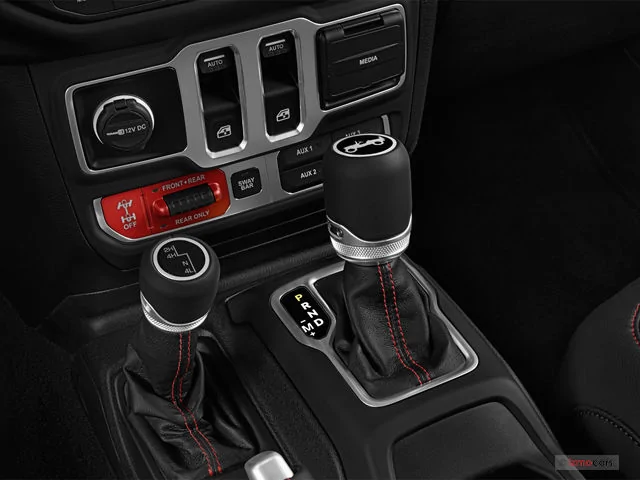

Does the Gladiator have the + or - buttons to select the gear? By manually dropping the gear down to 6th or 5th, you are locking out the higher gears.
Button? You slap the gear shifter to the side and toggle it forward and backwards to select gears. For shits and giggles Jeep engineers designed it ass backwards. Up is down and down is up. The M stands for Manual to the left of the shifter.
Gotcha. On the Ram there are + and - buttons on the steering wheel.
No. You move the lever left to manual mode and push forward to downshift, pull rearward to upshift. It'll hold that gear unless it senses lugging or over-speeding if I recall correctly.
I believe the orientation of the +/- is correct as it mimics a sequential shifter. Watch in race cars or drift cars with sequential, the driver pulls back to advance shifts.
