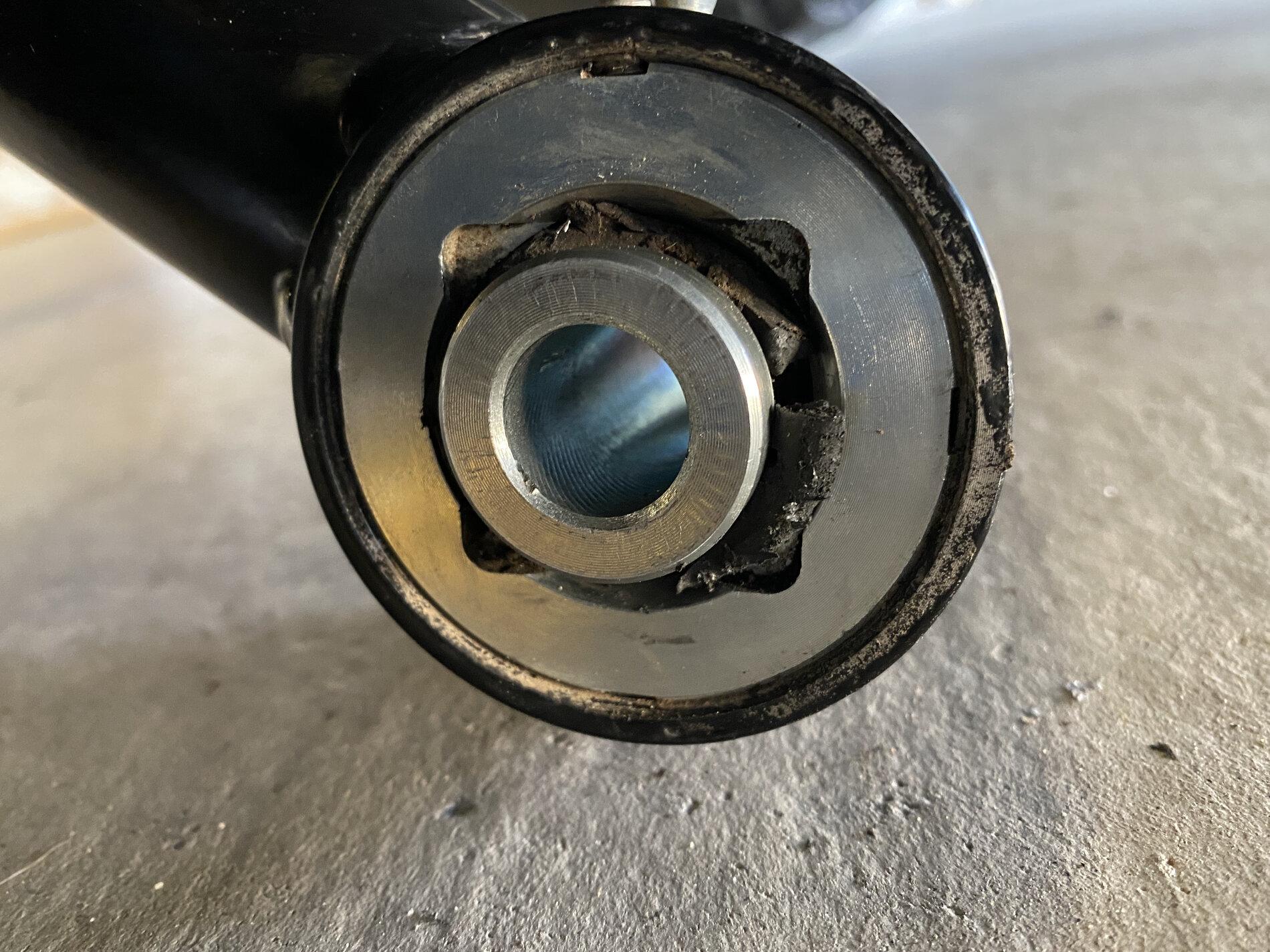

Grabbed my front lower control arm while changing the oil and the bushing felt loose, dropped the arm and found this. The lift is 4 months old, anyone else had a bushing go that early?
All over the net........ I have a client that had a set of the smaller joints fail on a TJ years ago and swore off RK joints.
I really like the triangulated 4 link setup for the JT, but a quick search on the net showed the joints are still junk.
Give us a call and we will get you taken care off.

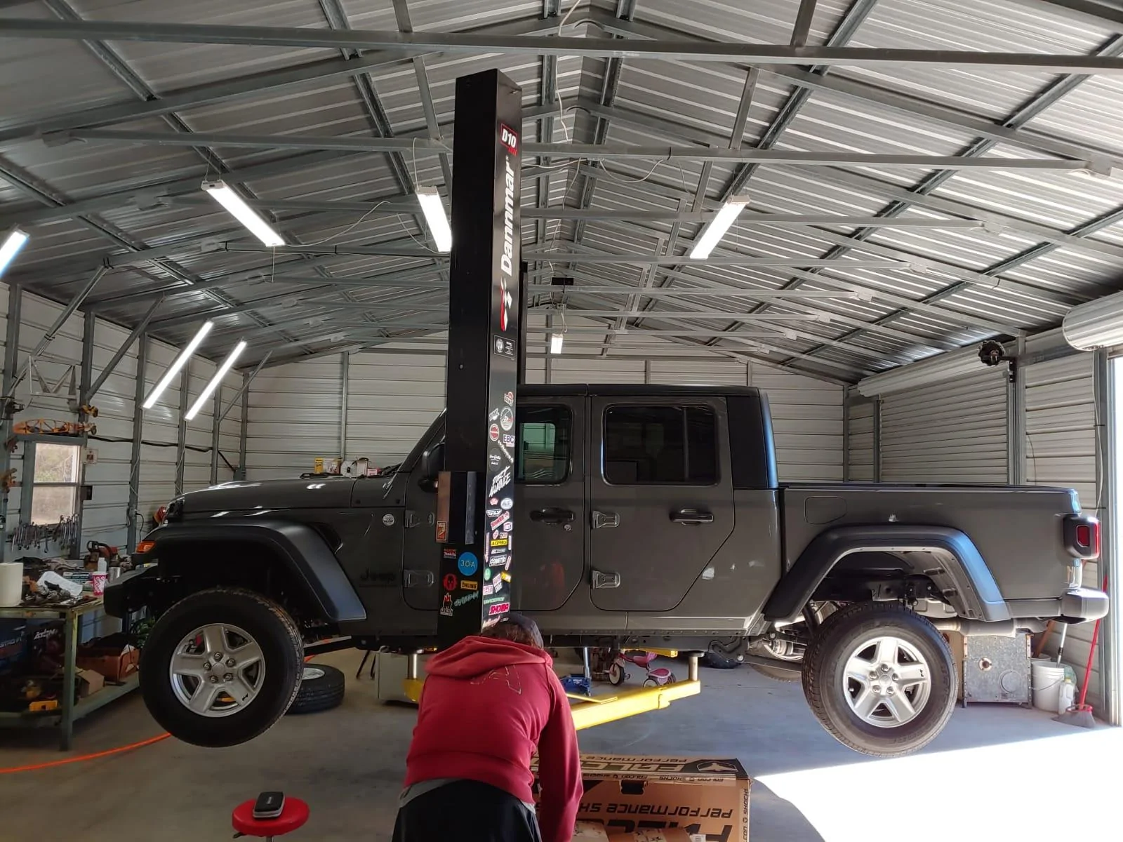

I recently installed the pro-x kit and was curious if anyone else has had any issues with the rear brake lines getting to tight when the rear suspension was at full droop? I have the falcon sp2 3.3's for the 2-3" lift and was wondering if maybe that could be the issue?
If your rear shock is greater than 28" extended, you'll risk your brake lines.
psylentknight
Sep 5, 2020
Dothan
20 Sting Grey Sport S JT
Thanks for the quick response...I was thinking that may be the issue. I believe you guys state 28" maximum extended and the falcons state 28.3". I'll just purchase some extended lines.

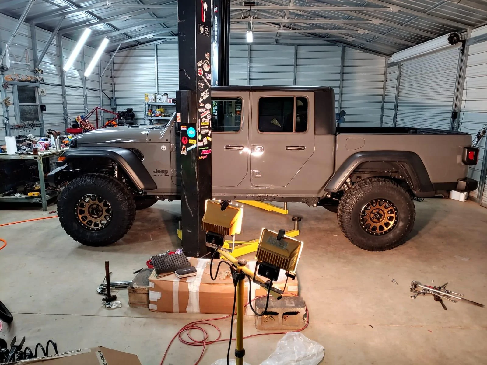

Well I won’t be much help but while we wait for a good response would you mind posting up some details on your install and some pictures.
Jeep Gladiator Rock Krawler 3" X Factor JT System IMG-20201226-WA0002
Jeep Gladiator Rock Krawler 3" X Factor JT System IMG-20201226-WA0005
Me and a couple buddies installed it. RK Pro-X system with Method MR305 NV 17Ă—8.5, 0 offset in bronze and 37Ă—12.5 Milestar Pat's. Shocks are Falcon SP2 3.3's. I have to purchase some wheel spacers as the 0 offset is not the correct back spacing so I get some rubbing. My fault I looked at the Rubicon specs and not the Sport. If you guys have any more questions just shout.
looks good. How long did it take to install? Did you run into any issues? How’s the ride Vs stock?
psylentknight
Sep 5, 2020
Dothan
Was about 8 hours for us, with properly scheduled beer breaks. No real issues to speak of just my measurements at times and also I did break off one of the zerk fittings in the front sway bar links, I'll take blame for that however, I prob cranked to hard on it. As far as the ride goes it's def an improvement. It's stiffer then stock by a good bit but that's a good thing Imo. Handles much better now not spongy feeling like stock.
