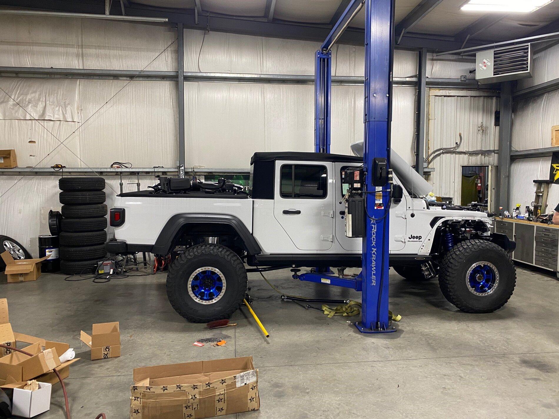

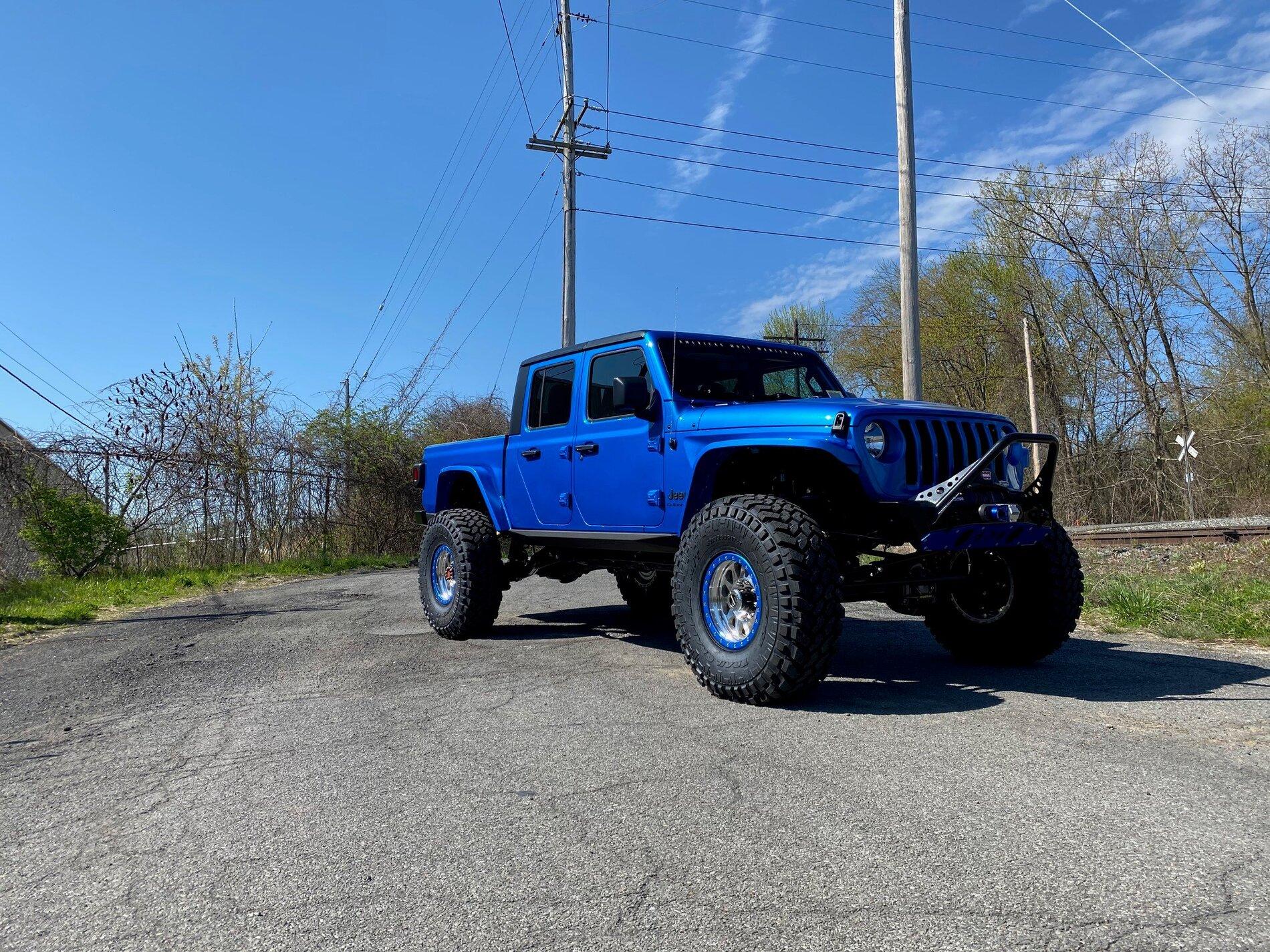

@Rock Krawler Suspension any preproduction pics of the 4.5's with 37s? Thanks!
With 37's I do not, we haven't put that combo together. The blue one here is on Nitto 40's with Nemesis fenders and the white one here is on BFG 39's with Sport Max Tow fenders. The lift arms are not touching in the photo of the white one.

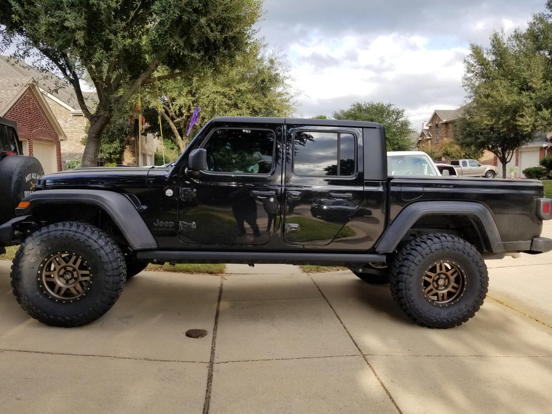

Done, brake lines all around are good to go !! Drives super smooth, just need to go get it alligned now.

Would you measure from the ground to the highest point of the truck and let me know how tall it is? I'll be installing this lift if it will still fit in my tiny garage.

Thanks !! Sure can, and will do when I'm off work tonight.

78.5" at the tallest part (rear of the hardtop) and that's with 37" Toyo's at 31psi

Heck I was so excited I ran out and measured my door hight in my PJ's. 82 even. That leaves me with 3.5 inches of wiggle room. I better remember that if we get 6 inches of snow.

No worries, anytime !! Glad it's going to work out for you !!
