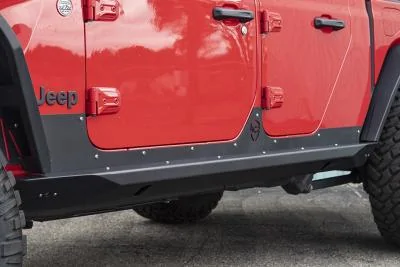

Roam just sent me a pic of their body mount JT Rails :like:
We have the same set on my wife's 4dr and they have taken a fair amount of abuse from Rocks and our 4 wild boys.
They informed me that JT sets will all be E-Coated unlike the early JL steps
I like how roam re-engineered a whole new part and didn't just slap an extension piece onto their jl rail like RSE did.

I must say that those are some very nice looking steps. I just wonder how wide(deep) the step part is. I would have been interested in them if they had them available when I first got my Gladiator a couple of months ago. Ended up getting some N-Fab Predator Pro steps. Very wide steps, very easy to step on to and a nice drop down to make the step up and into my truck easy for a person like me, born short. But the one thing that bugs me a little bit about them is that they show “N-Fab” on them. I really don’t like to be a rolling advertisement for anyone.
The Roam steps don’t have the brand name on them. And it looks like the steps offer great grip to them. But the step part does that appear to be too deep. Makes me wonder if it’s easy to step fully onto them. Again very nice looking.
they just messaged me. Body mounted for now at $699 and they’re testing out the frame mounted version shortly. Not too much longer!

While we're waiting, what are your thoughts on Body vs. Frame mounted? Everything I've researched leads me to believe there isn't much of a difference for someone doing light to moderate offroading. Heard any different?
i thought i replied to this, didn't work.
i think body would be fine for most abuse. I doubt i'll ever "NEED" frame mounted, but it just seems to make more sense in my head to absorb the impact to the frame, not to the body......Frame seems tougher, unless you're talking Tesla Cybertruck whos doors are its frame..... :lipssealed:

Personally I don't think its either / or for body / frame mount. Based on how your going to use your jeep - having both or hybrid of both gives you the best support. Even if you had a strong frame mount - tying into the body is going to give you additional reinforcement to minimize any flex or give in the rock rail as you drop onto it. Frame mount might be stiff - but 12" of leverage it will move a bit. Tying into the body at the pinch weld will also allow for moving the body with the rail. that all said - big and bulky is going to have more opportunity to catch, hang up or drag on a obstacle.
I think it would be tough to tie into both the frame and body since the body tends to "float" over the frame due to the rubber body mounts.
The frame mount sliders typically have a bigger gap to account for the body movement which to me is a bit of an eyesore if you don't wheel hard enough to really need them. I've had both on our JL's and while the frame mount are stronger we have dented one of the body mount set bouncing on a rock and they didn't budge where they mount to the body :rock:
I read that doing both is a bad idea. The body can't move independent of the frame then and then stuff starts to get tweaked.
