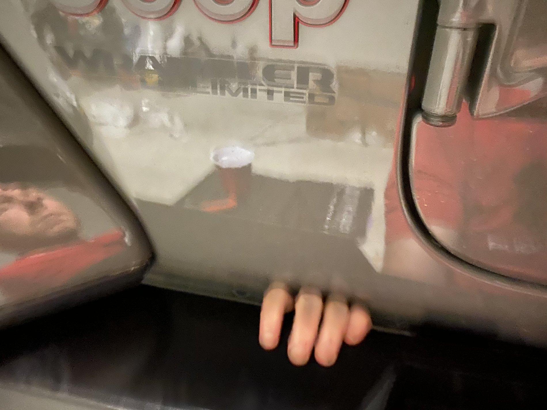

Hey @TTEChris, this was on the JL sister site(or is that a brother site?)
I'm wondering if it's harder to design frame mounted ones, so the tollerences need to be that much tighter.... I'd say if the owner installed them properly, a hands width gap is excessive. Maybe I should just get body mounted ones.......
QUOTE "I just orders and installed your ROAM JLU frame mounted rock sliders and have a number of issues with them
1. mixed hardware. Had to make a journey to get something long enough to for the mounts.
2. Both studs broke on the passenger side logo blank off plate goes. There was a lot of paint over spray in the studs
3. The front of the drivers side has a gap, that when mounted/pushed in as far as it goes, I can fit most of my hand through. It’s very visible. The passenger side installed fine outside of the broken studs.
I sent you an email with photos and requested instructions for return and refund.
can you contact me please?

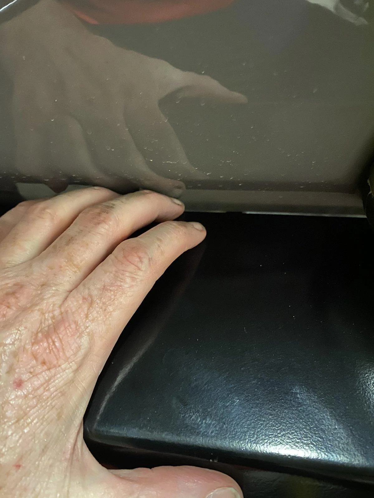

I've installed a few of the frame mount versions on JL's and the gap was always about a finger width from front to back. The body mount I was able to get much closer (almost touching the body). The frame mount will always need a gap due to the flex of the body on the body mounts. On our 2dr we didn't like the finger width gap so we went back to the body mount brackets.
Either he recieved some wrong brackets or a bad "batch" as the gap should be consistent.
The Gladiator set still need some work to be perfect, but I'm sure they will get there soon enough.

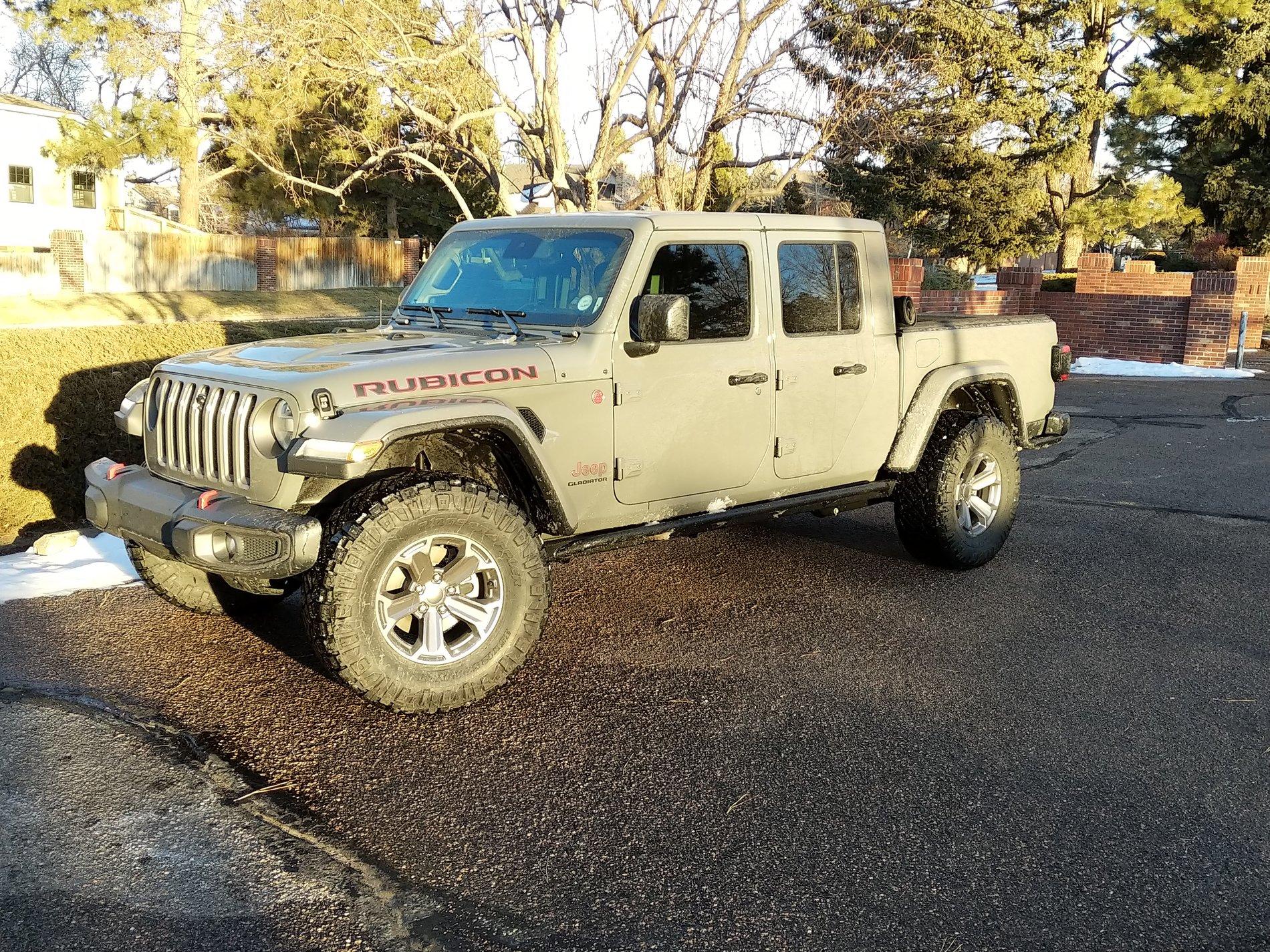

Discovered over the weekend after an hour driving in snow at 21F that the steps would be iced in and wouldn't deploy..
so you have the RSE steps and they wouldn't deploy because of ice/snow?
BruteForce
Jim
Sep 16, 2019
249
314
Utah
utahbruteforce.com
2020 Jeep Gladiator, 2009 Ram 3500 CTD, 2001 Toyota 4Runner
SVP/CISO
One side didn't deploy. Bear in mind though that I had been offroading in sand/creeks/mud and finally snow for two days. Temps that morning were 11F. Those steps were encased..
