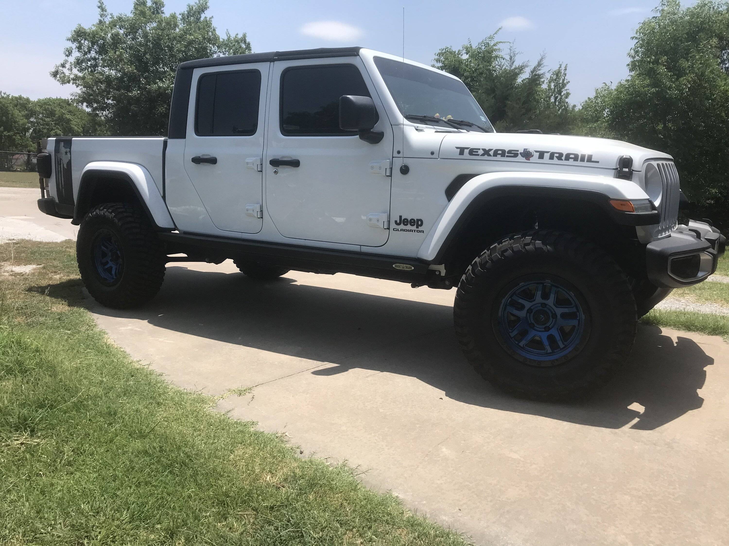

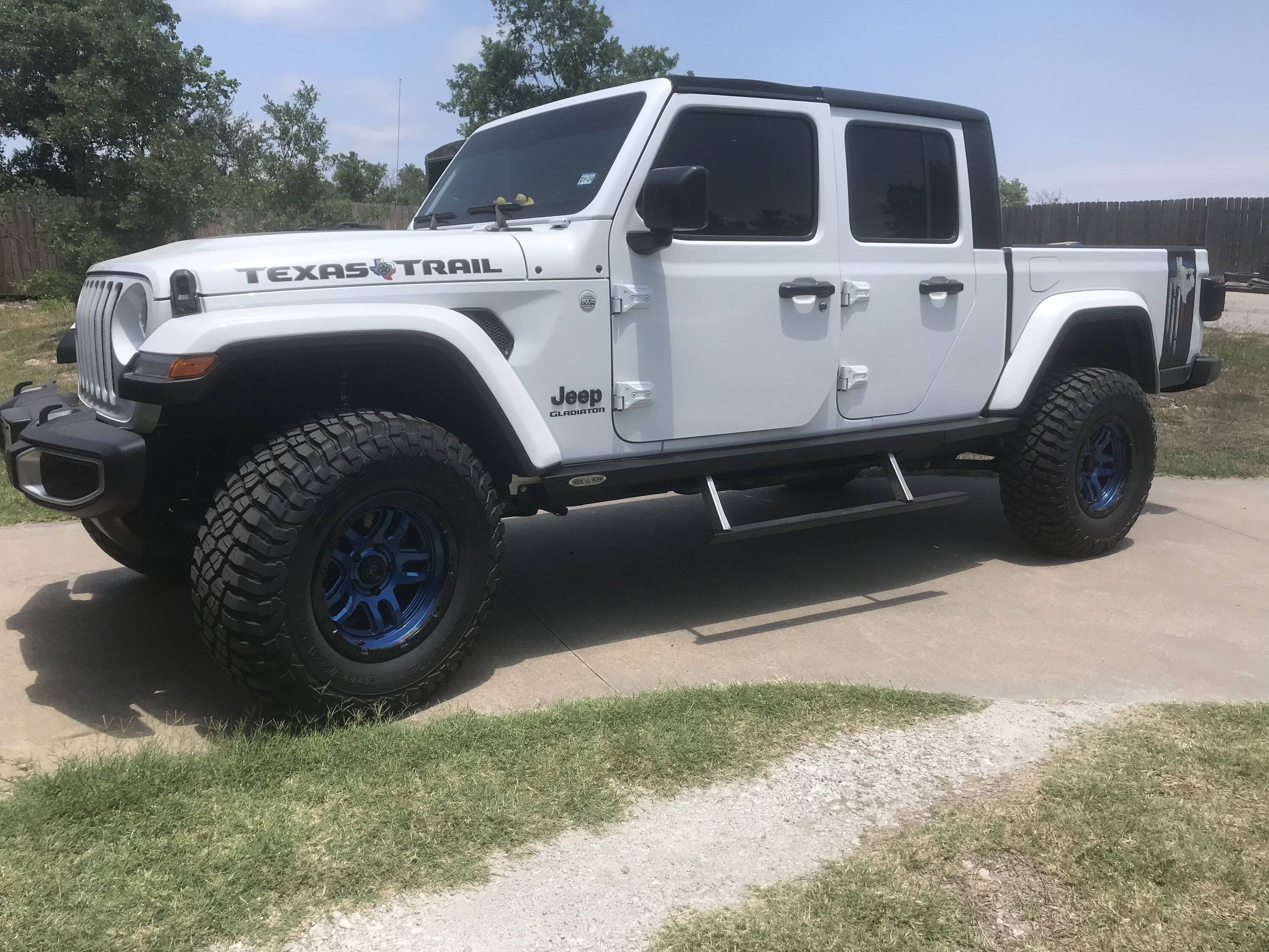

You run the cables thru stock holes in the floor with provided grommets. Then seal with silicone - not provided.
I have these on my 2.5” lifted, 35” tire, Texas Trail diesel.
