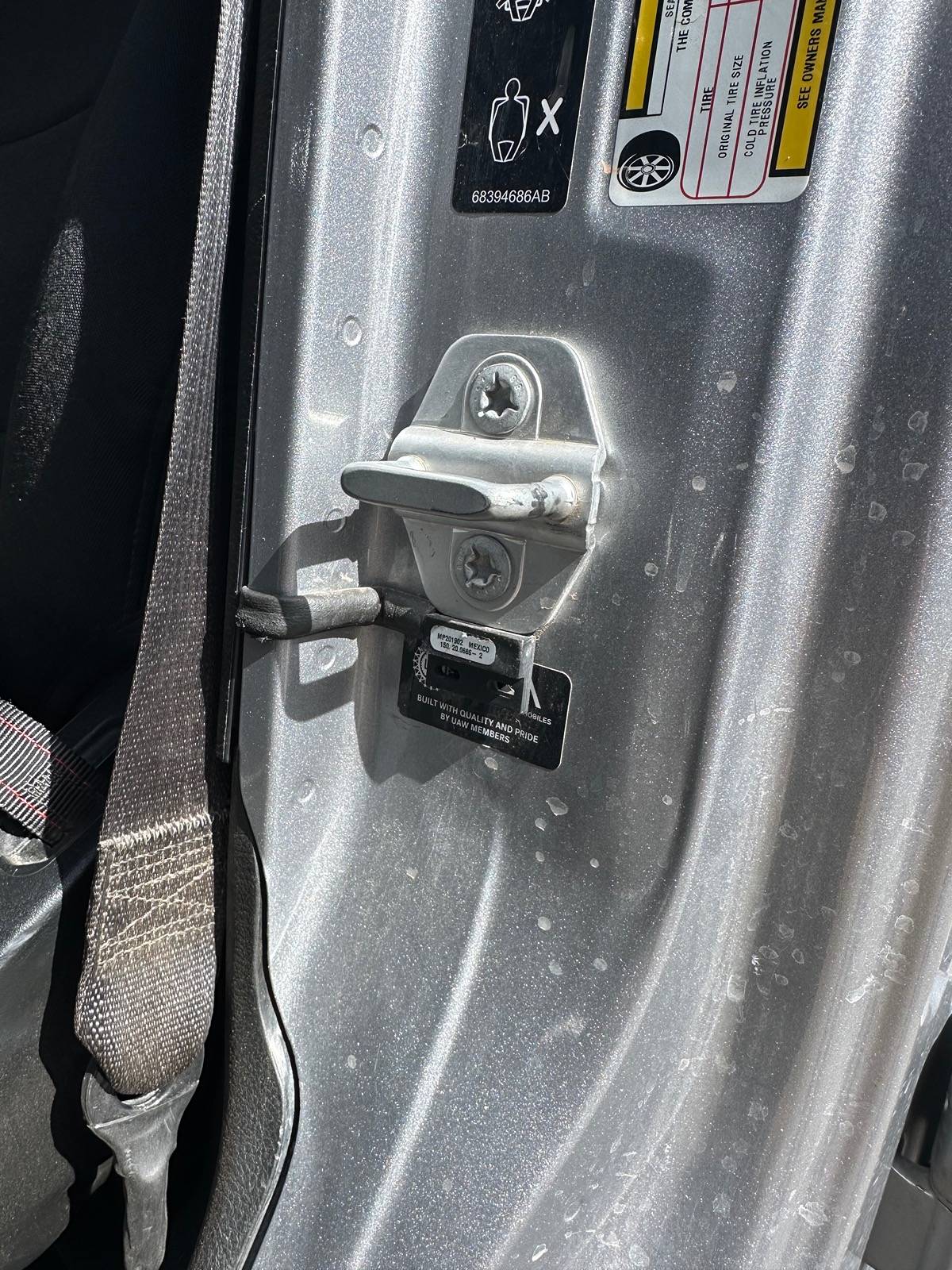

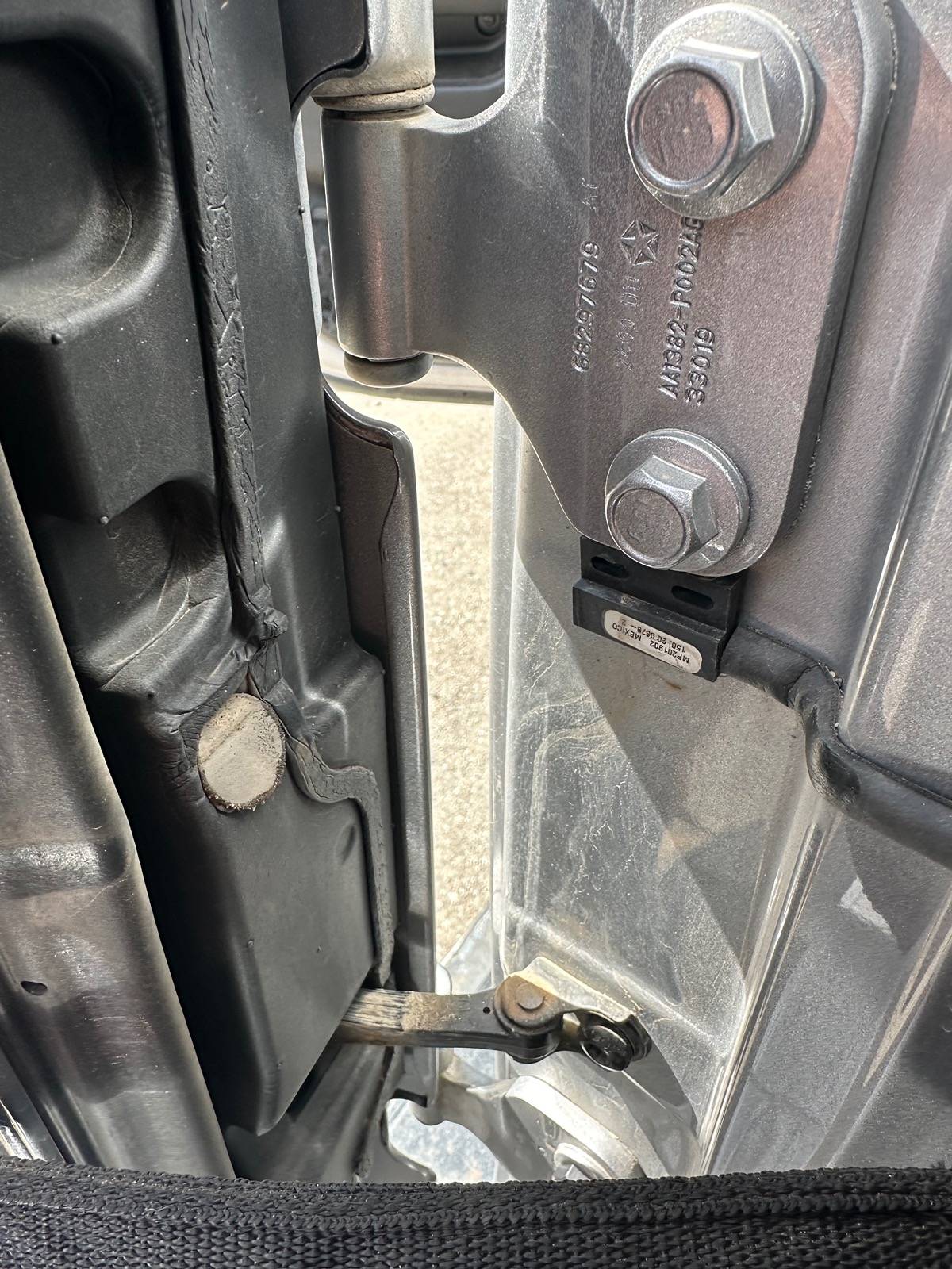

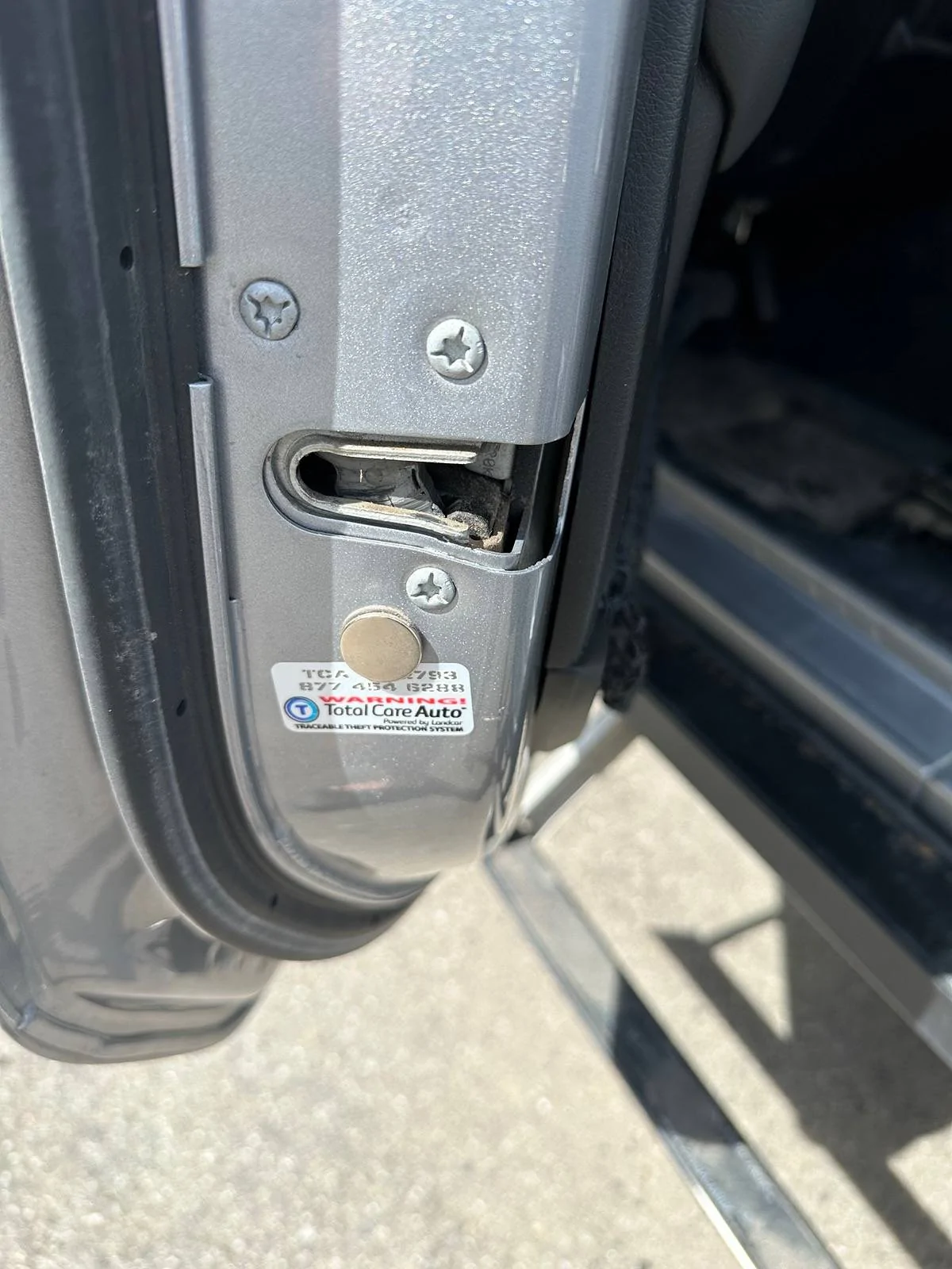

I saw a video where the guy mounted the switches to the door jam next to the hinge area. Is that correct or do they go near the back of the door where the locking mechanism is?

Front doors get magnets near the latch, with sensors on the b pillar. Back doors also get sensors on the b pillar with magnets on the hinge side.
What this fine fellow here said................
I used painters tape to position the magnets and test before actually taping them to the truck. I then measured precisely where I had them on one side, and tried that same position first on the next side, with painters tape. Saved me some time and frustration.
Don't be worried by the position of the magnets on the rear door hinge area. It works fine - seems funky, but works.
I installed these on 2 Jeeps and have no complaints. I've only had them "freak out" on my a couple of times, and once the dealership did some work and I had to pull the fuse to rest the because one was hanging down half way........
(they had to pull the body off to change the transmission on the Wrangler, I'm shocked that the steps were in great order when I got the Jeep back!!)

Here are some pictures.
EXACTLY. And that bottom one shows what I mean by the funky magnet position. It works just fine! Been working fine since February or March of 2023 on both of our Jeeps.

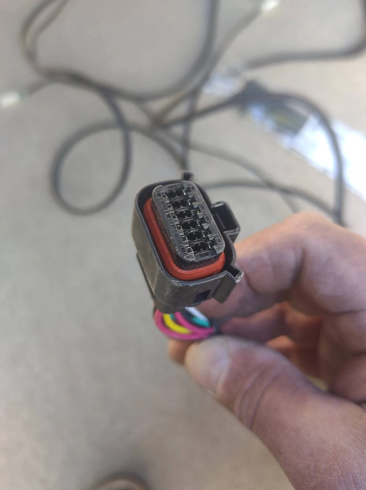

Seems so much easier to run the harness under the carpet than risk a second hole on the drivers side. What's this plug for it won't go through the floor.
Never mind on the plug.
Only the sensor wires go through the floor. If you run it under the carpet, you’d still need to go down with the motor and light plugs. So you’d still need both grommets.
Run under the truck and like said, run only the switch sensors up and the leads to the switch that runs to the dash.
Trying to out-think it will actually take more work and time.
I drilled the floor plugs for my own grommets and sealed with - wait for it - flex seal and flex tape. On the top of the floor under the carpet I used aluminum duct sealer tape.
The holes are already there - use 'em.
You need the harness under the truck to connect to the step modules in the steps and the motors anyway. And the harness runs to the batteries. Trying to run it inside means those big connectors have to go through big holes, and you have to get through the firewall.
