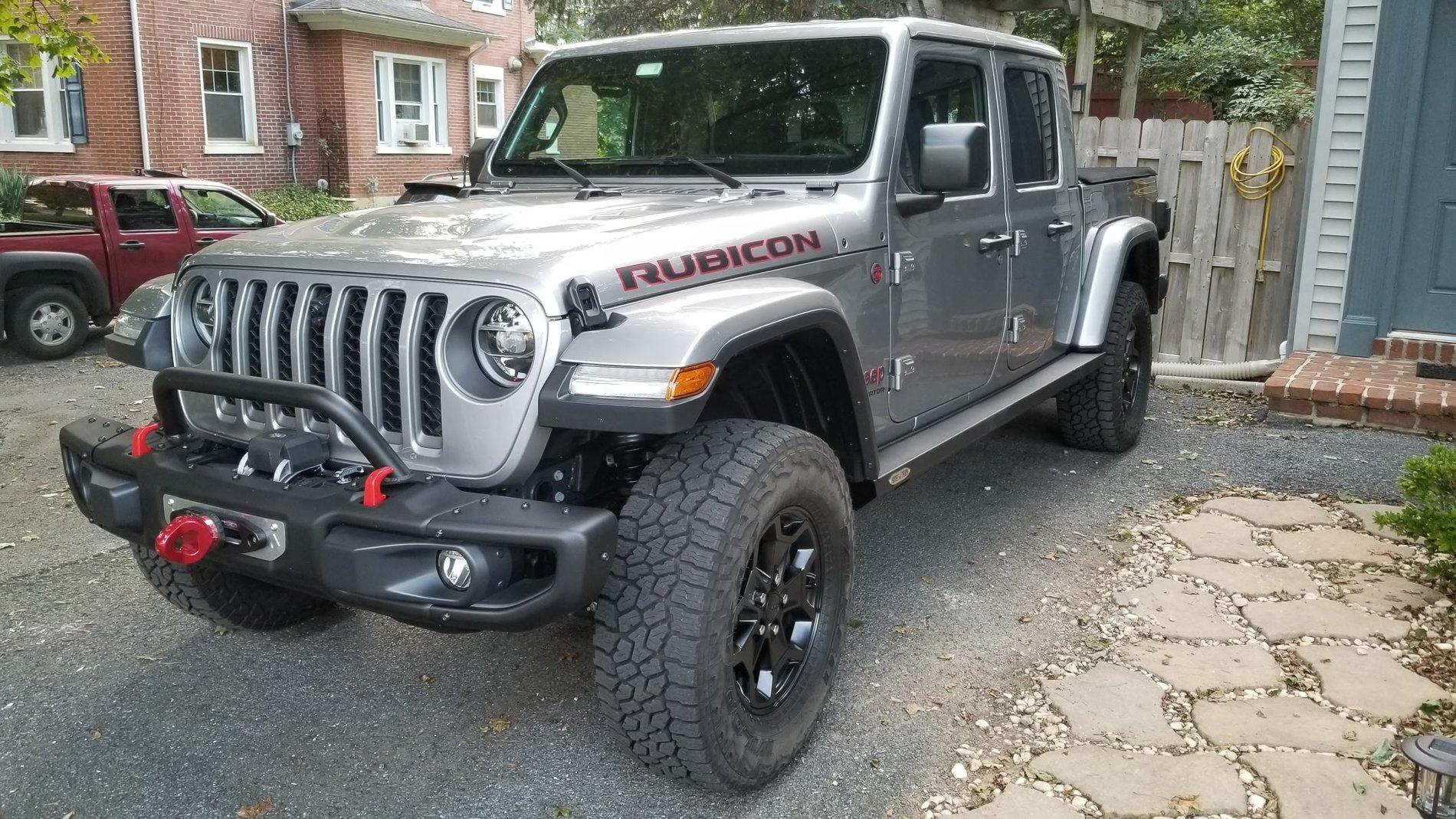

I put a set on this weekend. The extension doesn't bother me, and I don't know that it will matter if the skins are installed. Seems like smart manufacturing if you can make them work for two vehicles just by adding some bolt holes to the original slider then making extensions. They seem pretty heavy duty out of the box, but I wouldn't do anything crazy without the skins. Pricey, oh hell yes, but wife likes them to get in and out of her Jeep and that's seems like a good compromise to be able to lift the Jeep and put 37s on it. :turkey:

Awesome! The only think I wish it had was a longer step so the wife can reach in the bed.
I’m assuming the top of the step is pretty sturdy? Will I be able to stand on the end near the rear tire and reach the top of a bed rack/cap for instance?

You can climb up the step to the top of the slider and reach the roof/front of bed. The slider stops just under the rear flare, so as long as you're holding onto something, you could step to the rear tire, just like any other slider. They are just as sturdy as anything else that mounts to the pinch seam/body mounts.

Awesome, thanks for that!
Last question. Now that the money is gone and the steps are on, any regrets? It’s a big pill to swallow!

Negative. I took a look at what was available, ACE, Rock Hard, JCR, etc. All are nice and adequate for offroad. I even thought about making my own since we have the equipment, but wanted something low enough for her to comfortably get in when she's dressed up for work. Nothing really gave me that unless I made a detachable step for mine or someone else's slider. There are sliders/rails with steps out there, but I doubt they are up for anything but looking good. One brush with a rock takes care of that. Once I take care of some other things, I'll probably spring for the armor covers at some point, but not putting the side armor on as I don't want to drill into the tub.
The other thing I appreciate was the CS from Rock Slide. Had some questions during the install and they were super responsive and helped us out. I also left some feedback for them (markup in their instructions) which they said they would incorporate/ look at changing. Same with RubiTrux, who I bought the sliders from. They had them in stock and sent them out right away. Just good peeps all around.
