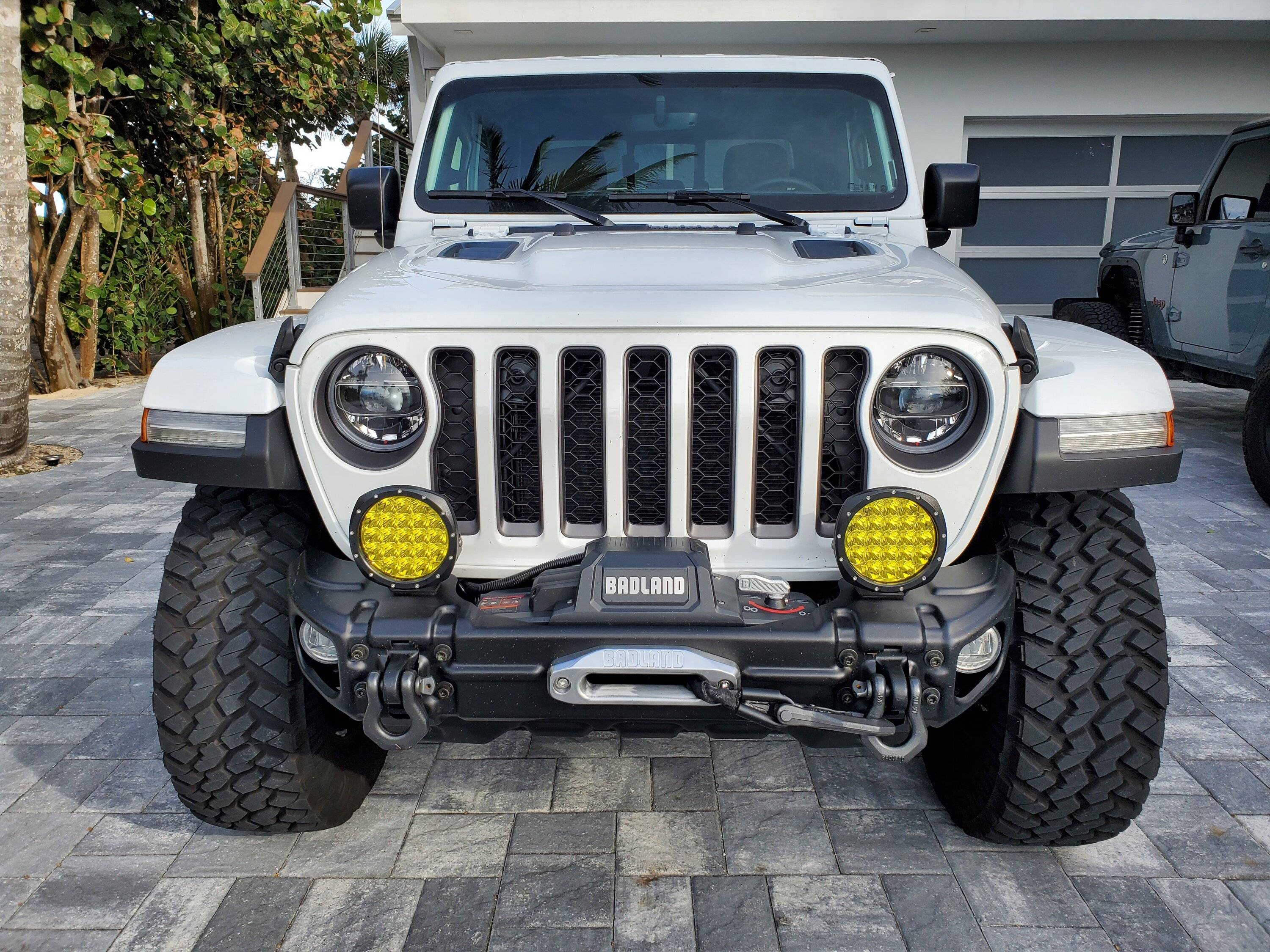

When you say "cut the round nib off the back of the shackle mount" are you talking about the part that kind of sticks out the front around the 'root' of the shackle mount? I'm torn between trying to replace the horns with these shackle mounts, or using the spacer to raise my lights above the horns.
The frame horns have a hole where the otherwise flat back/base of the shackle mount "round button/nipple/nib" would key into if there was not a winch mount plate covering the face of the frame horn.
It's way easier to cut the nib off than to perfectly layout and drill a hole in the winch plate.
I just bolted the inside holes of shackle mount to the outside holes on the frame horn to hold it while I used a Sawzall to cut across the back to remove the nib.

If you switch to the Teraflex tabs , you will be able to use shackles. They stick ot farther than the RR? that you used.

There is still the same amount of space to insert the hi-lift using the TF tabs.

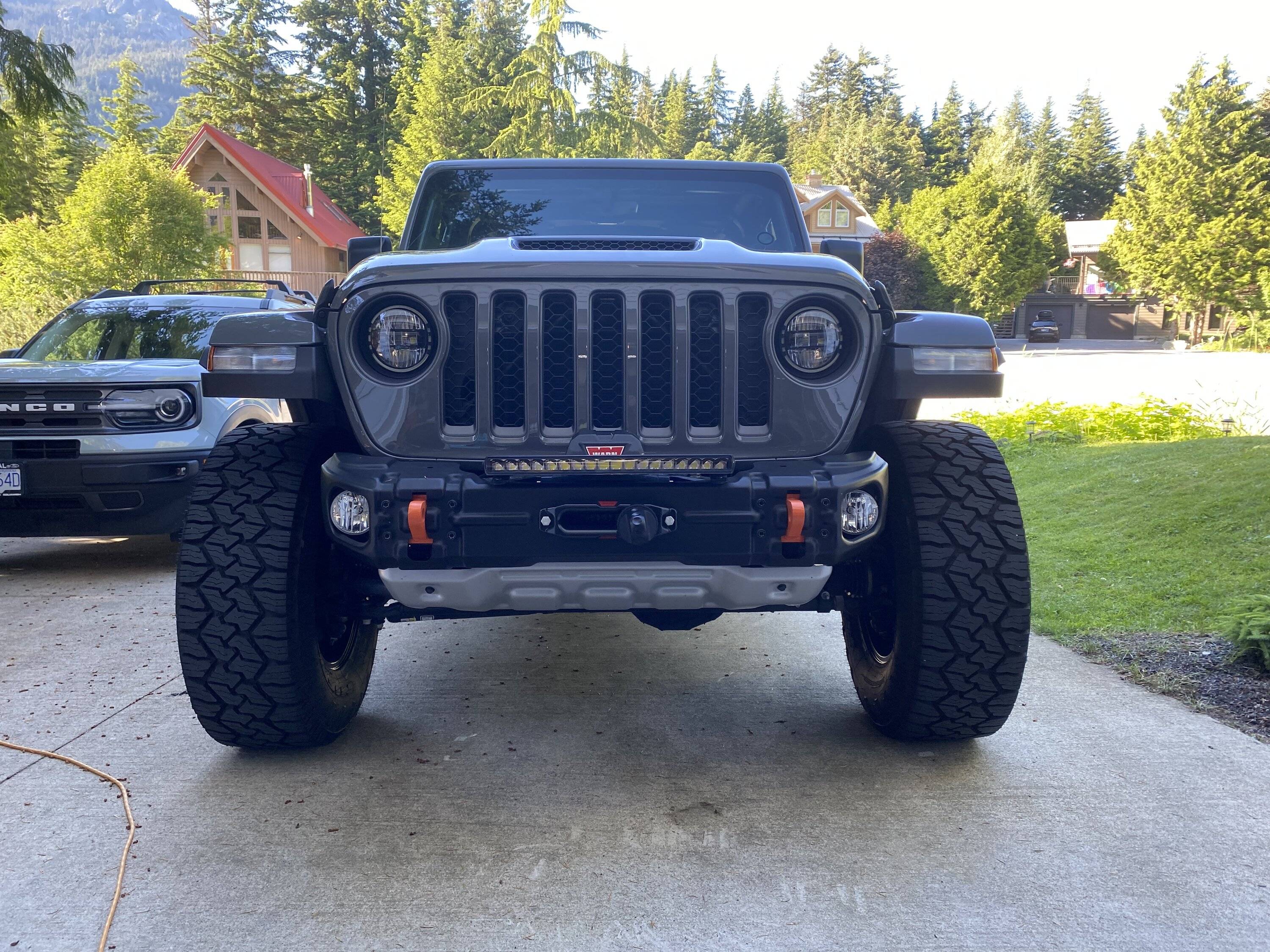

Have it on my Mojave with a Warn 10S. Yes the cables are tight but they were on my previous zMopar bumper too.
Do you have a link to the exact shackle mounts you used here? Did you paint that portion of them orange? I havent installed my Arcus yet. Is this something you want to do while installing or can you replace the large hooks with the shackle mounts afterwards with little effort?
They were from amazon and I cant find that link anywhere. Just the JK shackle mount from Rugged Ridge, should be on their website.
yeah painted them orange to match the Mojave trim. The oem hooks were orange and I liked the look. I would get it done first, the bumper is a slight pain to put on compared to oem Rubicon steel bumper.

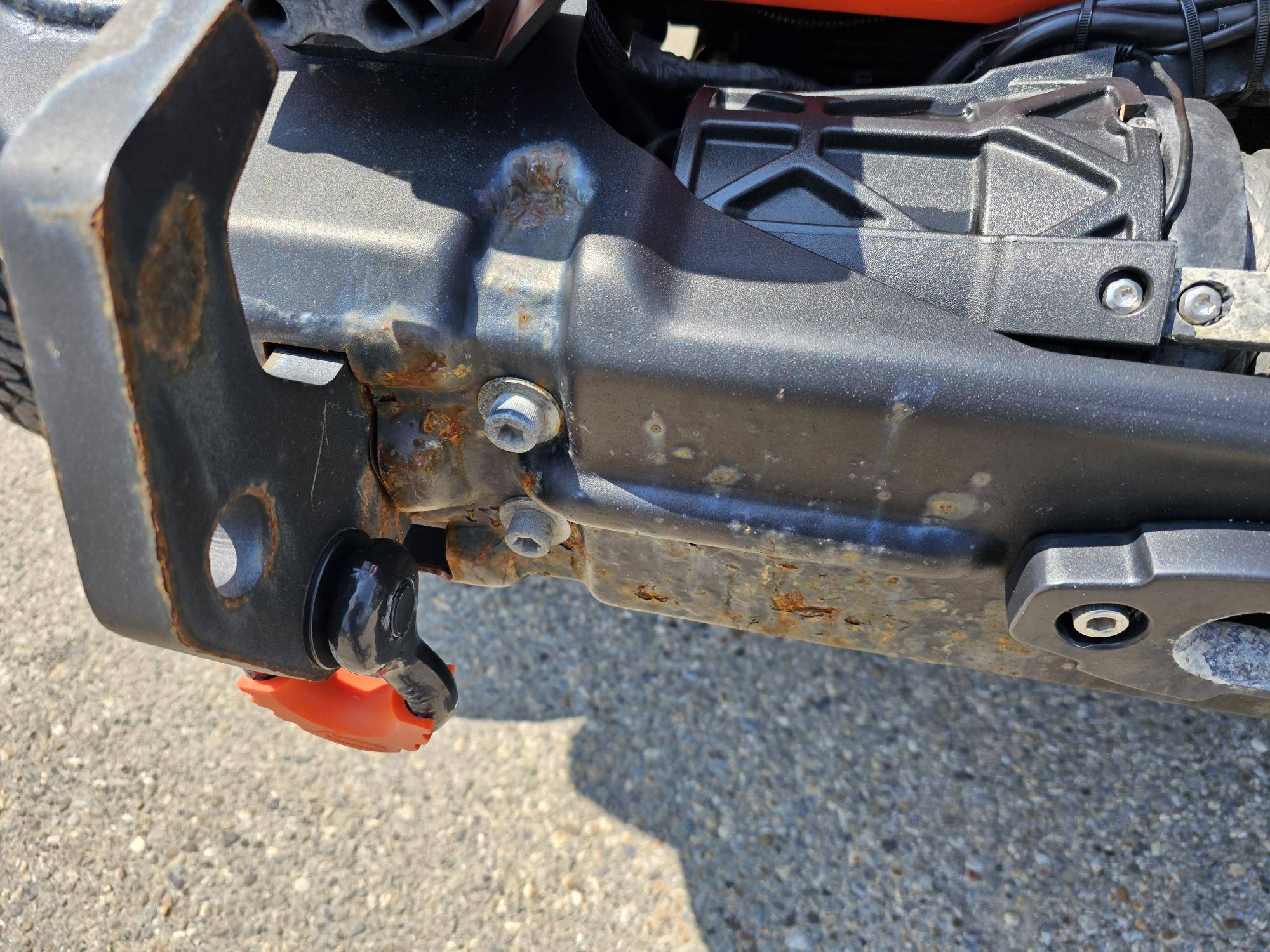

Has anyone repainted or recoated their Arcus? This is after just 2 years...
This weekend I'm going to hit it with a wire wheel and then try repainting it, still unsure what paint to use, but I'm leaning towards the Tremclad "pro" rust enamel flat black.
Local shop asked if I wanted to order another when I sent them this pic, ummmm, no thanks ?
