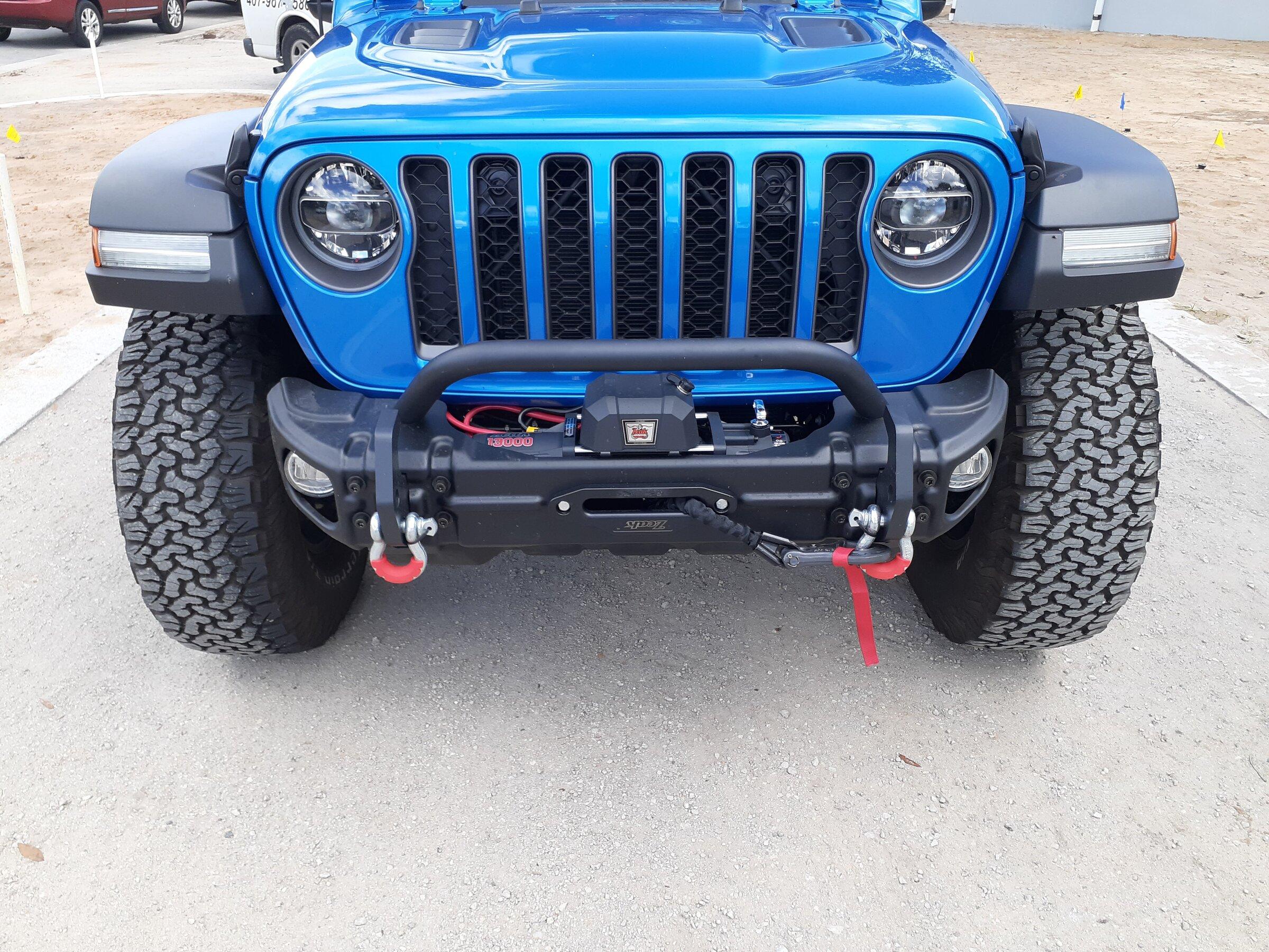

Thanks. One last question. Did the factory LED fog lights fit?
My Sport S had the factory "Premium" plastic bumper with fog lights. Upgraded to Oracle LED fogs without a problem. Then moved them over to the Arcus bumper again without a problem.
One point to note...removing the wiring harness from the plastic bumper is a royal P.I.T.A. all the damn plastic clips etc. Just about have to destroy it.
Also did not reuse the factory plastic "skid plate". Only kept the metal cross member guard that mounts to crash bars. Will probably get the RR skid plate at some point.

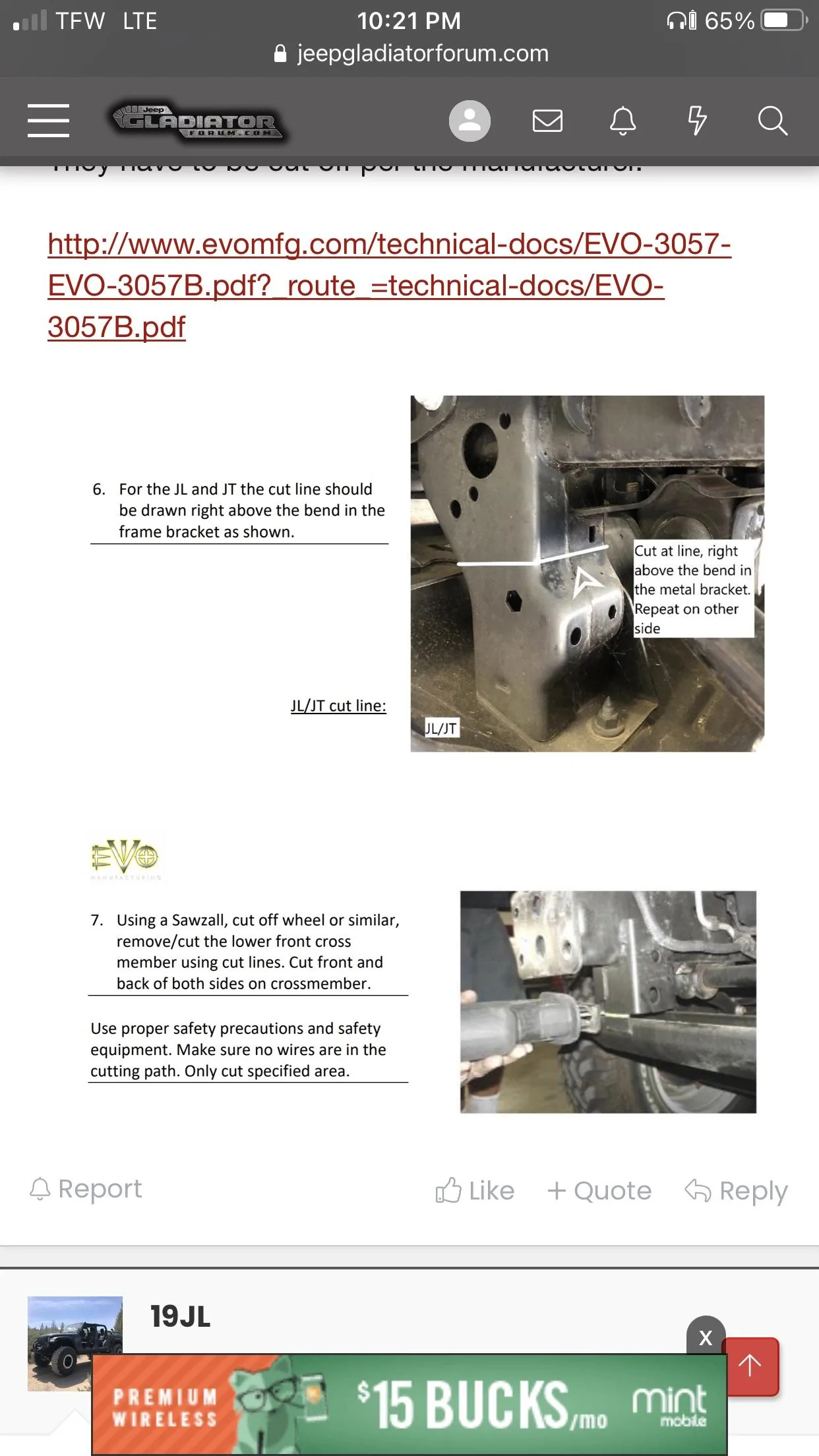

You answered my question before I posted it - that when going from a plastic Sport bumper, adding a skid plate is not required (but probably recommended)?
The factory skid mounts to the frame horns that hang down. Some people cut those off for more clearance under the bumper.
