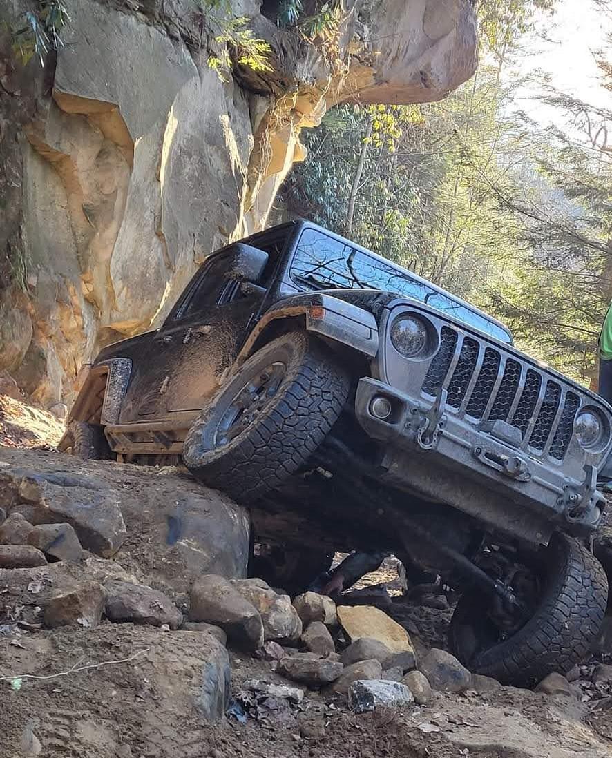

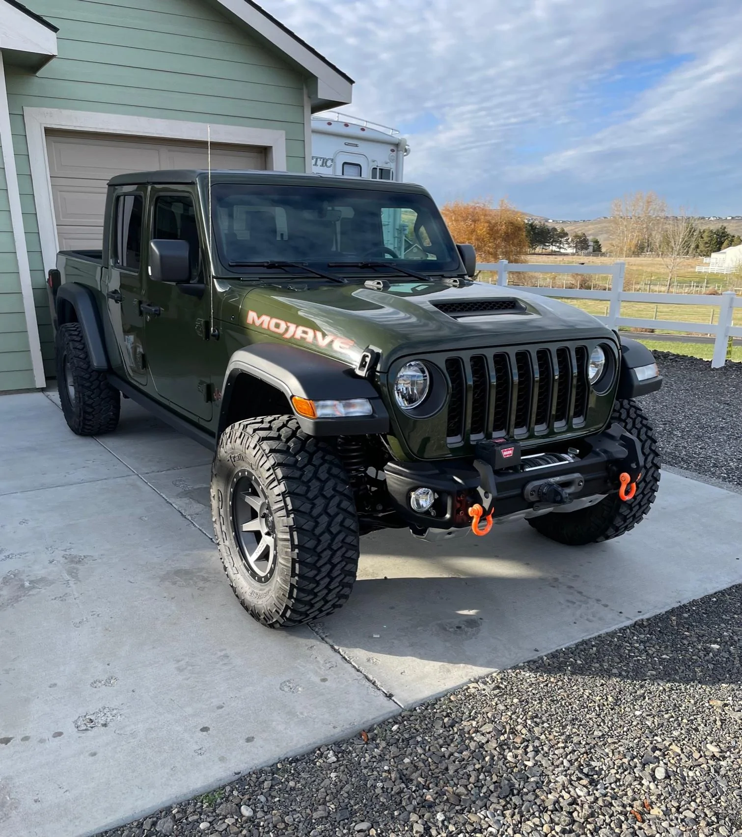

My Sport S had the factory "Premium" plastic bumper with fog lights. Upgraded to Oracle LED fogs without a problem. Then moved them over to the Arcus bumper again without a problem.
One point to note...removing the wiring harness from the plastic bumper is a royal P.I.T.A. all the damn plastic clips etc. Just about have to destroy it.
Also did not reuse the factory plastic "skid plate". Only kept the metal cross member guard that mounts to crash bars. Will probably get the RR skid plate at some point.

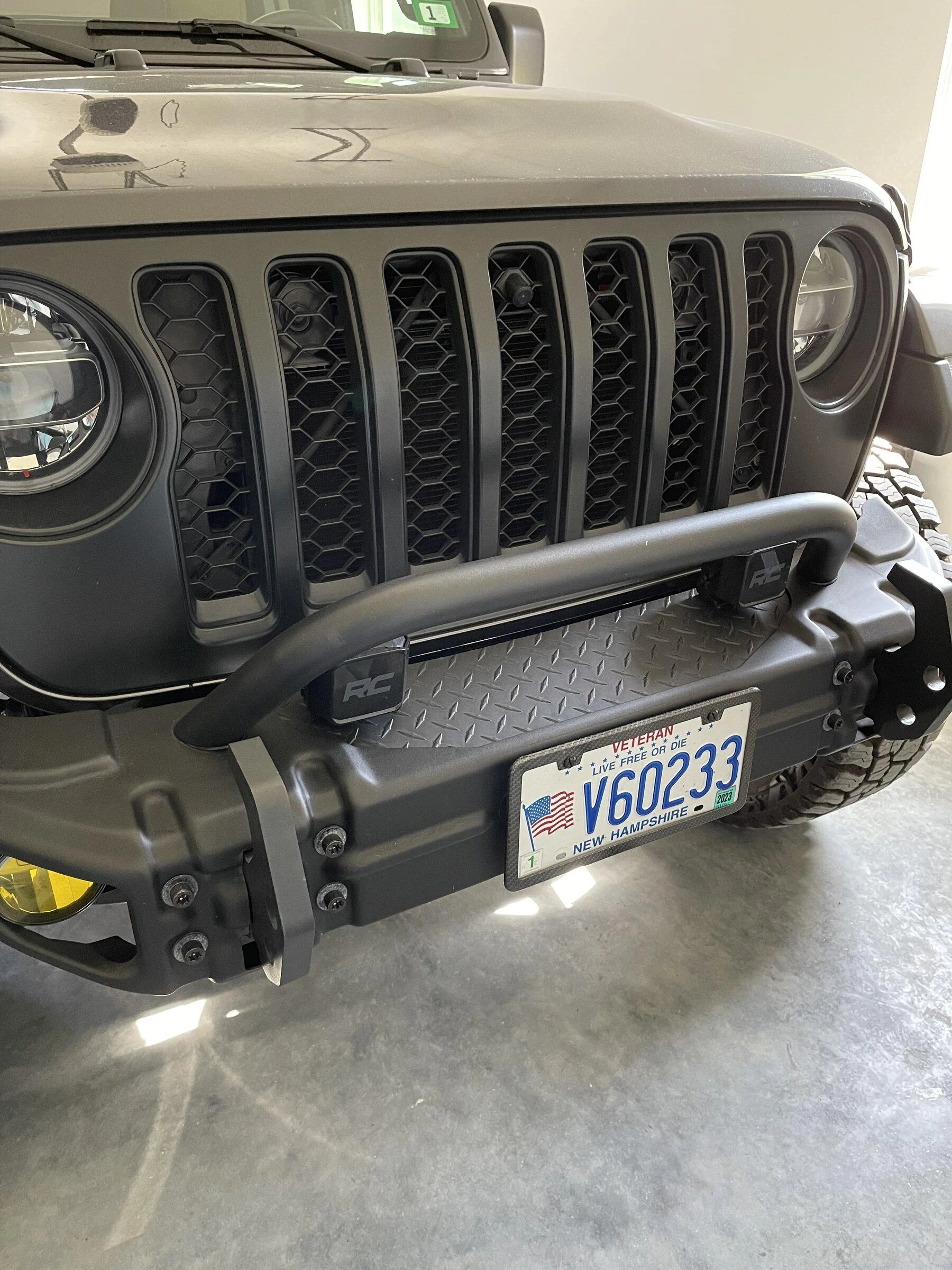

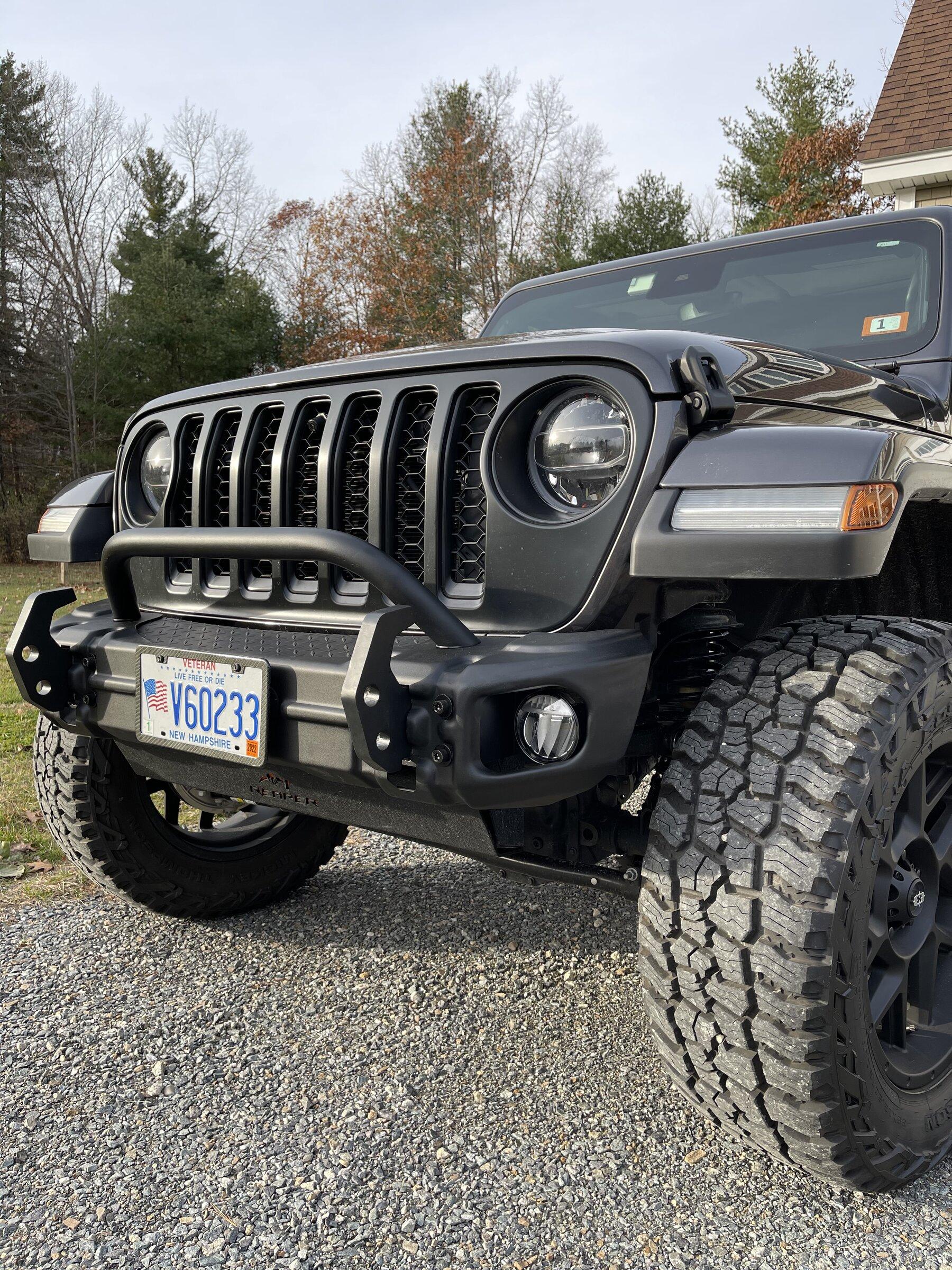

Did you mount the RC lights to the plate?
Yes. Under the plate is a piece of aluminum flat stock. Used that to stiffen the plate and provide a mounting surface.

aluminum diamond plate custom cut and sprayed black.
How did you attach the diamond plate?? I will eventually get a winch but want something to cover the hole for the time being. I found some inexpensive abs black diamond plate. But haven't unboxed my Arcus yet to look and see how I might be able to rig something up.
Use some sturdy cardboard to mock up a template. It’s not straight or rectangular. Lots of subtle curves and angles needed to get it just right. Once it’s perfect, transfer the design to your material and cut it out. The plate is held in place with the overrider bar and the flat stock for rigidity.

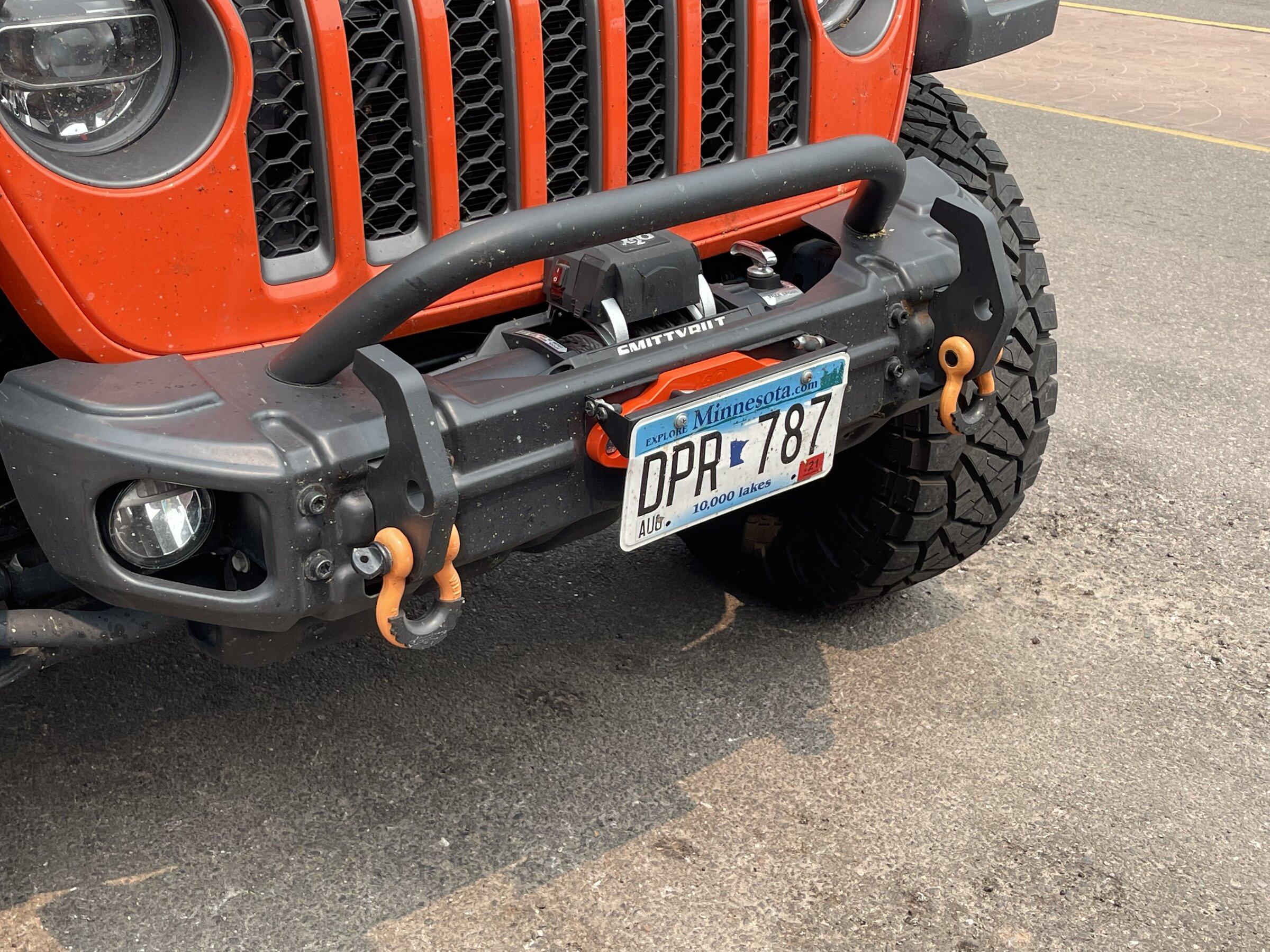

My Arcus started to rust around the front bolt holes after about 18 months. I had it stripped and re-powder coated with a primer underneath. We’ll see how long it holds up this time.
