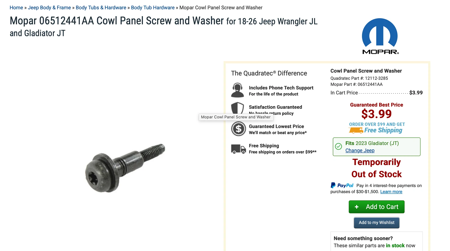

The bolts (found most of this on the internet, extrapolated some of it)
6mmx1.0 so a 6mm bolt, 1.0 thread pitch.
length is 65 mm from bottom of hood to ends of the threads (there's what looks like a taper on the bottom end so the actual technical length could be a bit more - like 66mm
Shoulder is 48mm long and I figure 8mm diameter.
You could fudge a bit on the diameter due to what it does and how it works to hold the cowl.
So I figured a 6mm bolt, and a shoulder of 8mm which looks correct in pictures- the shoulder being about 1mm thicker or proud of the threads.
I suspect from the pictures, it's a standard button head bolt with a captured washer under the head.
OK, those who have pulled these apart - is that at least close?

So where do you find this 'standard button head bolt' that meets all the specs?
Also, what about the washer? Thickness of the washer is critical because it sets the distance between the bottom surface of the washer and the bottom surface of the shoulder. When you tighten the bolt, it tightens against the bottom surface of the shoulder. The distance between the bottom surface of the washer and the bottom surface of the shoulder must be correct or you could either crush the plastic cowl or end up with a loose cowl.
My one and only concern is the shoulder.
Washer? Really? You can buy those in so many thicknesses it's amazing.
Depending on the shoulder, you could use a thicker or thinner "washer".

As far as finding them - easy as heck - Amazon or McMaster-Carr
But you couldn't find them.
Again, Amazon or McMaster-Carr
Those aren't specially made bolts for just one application. They'll be pretty standard.
It's not rocket science. Pull one, measure it and look it up on any bolt supply site.
Nope, not standard. Wrong again.
I'd rather not mess up the plating or paint on mine, but have found shoulder bolts quite similar within 2 minutes, so it's still possible. An alternative is a bolt with a sleeve. Problem solved.
There's no way you have to use a MOPAR screw there.
It's what you do when you are in restorations - have access to almost anything.............
Now you're too worried about messing up a bolt by removing it? But, maybe that's "what you do when you are in restorations".
Anyhow, for the benefit of the forum members, make sure to post a hardware list for the replacement of the cowl bolts when you come up with it.

Since it's believed I'll never come up with proper replacements - I'm going to quit looking. Too bad, was really close and found a bag of 25 for $65 (almost correct, was going to write them as they had a whole page I didn't feel like going through.)
I figured for that price, I'd buy them, plate them black zinc and go from there. Maybe sell them for 3 or 4 bucks each. Forget it.
$2.60/bolt. But getting mocked for my efforts, forget it. I've got other things to do.
6mm x 1.0 thread, 8mm shoulder. I was 5mm from the correct shoulder length and said screw it.

I must have missed the post where someone proved these bolts are so custom in size and length and shape that there is no "standard" replacement available from any company (McMaster Carr or other), not even ones that could be shimmed with available washers. Can someone point me to that post where someone took one of these bolts out and tried a suggested replacement and it didn't work?

This is what the '23 parts manual calls for and it is listed simply as "SCREW". It does not specify different screws for different trim levels; I don't know if Mojave is different. The other bolt that was posted, 06512790AA, isn't shown in the diagram but is listed in the parts listas "SCREW, CROSS RECESSED HEAD, M6X1.00X65.6, Cowl to Cowl End Caps"
Jeep Gladiator Rust on New Mojave Screenshot 2025-09-16 at 7.52.49 PM
