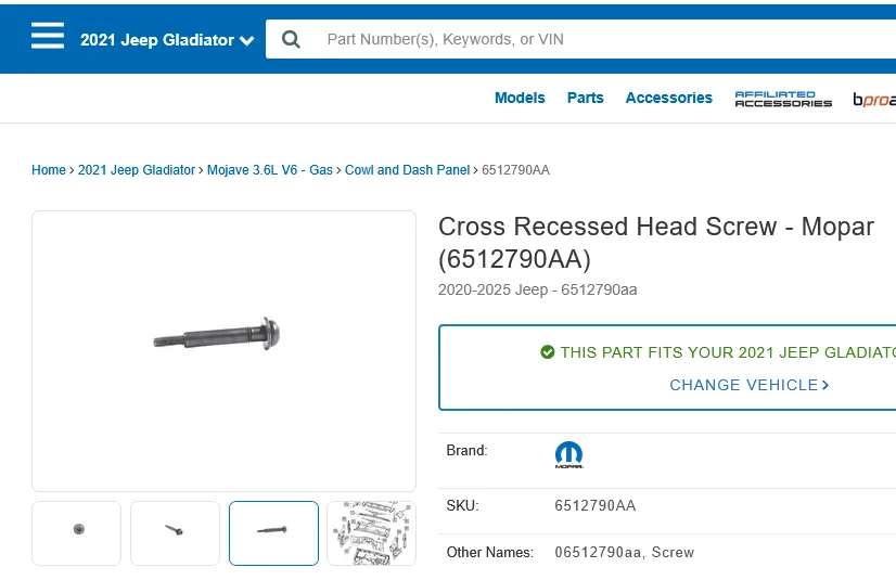

The ones that go in from the top certainly are.

It's a shouldered bolt. Go pull one out and measure it.
I'd rather not mess up the plating or paint on mine, but have found shoulder bolts quite similar within 2 minutes, so it's still possible. An alternative is a bolt with a sleeve. Problem solved.
There's no way you have to use a MOPAR screw there.

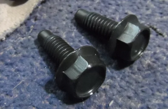

Get some from a wrecked Jeep, send them to me, black zinc plating. Then spray them with Eastwood clear if desired for even MORE protection.

Either way, they aren't standard off-the-shelf shouldered bolts available from the typical sources. I know you find it hard to believe that, but it's true. When my 2021 Mojave was new, I noticed a slight bit of orange around the washers of the upper cowl screws. I removed them & took measurements and went to McMaster-Carr. Nothing matched. Not a standard shouldered bolt, and no sleeves to be used with a standard screw. I supposed that something could be made/machined using standard stuff as a starting point, but I abandoned the project at that point. I applied 3M Cavity Wax to my existing screws, let it dry, then re-installed them. That was over 4 years ago and the rust has not come back.
