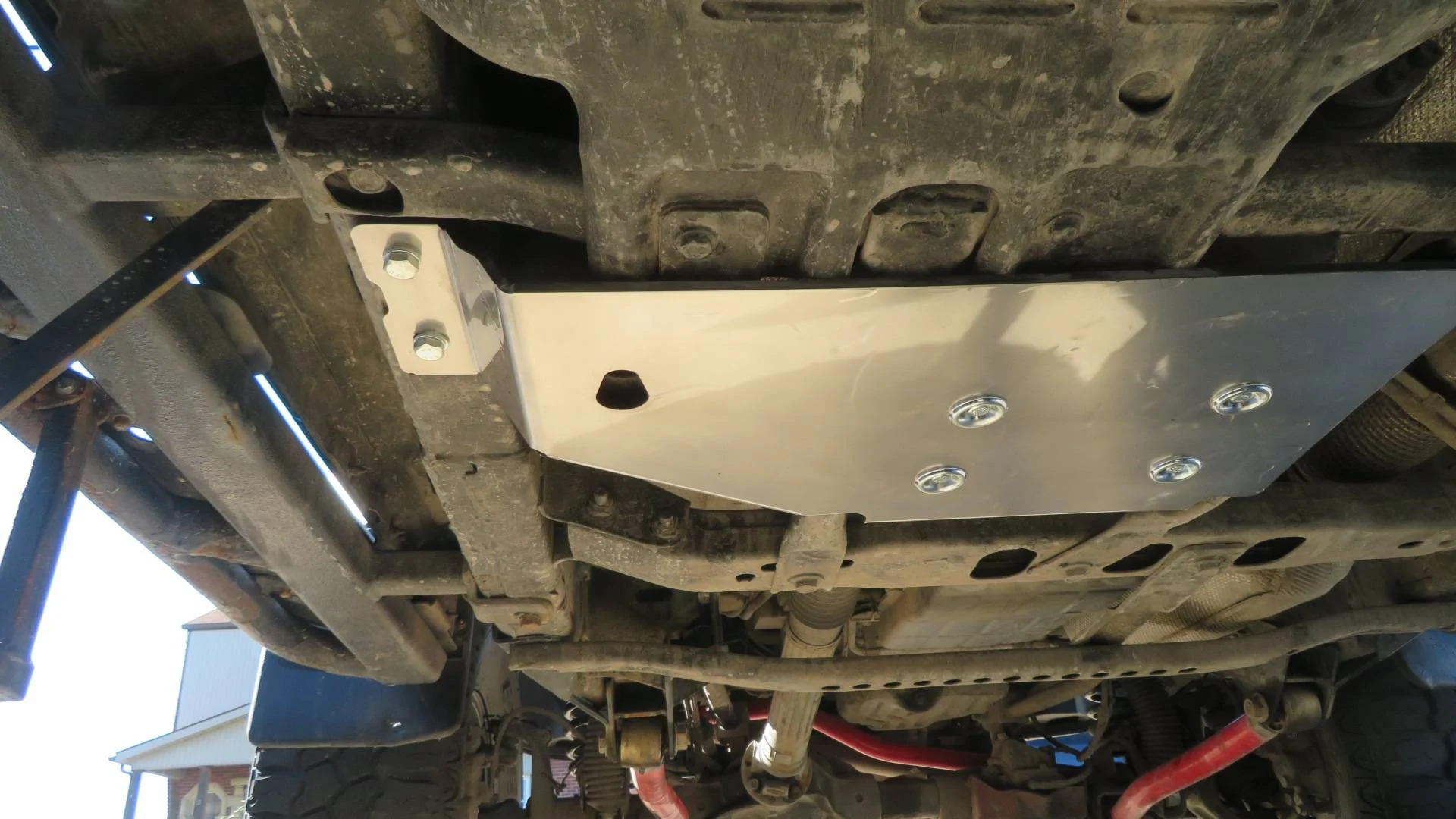

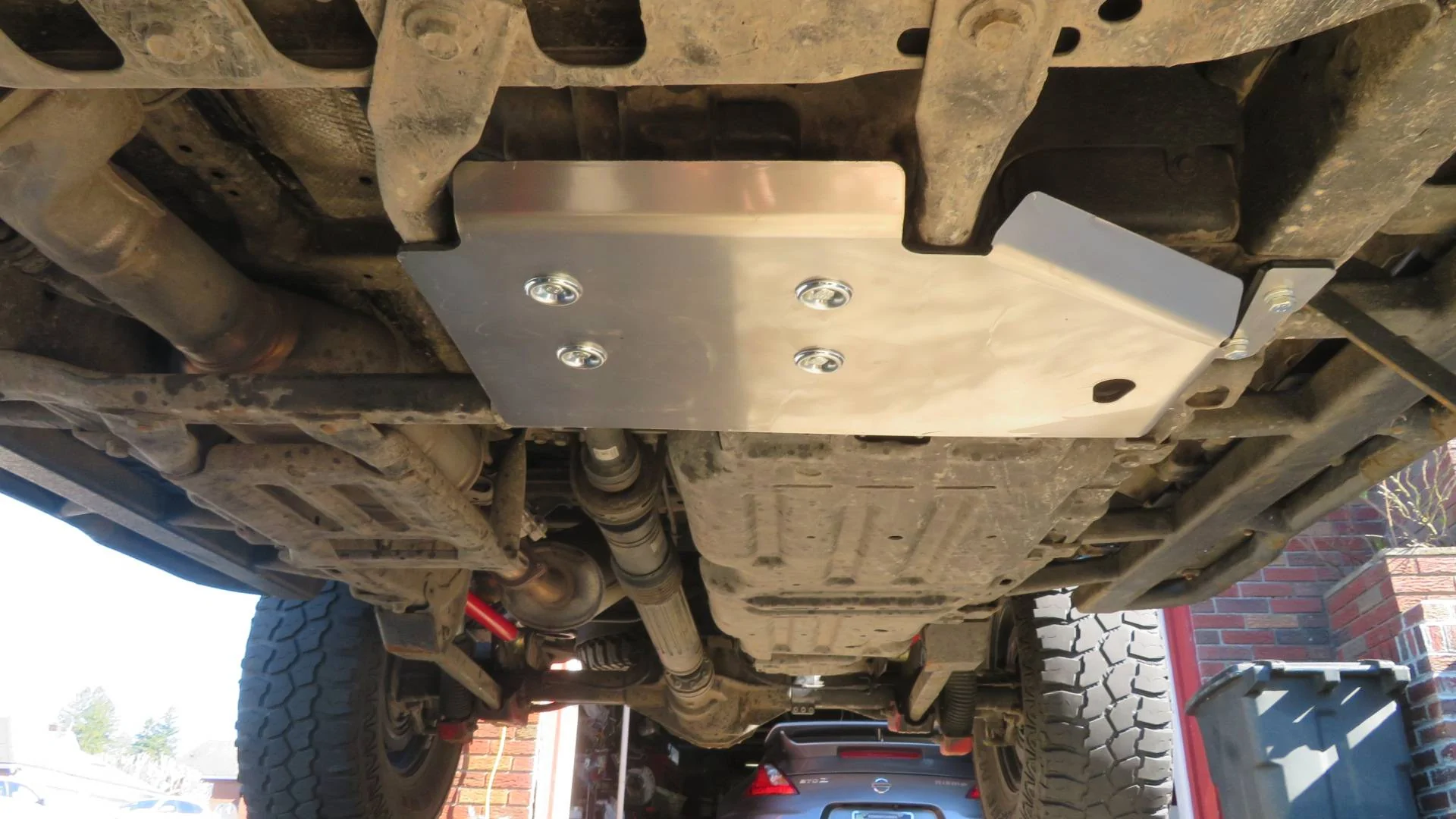

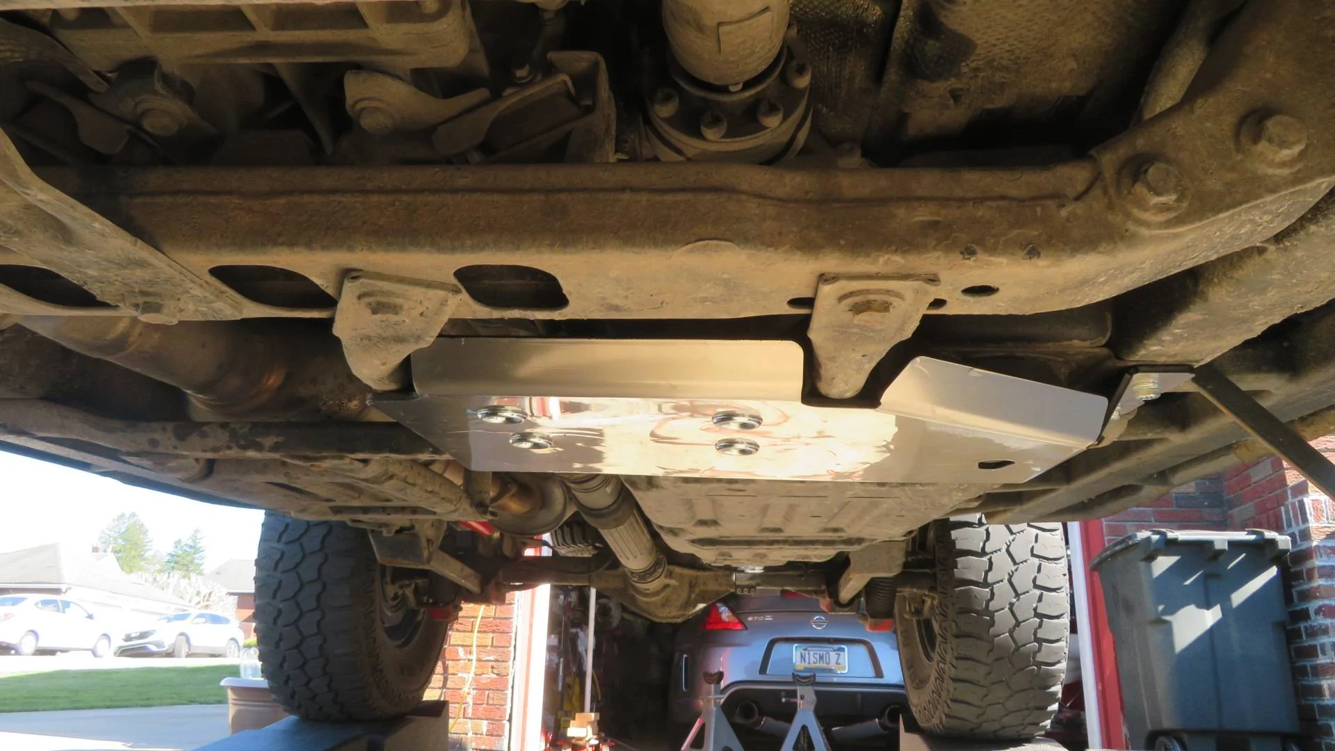

Got the ASFIR skid plate installed. The side that you can't see. I sprayed truck bed liner on it. The side you can see. I sprayed clear coat on it.

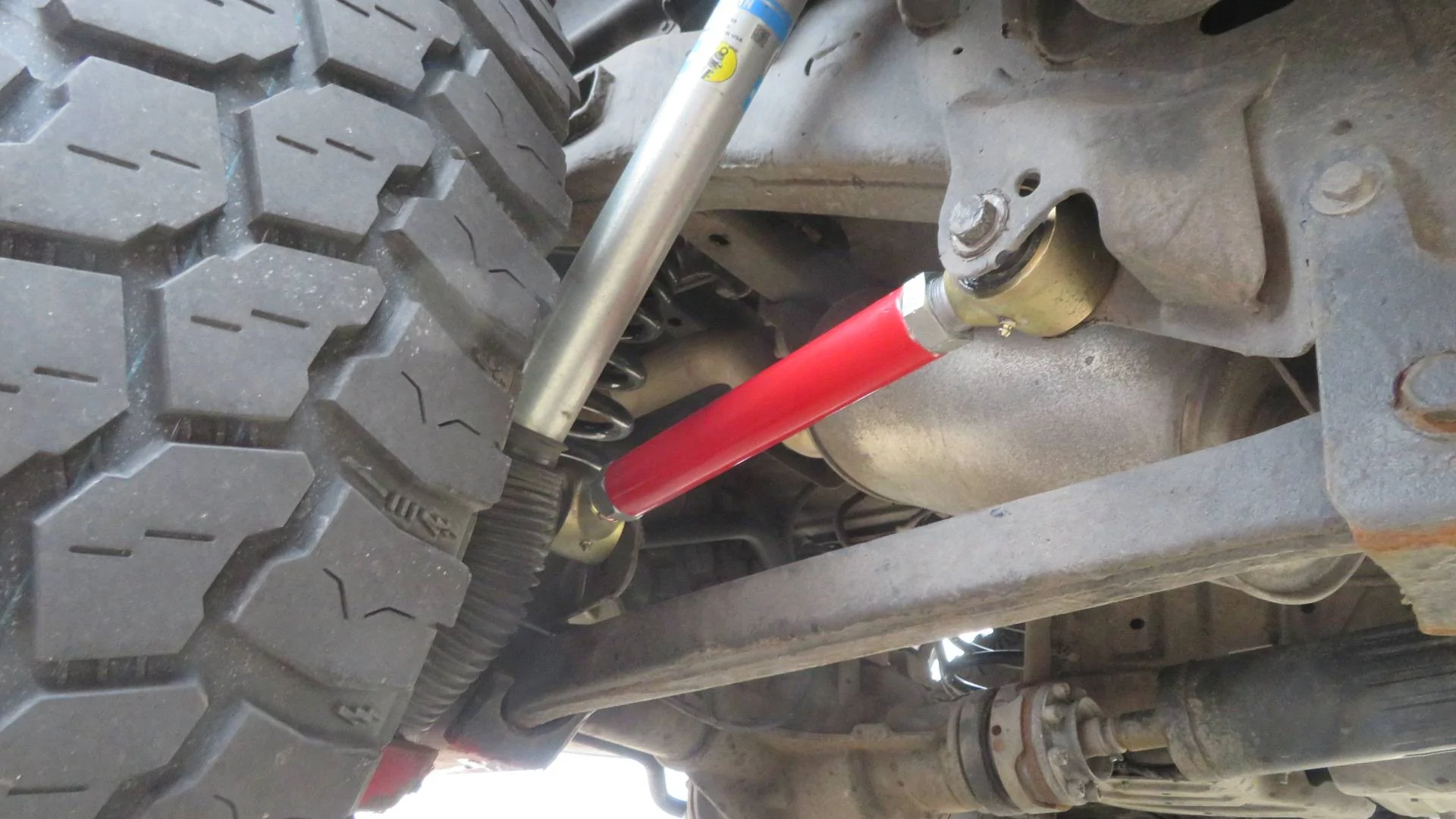

Got the front upper Core 4x4 control arms installed.

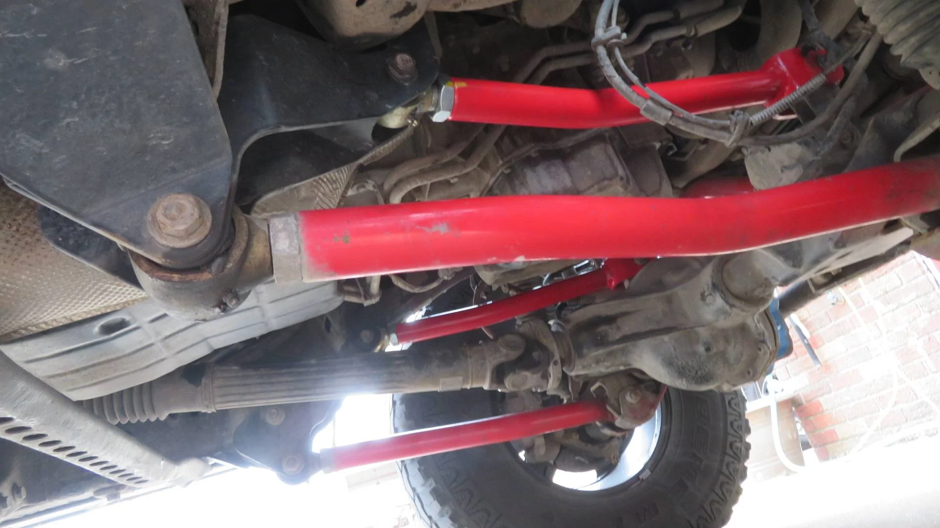

Got the rear Core 4x4 upper rear controls on. The rear lower are a major PITA because the axle bolt is frozen in the bushing on both sides. Have to order new bolts before I try again to remove them.

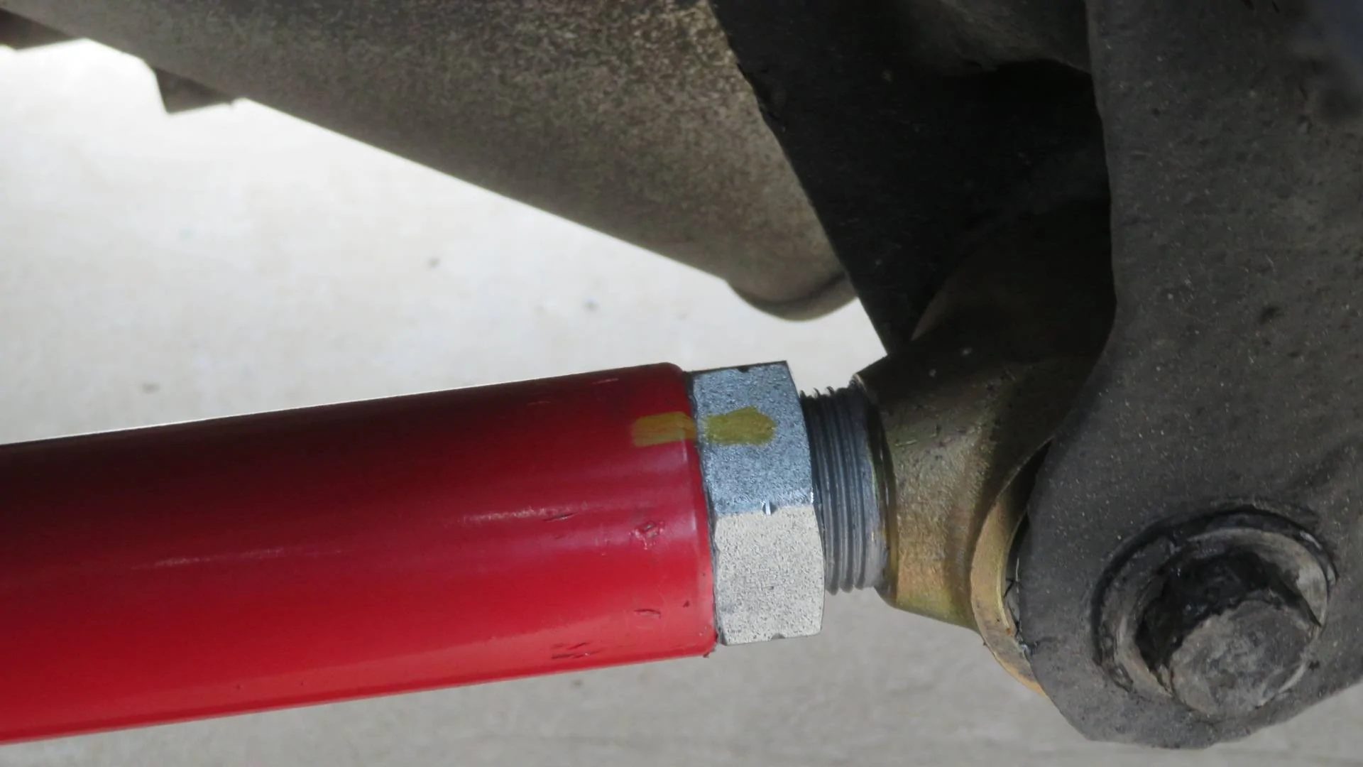

Marked all the jam nuts on the control arms. If they back off, I will be able to see with a quick look.

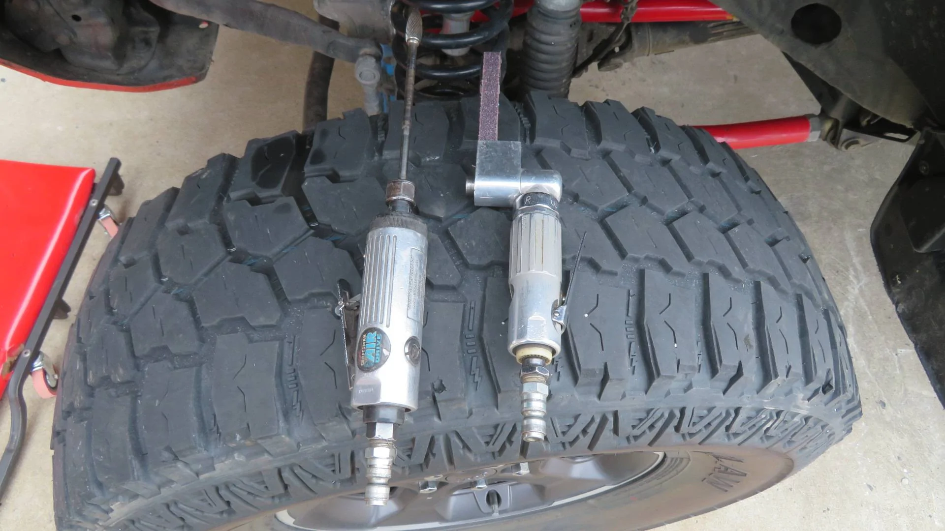

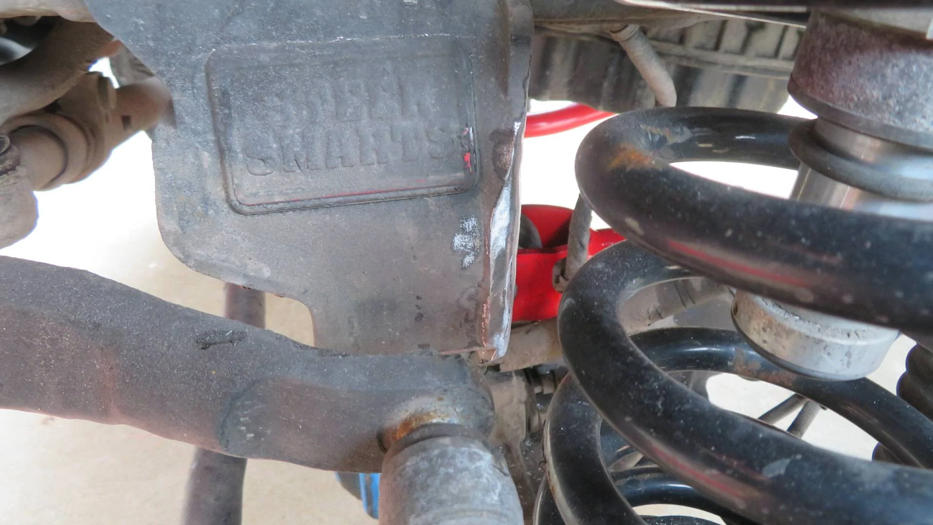

Clearanced the Steersmart brace where my coil spring was rubbing it on full stuff. Used a burr bit on a 1/4" die grinder, followed by a belt sander to smooth it out.

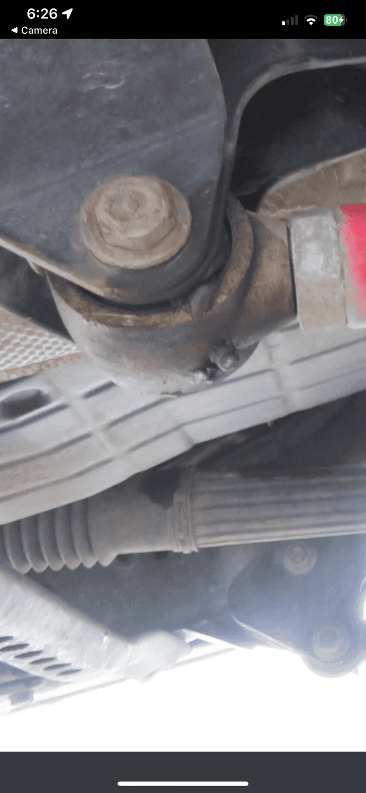

Is this mounted upside down? Seems like a design flaw just waiting to get rubbed of. As soft as the zirk metal is it won’t take much of a rub.
Jeep Gladiator Rusty PW Journal IMG_2525
12,004
32,043
That's for next weekend to do's list. I have to turn the joint around. Wasn't thinking when I installed the lower arms last year.
Engine skid ?
12,004
32,043
22EcoDs
Oct 14, 2021
1,526
1,689
NY
12,004
32,043
I'll rephrase. Did you purchase or plan to purchase their engine skid ?
I needed something right now for the fuel filter. I might get their engine skid plate. Would like Next Venture skid plates. But don't have $4,200 for it right now. Need other things first.
