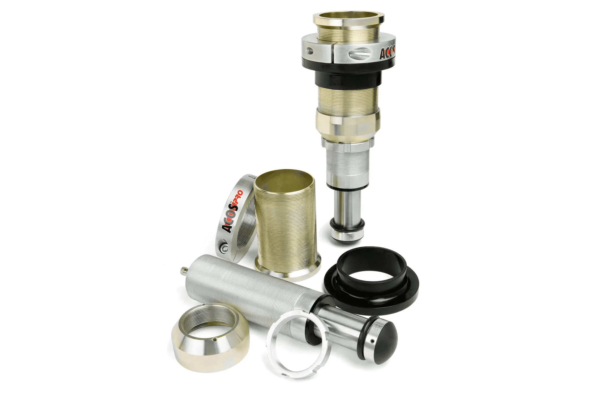

Ordered the JKS Front Adjustable Coil Spring Spacer with Hydraulic Bump Stop. ACOS Pro. Got it from @Northridge4x4 with the Black Friday Sale. Listed for $992. Got it for $754.

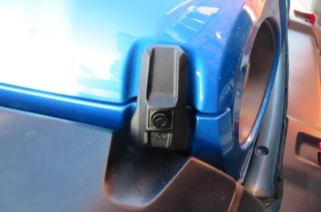

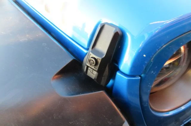

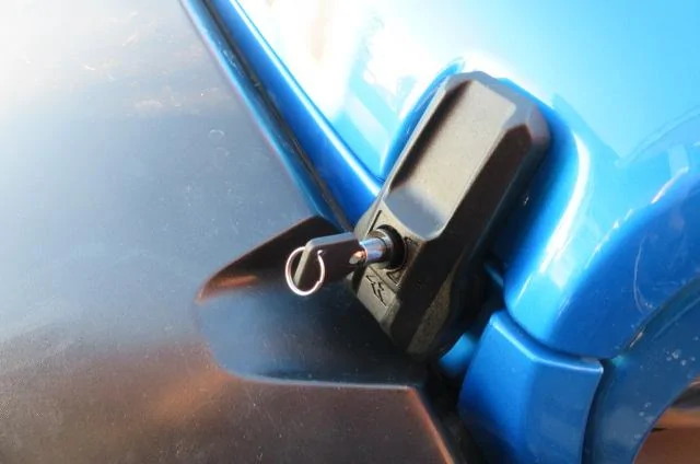

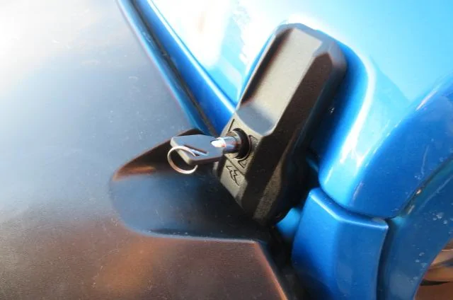

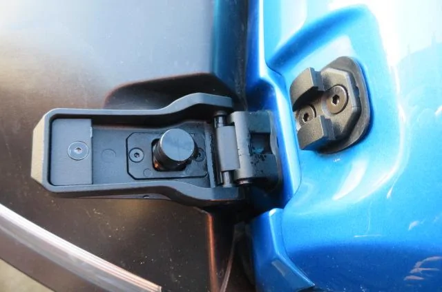

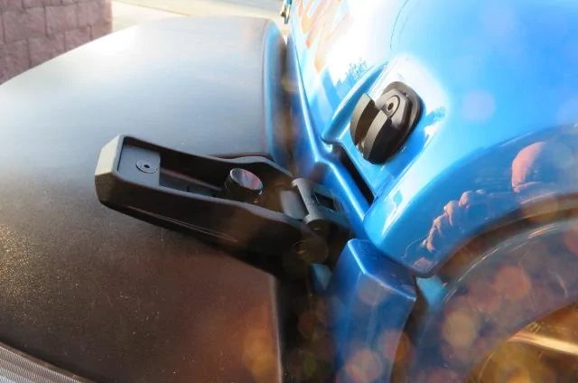

Took advantage of the warm temps today. Installed the Rugged Ridge hood locks. Think it took less than 30 minutes to do it.
To lock them. Just insert key, turn, and remove key.
To unlock. Insert key, turn and remove key. Push button in and lift the bottom of the latch.

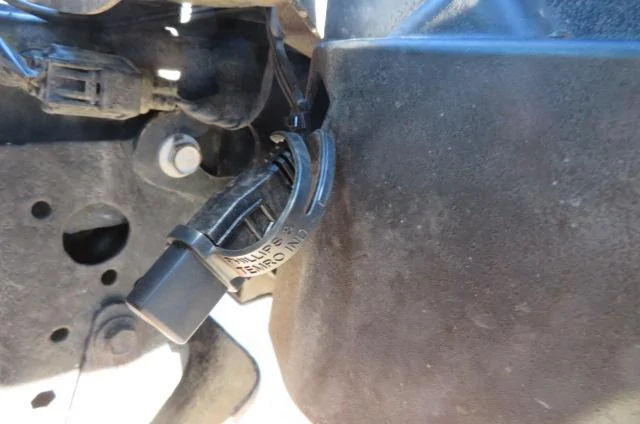

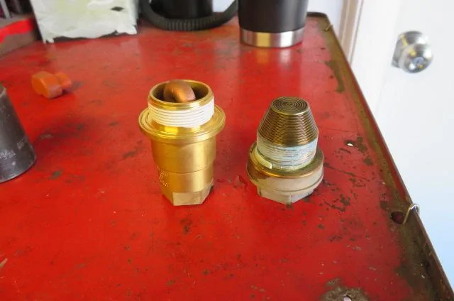

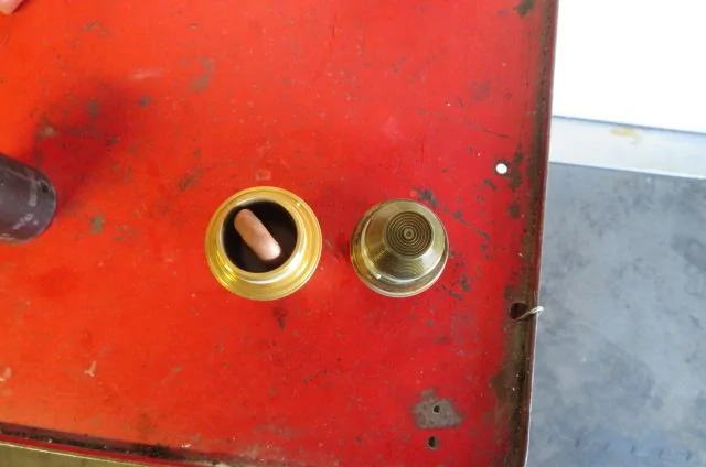

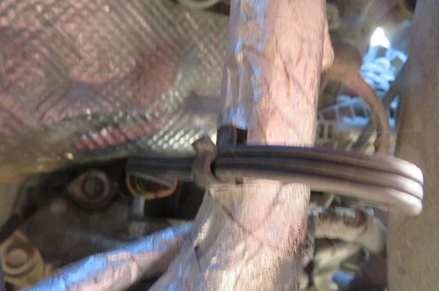

Installed a block heater in my diesel today. Simple job uh. Unscrew the block plug and screw in the block heater. Figure 45 minutes tops. Ehh 2 hrs later. I'm done. Got the old plug out with no problems. Start to thread the new block heater in. Didn't feel right. Took it back out and found the first 2 threads started the cross thread. Chased the threads and cleaned them up with a file. Put it back in and it seated. Torqued it to 75 ftlbs. That's where it bottomed out. Ran the power cord from the bumper back along the frame. Found hooks on the back of the bumper and on the frame for the power cord. It took just over a half gallon of anti-freeze to top it back up.
