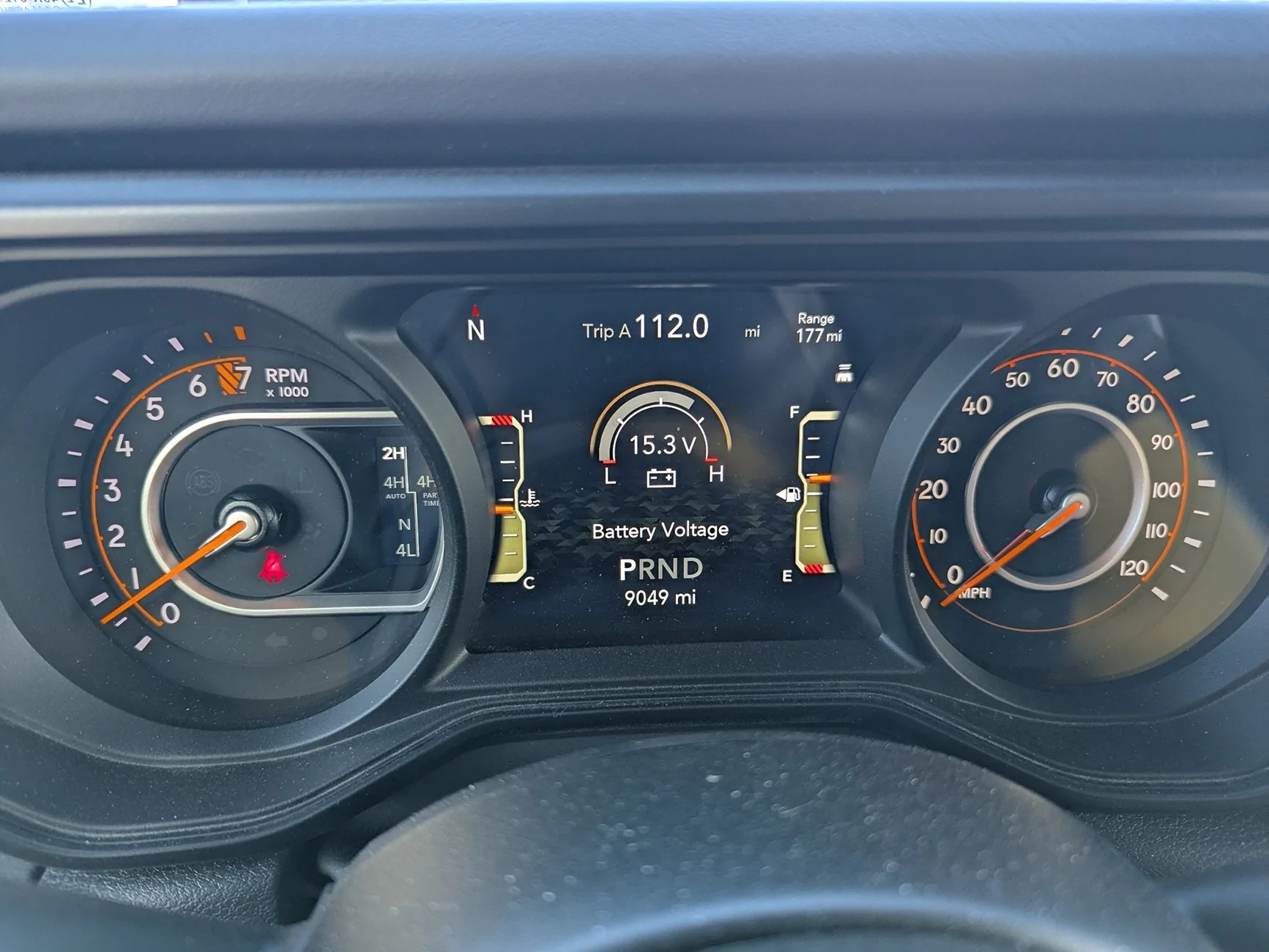

Saw 15.3 volts today
40,491
53,988
Pulled into a parking lot and saw 15.3 volts - that's .3 higher than I've ever ever seen on a Jeep before.
Just as I pulled into the parking spot - I swear the radio "blinked" - a fraction of a second it was black then came right back
Also after done in the store, I started the jeep, saw a song on the radio I wanted to hear, used the steering wheel button 3 pushes to increase volume and it kept climbing and maxed out volume - no way to reduce it for several seconds. My wife asked "what the hell are you doing!" - I said nothing - it's doing it by itself!

Have you done any electrical lately? I remember seeing you had a pretty involved system for electronics on there. Maybe something got crossed. Or was there a solar flare?

Nothing at all under the hood or even dash. First thing I will check is the connections at the batteries. For a fluctuation that large, that big a spread, and voltage that high - yeah, I'm going to wait until it's warm enough to open the shop door again and run it in and check connections.

Yeah that’s a heck of a jump. Mine has finally settled into 12.7-12.8V consistently. 15 is like it got water sprayed on it or something to cause a quick flash. I’m surprised nothing fused out.

Papa, if you remember my issue when it hit 15.0V and higher yet the voltge at the battery was still 12.7 / 12.8, that pack of 3 battery cables on the positive post and terminal closest to the firewall was ever so slightly loose. Tightening that cable took care of all those gremlins I had with the dash lights coming on for traction control, stability control, ABS warnings, AC stopped blowing, exterior lights flickering, etc.
I would definably check that connection for sure. I have had tighten it twice in the last 6-9 months and finally put blue lock tight and its never been an issue again.

Definitely my first things to check!

In my opinion, I FEEL like @mtudb24 is close to what your issue might be. A loose connection would give a false reading to the alternator that the battery is low so the alternator is working harder trying to charge the battery. For me, it was the negative battery cable terminal. I had to put a shim in it to get the connection tight to fix the issue.
So, I would definitely check that connection and all connections.

Funny thing - when this first happened, I had two thoughts:
people pulling cables off to "test the alternator" and spiking voltage, blowing things apart, and loose connections causing voltage regulators to sense incorrectly.
A bad ground on an AMC can cause voltage spikes - especially if it's the regulator ground as it will see a lower voltage due to the voltage drop across the connection and try to compensate.
and
your video.
I knew the likely cause, but your video suggests that the battery terminals are a common point of contention with these. So, I likely won't have to spend much time looking for that bad connection, can go right to it.
