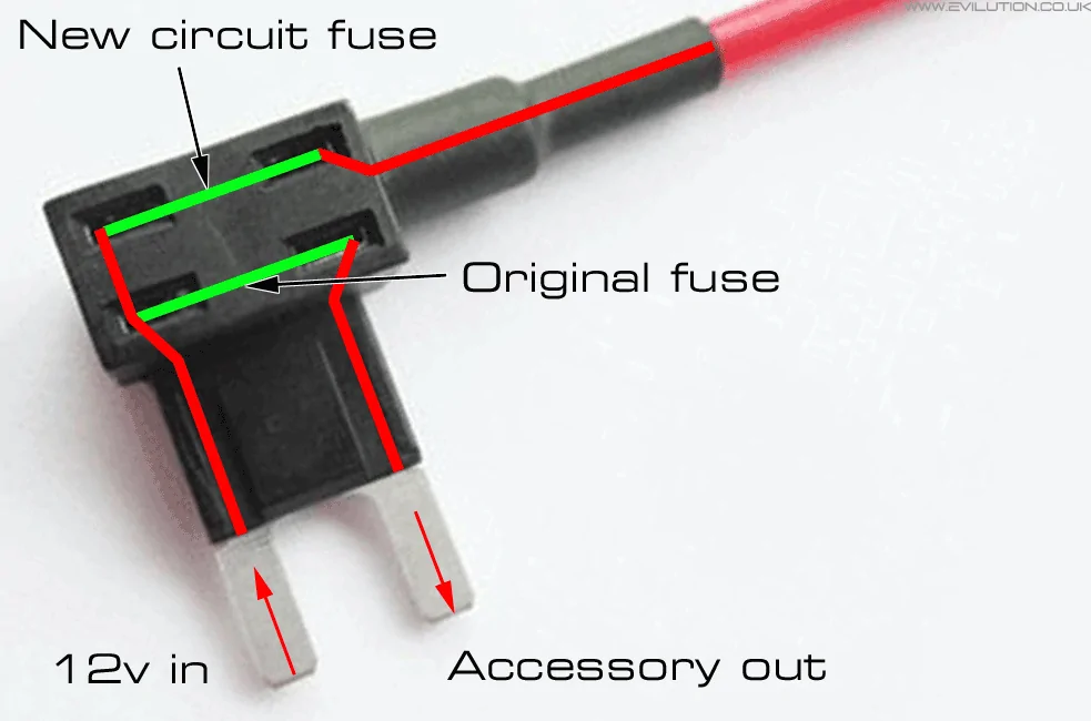

I FIGURED IT OUT!!!!!!!!!!!!!!
I feel dumb now. I tapped F57 for a signal to the RedArc because I needed a fuse that is only powered when the engine is running. I unplugged the tap, and now the heaters work. I don't know why the tap causes them to be inoperable. That should have been the first thing I did to troubleshoot. Dumb*ass...
Now to find another fuse to tap.
Hootbro
Apr 13, 2019
10,212
20,017
2025 Gladiator Sport
Are you using a fuse tap like pictured here? You have to have both fuses in to make it work for both the device you are powering and the circuit you are tapping into.
Jeep Gladiator Seat Heaters Not Working - Fuses are OK Fuse ta
HereWeGo
HereWeGo
Kenny
Jul 28, 2022
40
185
201
Fort Walton Beach FL
2021 Jeep Gladiator Rubicon
:headbang: :headbang: :headbang:
There was only one fuse in the tap. I can't believe I wired this entire rig by myself and pull a dumb mistake like that. Thank you!!
I originally used F52, but found out that when in ACC mode, the Redarc BCDC will go into charge mode and draw from the battery. I confirmed this with RedArc. They suggested using one that is powered only when engine is running, or at least when in ON position. When camping, and weather is bad, I'll sit in the cab to listen to the radio. Don't want to draw down my battery,
Thanks again for your (and everyone's) help. Problem solved.
