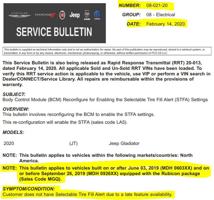

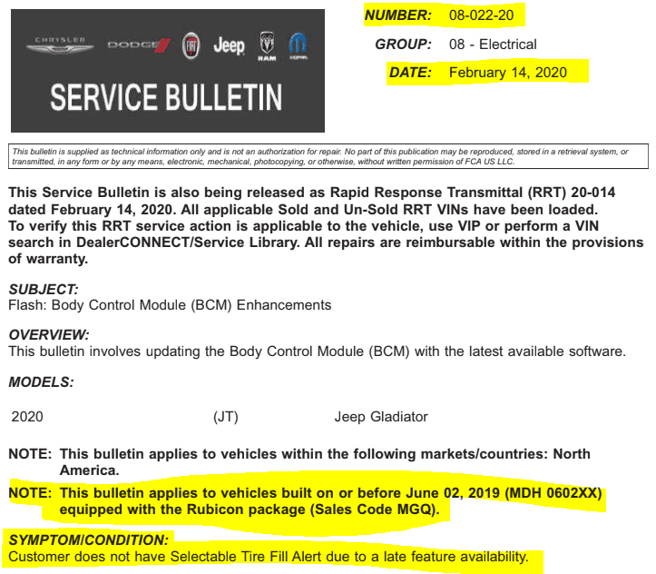

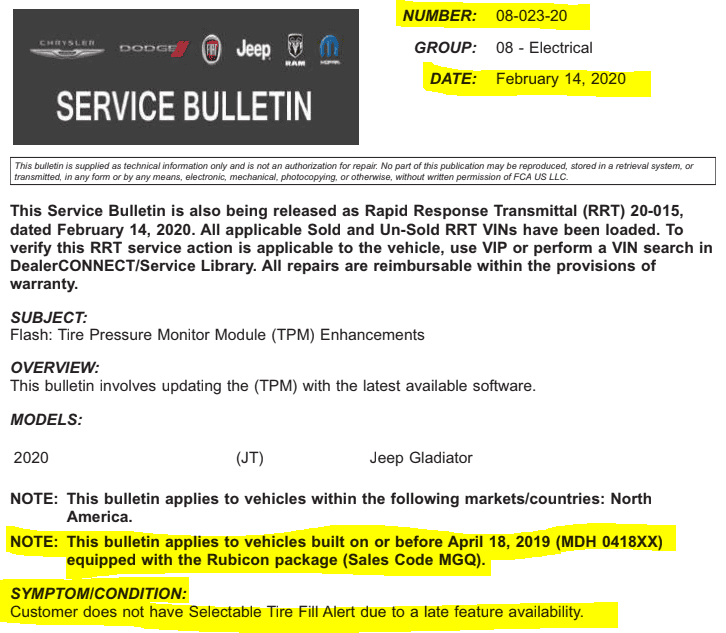

Hi Everyone,
Good news! A Technical Service Bulletin was released this morning regarding Selectable Tire Fill Alert.
To ensure this TSB applies, please visit the dealer to have a qualified technician review the details of the TSB and specifics of your vehicle. Once reviewed, the technician can then perform the repair procedure that best matches the symptoms and diagnosis of your vehicle.
There are three TSBs listed here. Each one depends on the build date of your vehicle. Please see below:
Jeep Gladiator Selectable Tire Fill Alert upload_2020-2-14_8-35-5
Jeep Gladiator Selectable Tire Fill Alert upload_2020-2-14_8-32-40
Jeep Gladiator Selectable Tire Fill Alert upload_2020-2-14_8-29-56
As always, please let us know if you are in need of additional support while in service.
