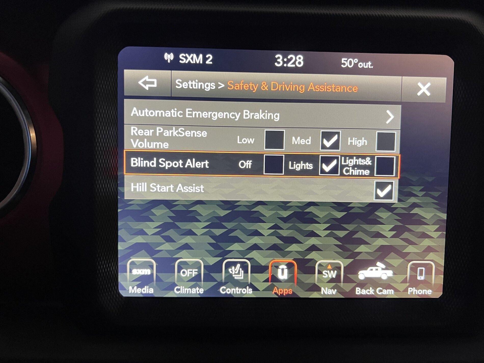

I have a JTRD Build date of 7-21 and I do not see that option even available within setting. So there must be some truth to what the original poster said. It is listed a “feature” in my manual and don’t see any price adjustment for not having it in the vehicle.
Jeep Gladiator Tire Fill Alert System Availability? CA59F8E3-0C59-4742-9DF4-491E5DA54238
