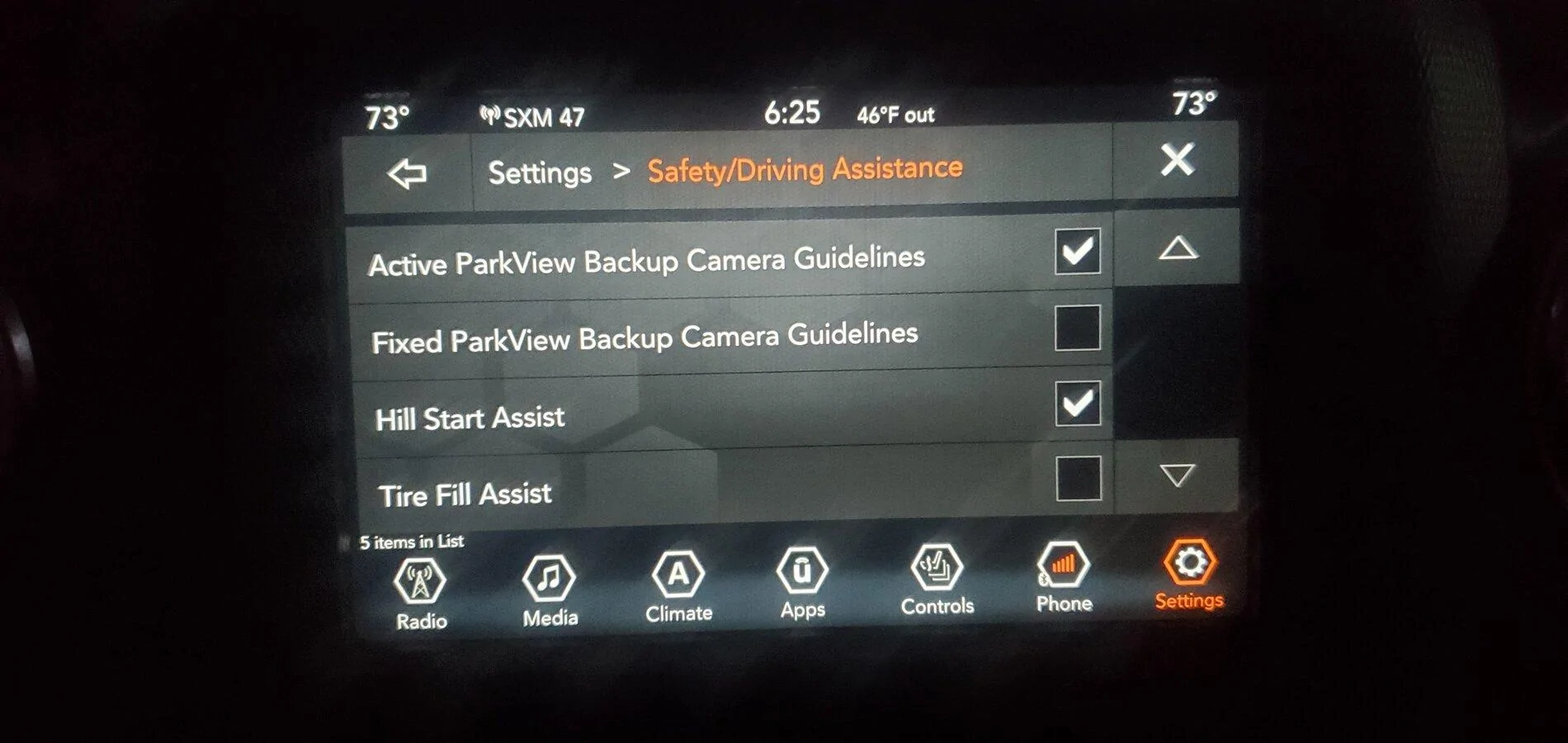

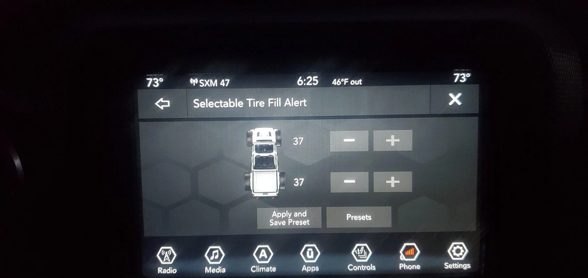

Ok, here's a simple "write up".
1) Set Jeep to run position, I tested it with the engine running but I do not think that matters, as long as you're in the run position. Make sure the brake is up (manual) or in park (automatic).
2)If the icon on the apps menu is grayed out, Enable Settings->safety/driving assistance-> tire fill alert

3) Find the icon on the main screen
4)Tap the icon, and set your pressures.
Jeep Gladiator Tire Fill Alert System Availability? 20211102_182537
If tapping the highlighted (not grayed out) icon doesn't work, then I'd see the dealership, because that should enter the pressure menu. Works for filling up and airing down.
That worked. Thanks!

Hill Start Assist is the only checkbox I have on that screen.
