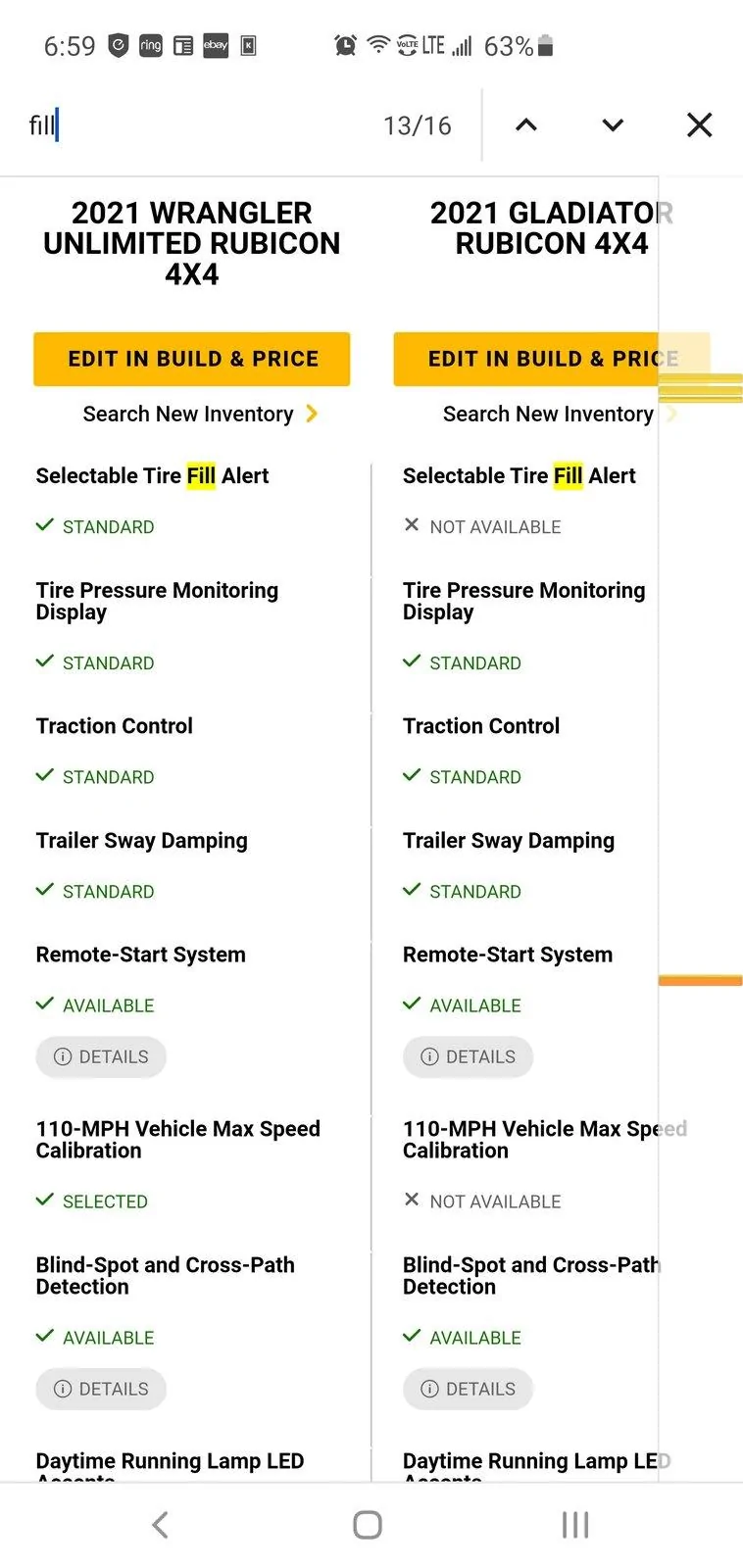

Yeah, notice that also with my recent Willys purchase that the SFTA has dropped off being available and it has the Continental TPM system.
It's not listed on jeep.com anymore for gladiators. It still is for Wranglers though. It says the off-road pages is gone too, but still on the Wrangler. Must be cutting some costs.
Jeep Gladiator Tire Fill Alert System Availability? Screenshot_20211115-185922_Chrome Beta

It's not listed on jeep.com anymore for gladiators. It still is for Wranglers though. It says the off-road pages is gone too. Must be cutting some costs.
Current order guide shows SFTA as standard equipment across the board but that is obviously not the case it seems.
SFTA is low hanging fruit to remove to get vehicles built and on dealer lots due to the chip shortage. Other brands are also de-contenting their options and features for the same reason.
Had SFTA on my 2020 Gladiator Rubicon but never really used it, so I am not miffed about not having it.

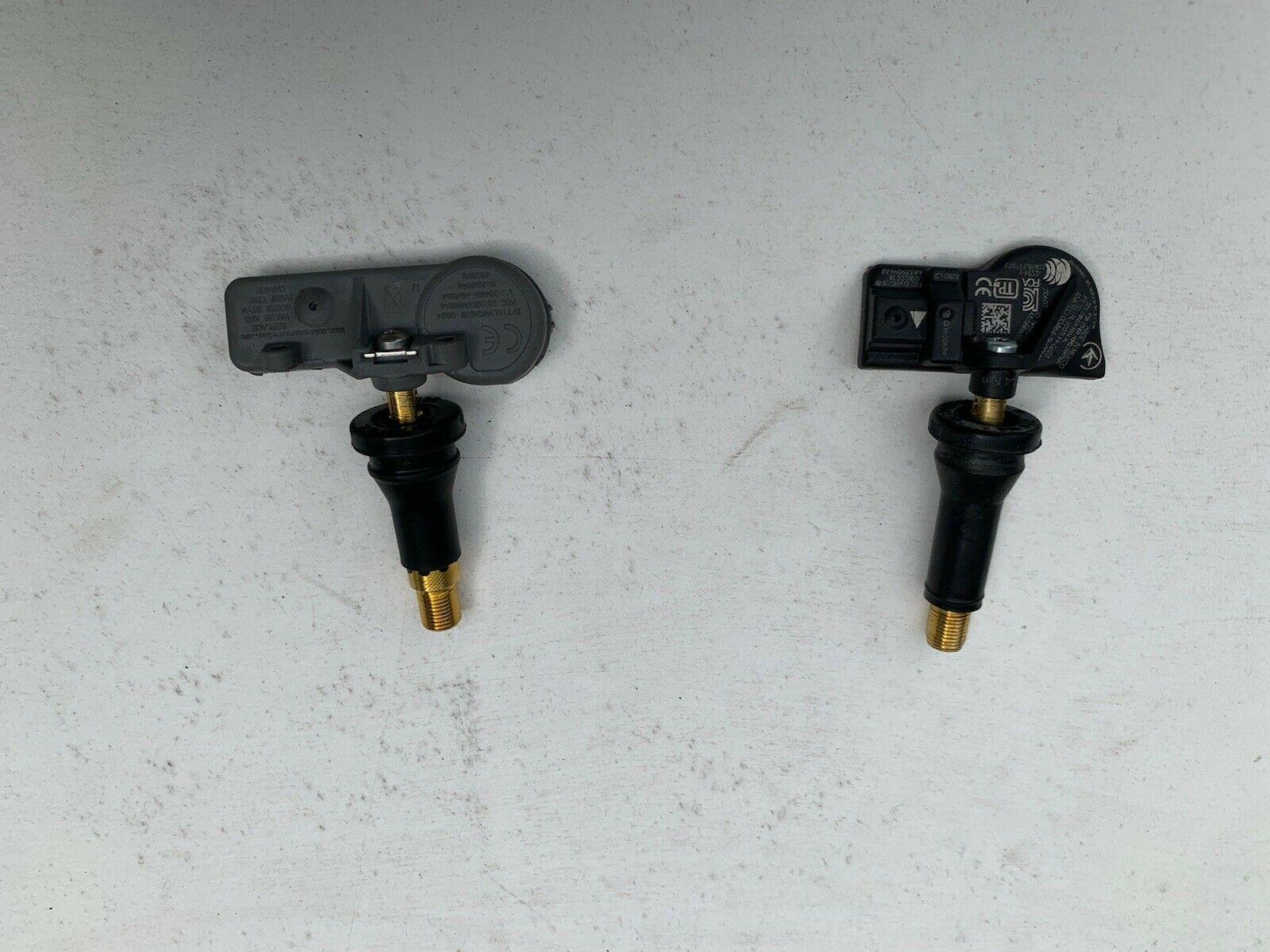

I am looking for a set of TPMS sensors for my aftermarket wheels.... I do not know if my Glad-Rubicon has the STFA function or not (10/2021 build I haven't taken delivery)... I know the TPMS sensors changed in 06/21... so I'm not sure which are the correct ones. I don't want to pay a premium for a set that has the SFTA if I don't need it, but I do want to keep the same type that comes on the OEM wheel. If you look at the pic, the sensor with the STFA function is on the left. Do you remember what the part# was and what yours looked like ? Part number I found is 68339096AB and I believe this is for the spare wheel without the STFA function (pictured on the right)
The one on the right is the continental sensor.
I have both sitting on my toolbox if someone wants them Ended up mis-ordering so I have both.
