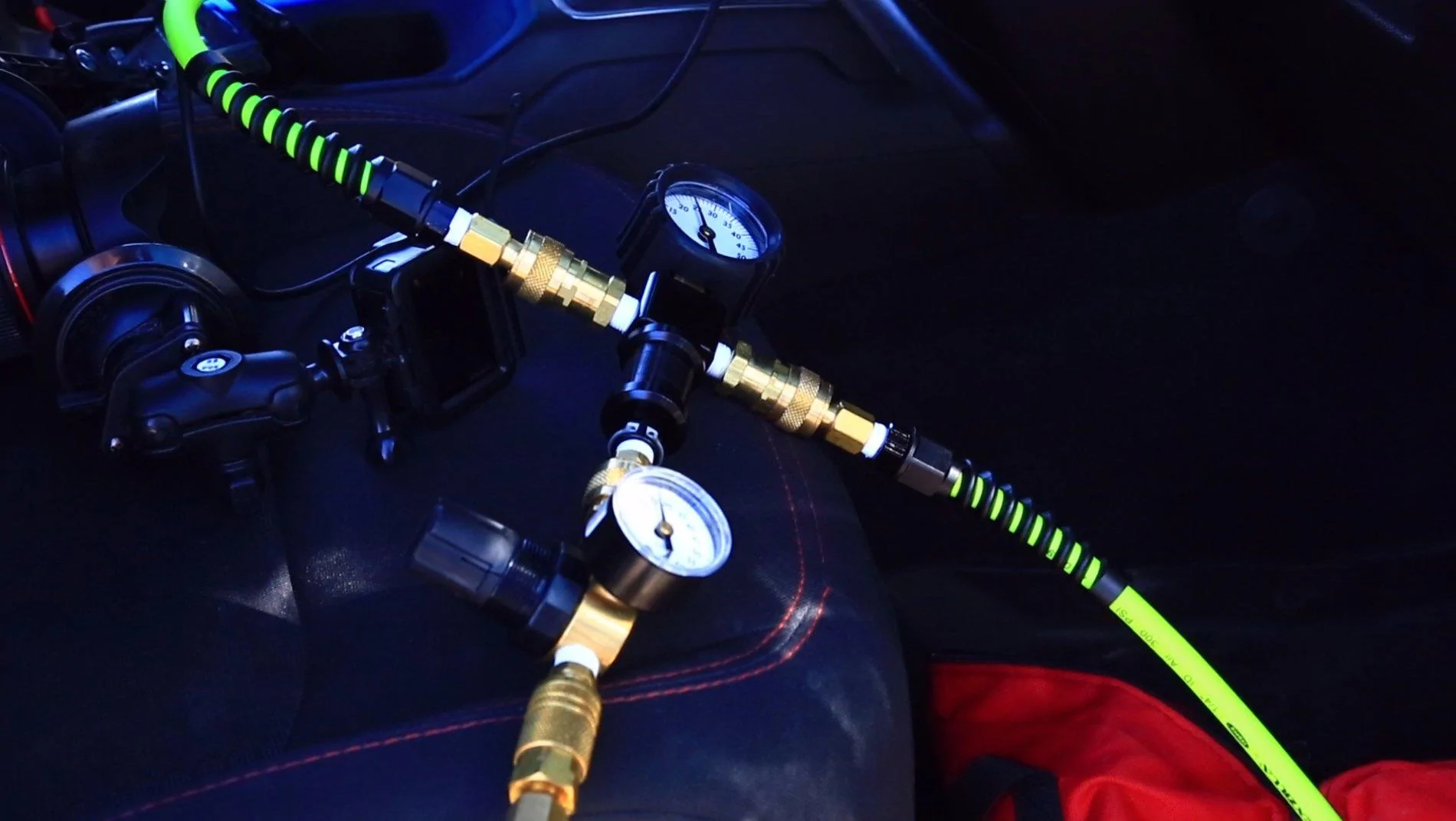

I was just reading my owner's manual about this yesterday. I hate the backbreaking work of airing up (I'm 70 years old, so give me a little slack), so a mechanical engineer friend of mine that I make occasional runs with fabricated me a Christmas gift using four lines to each of my tires from the ARB Twin Air Compressor under the passenger seat. Each line locks onto an air valve--so no having to squat, holding the air hose in place. Only problem is when it gets near the target pressure, it tends to cycle for a while as the expanding air cools down, lowering the pressure. With this, I can set a target pressure much higher than I need, and then just wait for the horn to honk at a pressure a couple pounds higher (because it will drop down once it cools). And, Jeep's limitation of one tire at a time is moot because the manifold on this device ensures all four tires are at the same pressure.

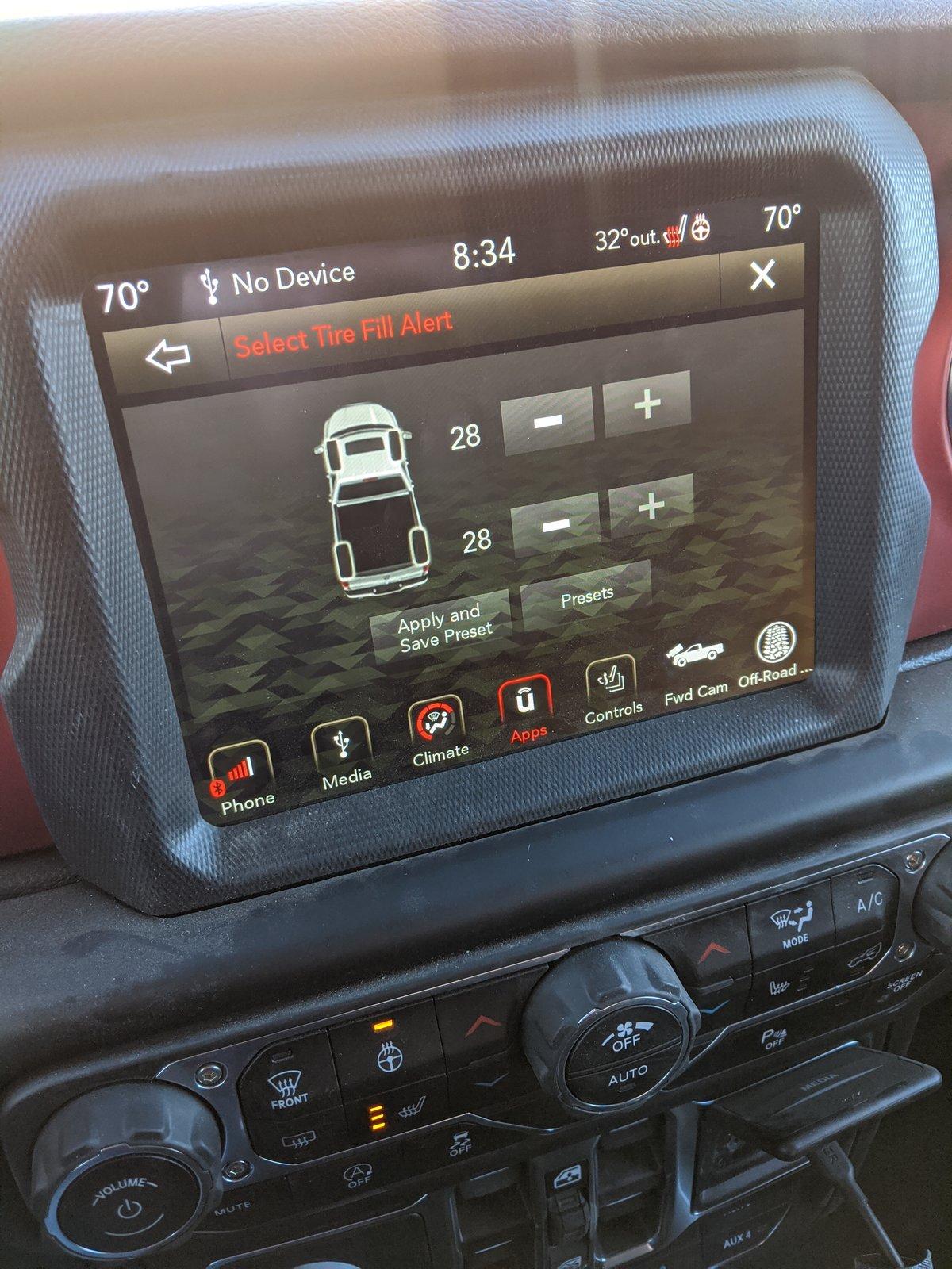

Well, just tried it out and had to enable STFA in settings (thanks to whomever posted that). Now the max PSI I can set is 28. Not much use for filling tires that low. I don't need to lower pressure since I use calibrated tire deflators. The stopped hissing works better than a horn, and all four at a time. Any idea why 28 PSI max? The Jeep video I watched showed 37 or such.

Mine goes to 37, try hitting preset and clear, then try hitting the plus again.

I did save a preset and then clear it. Made no change. Was wondering if the current tire pressure affects what you see. If you're not aired down, it assumes you will be. If you are aired down, it assumes you need higher pressures. IOW, maybe I need to let air out of a tire and see what happens.
EDIT: To be honest, I can make this work. Hook it all up, and when horn beeps, go over and pay attention to the tire pressure gauge (it monitors the manifold pressure, and all four tires will be the same). When it hits 32, turn off the compressor--which should stabilize at 30. That shouldn't take but a minute or so with that Twin Air on my 35s.

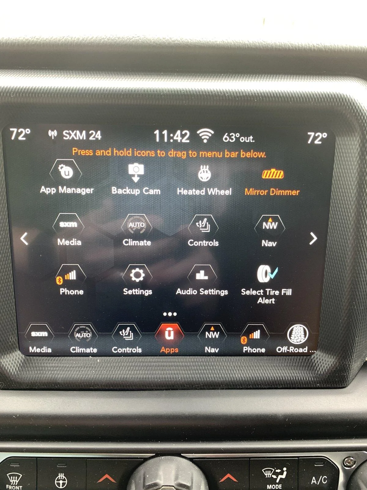

where is it in the settings menu. Got the app button (does not work) but nothing in menu even close to those words.
It’s under Safety and Driving Assistance.

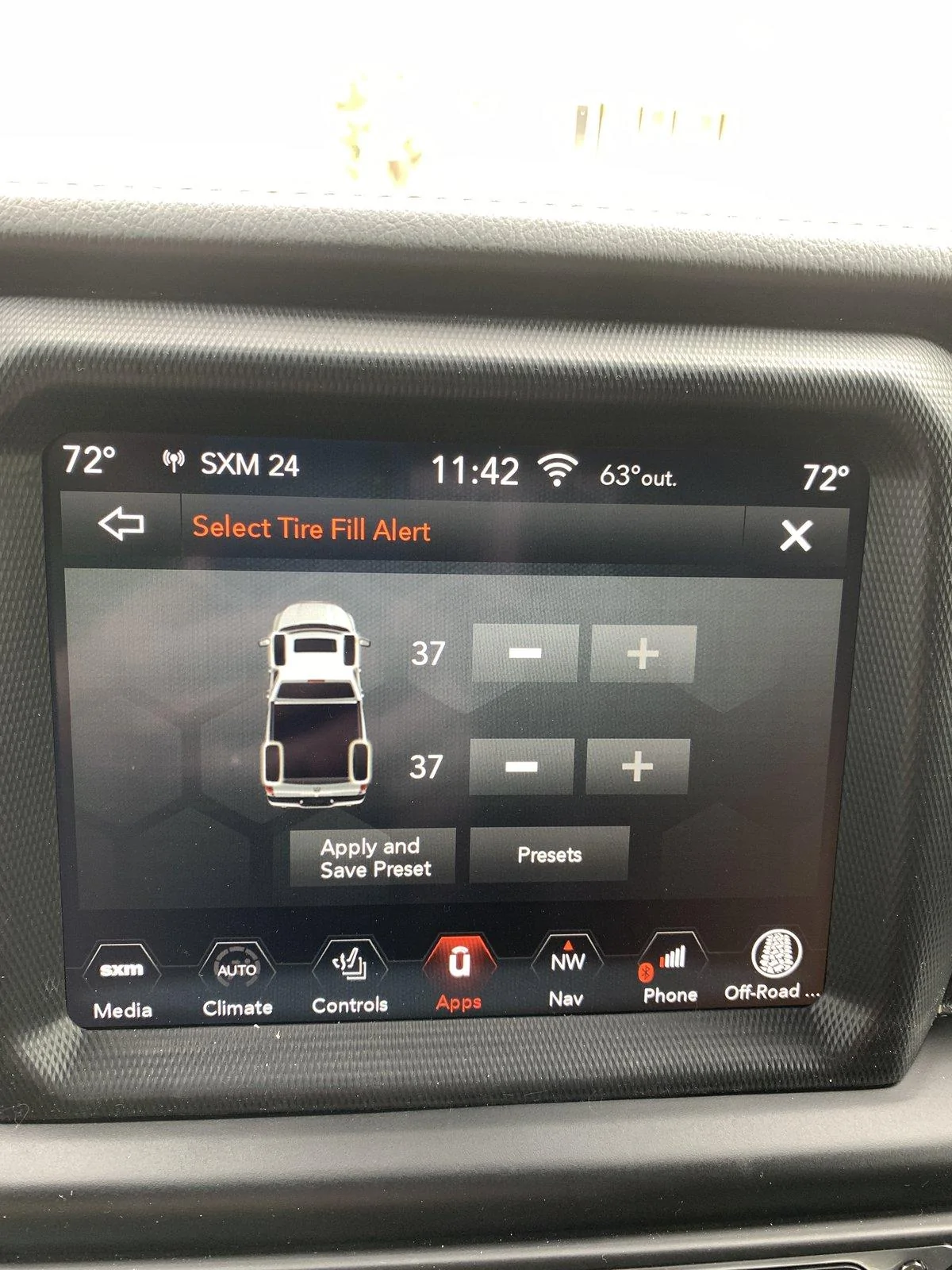

Resurrecting an old thread... is there any definitive process that works for this? I can activate the STFA app in settings and change the presets in the app, but how do you know it is working? I had mine overfilled and tried to air down to 37- but it went right on by and no lights flash or horn beeps. Are the flashers supposed to go only when it gets to the designated pressure, then the horn beeps? Do you need to have one preset set to lower numbers and one preset set to higher numbers, and it only alerts if you air down to the lower preset but will not alert if you air down to the higher presets? In other words - if the low preset is 30 and the high preset is 35, and actual pressure is 40... the alert will not sound when airing down when it gets to 35 but will sound when it gets to 30? Hope that makes sense...

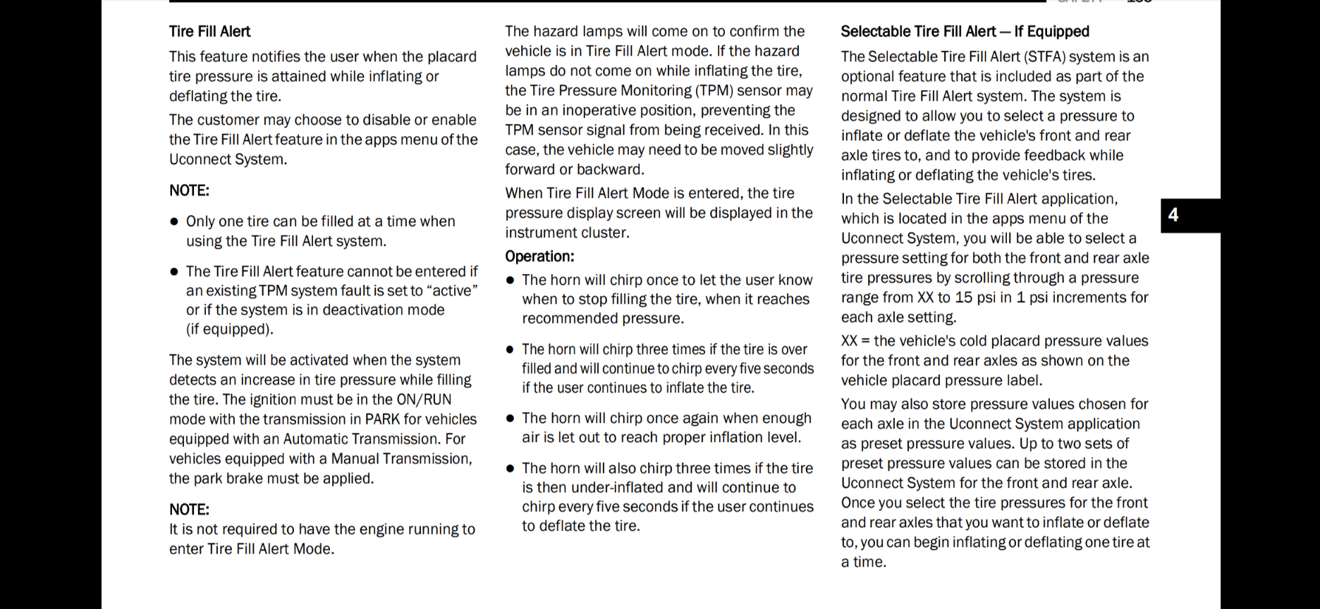

Maybe it'll be quicker to look at your manual...
