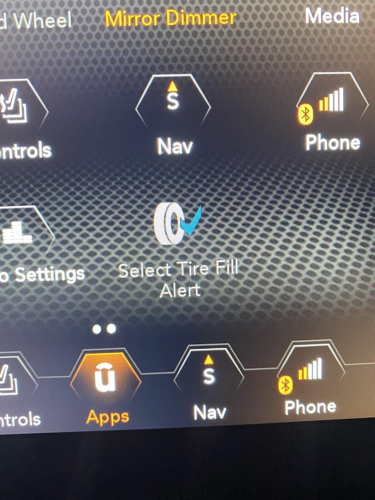

Can anyone tell if this non-responsive icon means my 2021 Gladiator does not have the Tire Fill Alert functionality? I didnt see a reference in the owner’s manual. Thank you!

That's what I was complaining about above. I have the same issue.
I can't remember, because it's been a while since I used it. But I think you have to have the vehicle in run mode, or maybe accessory mode in order to remove the grey. It doesn't work when it's running. I remember there was a trick to it, but it does work.
From what I have discovered, you have to enable it every time you are stopped and at an air pump.

Tire Fill Alert
This feature notifies the user when the placard
tire pressure is attained while inflating or
deflating the tire.
The customer may choose to disable or enable
the Tire Fill Alert feature in the apps menu of the
Uconnect system.
NOTE:
 Only one tire can be filled at a time when
using the Tire Fill Alert system.
 The Tire Fill Alert feature cannot be entered if
an existing TPMS system fault is set to
“active” or if the system is in deactivation
mode (if equipped).
The system will be activated when the system
detects an increase in tire pressure while filling
the tire. The ignition must be in the ON/RUN
mode with the transmission in PARK for
vehicles equipped with an Automatic
Transmission. For vehicles equipped with a
Manual Transmission, the park brake must be
applied
I don’t know how to “choose to disable or enable the Tire Fill Alert feature in the apps menu of the Uconnect system” since touching it didn’t seem to make a difference
I guess the good news is that i can’t fill mote than one tire at a time. So at least I’m doing that right.
