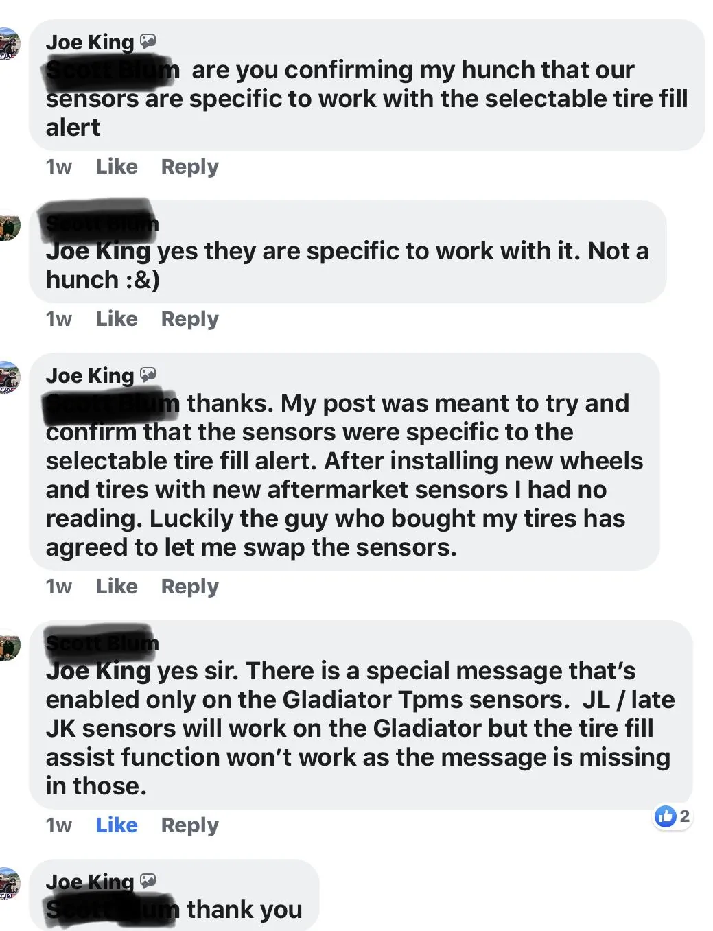

Has to be Gladiator TPMS sensors for the STFA to work, I experienced this first hand. Maybe the first person to do so. Our part number is 68464665AA...direct from a Jeep employee

This seems to indicate that there is no difference in Gladiator sensors, but the JL/JK sensors that work for regular TPMS duty may not work for STFA duty since they seem to have a different part number. I've got some aftermarket JL sensors in my new wheels, so hopefully I'll be able to report on this with a definitive answer once my truck arrives.

I spoke with the head of development for the Wrangler and Gladiator. All JT sensors work for STFA. No other sensors work for that
