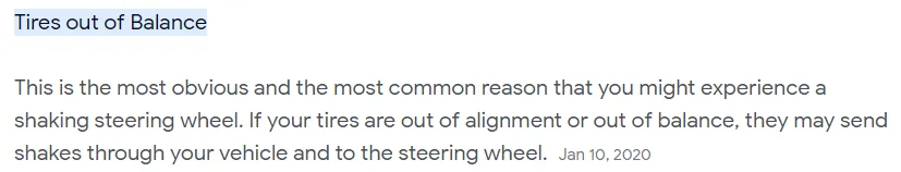

Jeep Gladiator Severe Shake Starts at 47 MPH 1691895151393
Describing tire issues -
Jeep Gladiator Severe Shake Starts at 47 MPH 1691895209463
I could refer to my factory training manuals and college books but gee, Google is SOOO much easier -
Jeep Gladiator Severe Shake Starts at 47 MPH 1691895253218
Talking about steering wheel shake, vehicle shake, etc -
Jeep Gladiator Severe Shake Starts at 47 MPH 1691895358605
A tire issue - belt issue, tire with lateral runout, out of balance, wheel issues, can all send vibrations through the whole vehicle typically 50 mph and above and even shake the steering wheel back and forth even if everything is unworn and tight.
