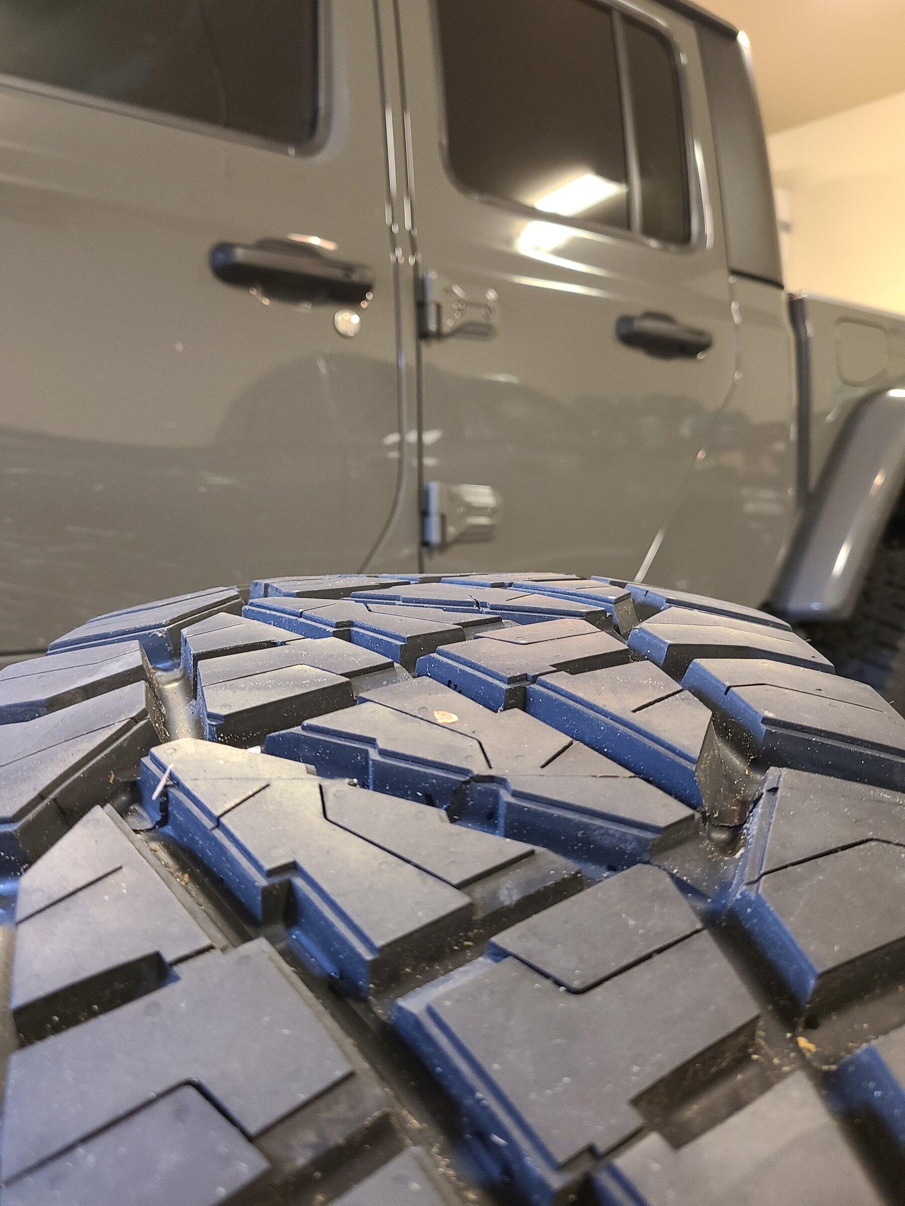

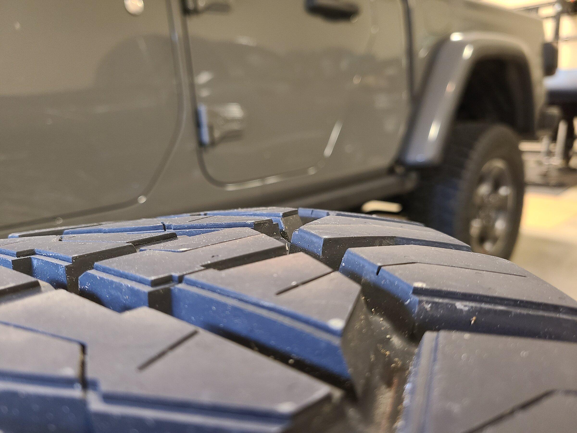

I spent a ton of time yesterday trying air changes of 2lbs from 26-38 and also changing the tire position on the truck with zero luck.
See the photos I took while I had them off. Those tread blocks just inside of the outside row stick way up. I would bet that is the tread feeling I get.
I also spun each tire and checked to make sure it was round. They were all perfect.
I did one more round of changing all tires to the stock ones and the issue immediately goes away. Smooth as silk with the Stock Falken's
Took the Jeep to Discount Tire this morning and let the manager drive it around for 20 mins. He definitely felt it was tread related. It is very specific on my Gladiator at 25-26 it vibrates, especially on a very smooth road surface. He said it is not normal and wouldn't accept them either. He is going to call me Monday but it looks like I will be getting a new set of 5 tires. His suggestion is to go with the Trail Grapplers so we don't end up in the same position if they are having a tread issue. These only have 150 miles on them. I really like the Ridge Grappler for a bit more road orientated tire but at this point I will take tire noise of a MT tread over this vibration any day.

Since I was having a similar issue, I decided to swap over to BFG KO2s. Vibration issue completely gone. It is 100% an issue with the ridge grappler tread blocks. Honestly, I think they just have a bad batch and sadly we were the recipients.

I agree, I hated to do it but I ordered Geolander G003 in 37 12.5 17. Be here early next week.
Hoping they work!
