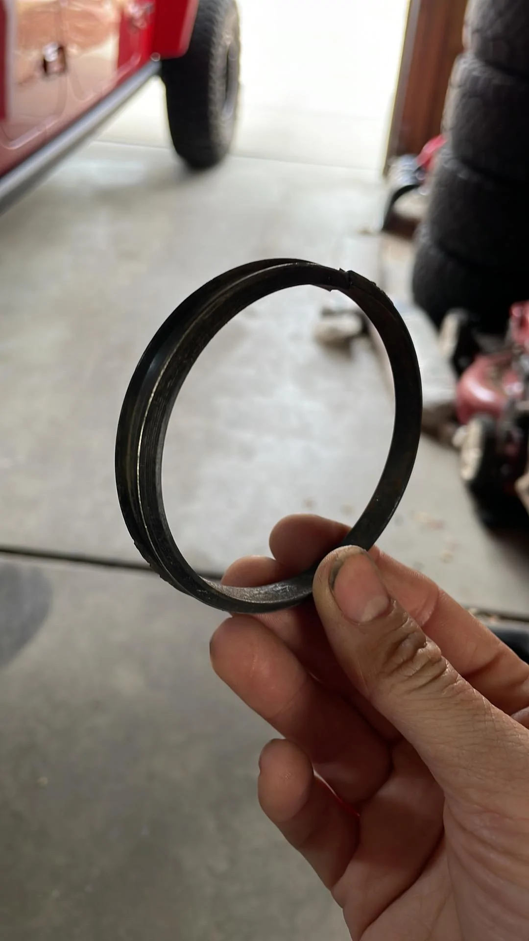

I did have an issue when DT changed my rims out. I had used hub centric rings for my previous wheels. They left one on and I jacked up my truck and took it off… no more vibrations on my 37’s…
Ps… make sure that they took off those silly lug retainers that they stick on next to the rotor… I’ve seen that make a vibration.
The AEV Borahs are hub centric for the JT, so should be no issue there. I have hub centric rings on my LJ though. There are a tight fit and sometimes they would stick inside the wheel. One newer tech called me saying I was missing one when I had them rotated. Asked him if he looked in the back of the wheel? Bingo.

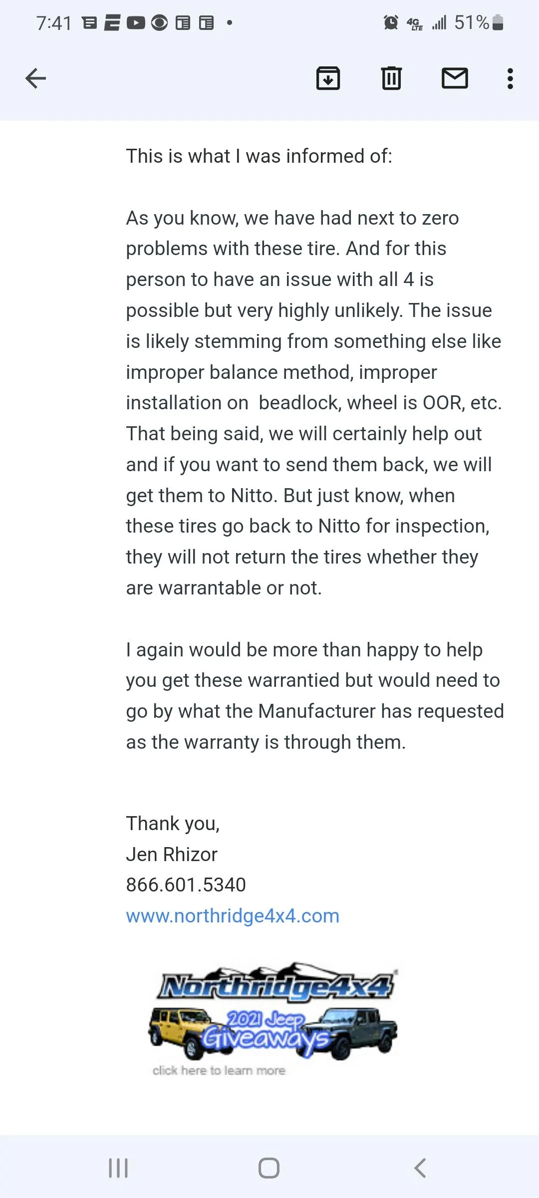

Been having same problem. Have had them rotated 3 times over the last 8,000 miles. Put wife's brand new Wildpeakes on and no vibration. Had a tire shop road force balance them. Said 1 tire was bad. Talked with Nitto. They talked to tire shop but since tire shop didn't have print out it doesn't matter to them. Nitto said I can send tires to them and they can check them out, but if they are "good" or bad they won't send them back to me. Trying to find another tire shop who can prove that they are bad if they are.

That's what they told me. Will not send back even if I pay shipping. Not sure about if I can find a shop that can prove it with a print out

Ok, if they are warrantable then they will replace them......all info is needed
