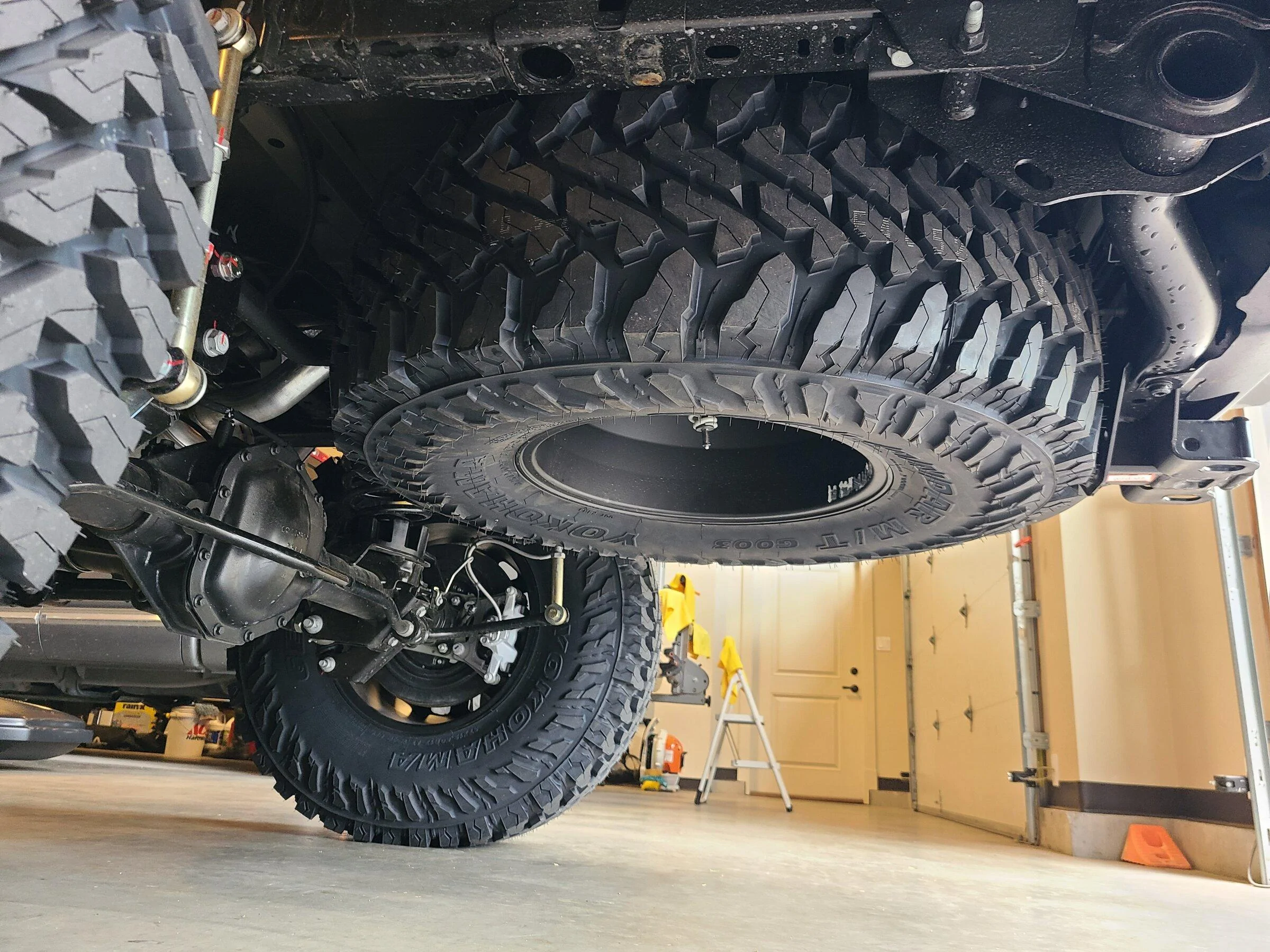

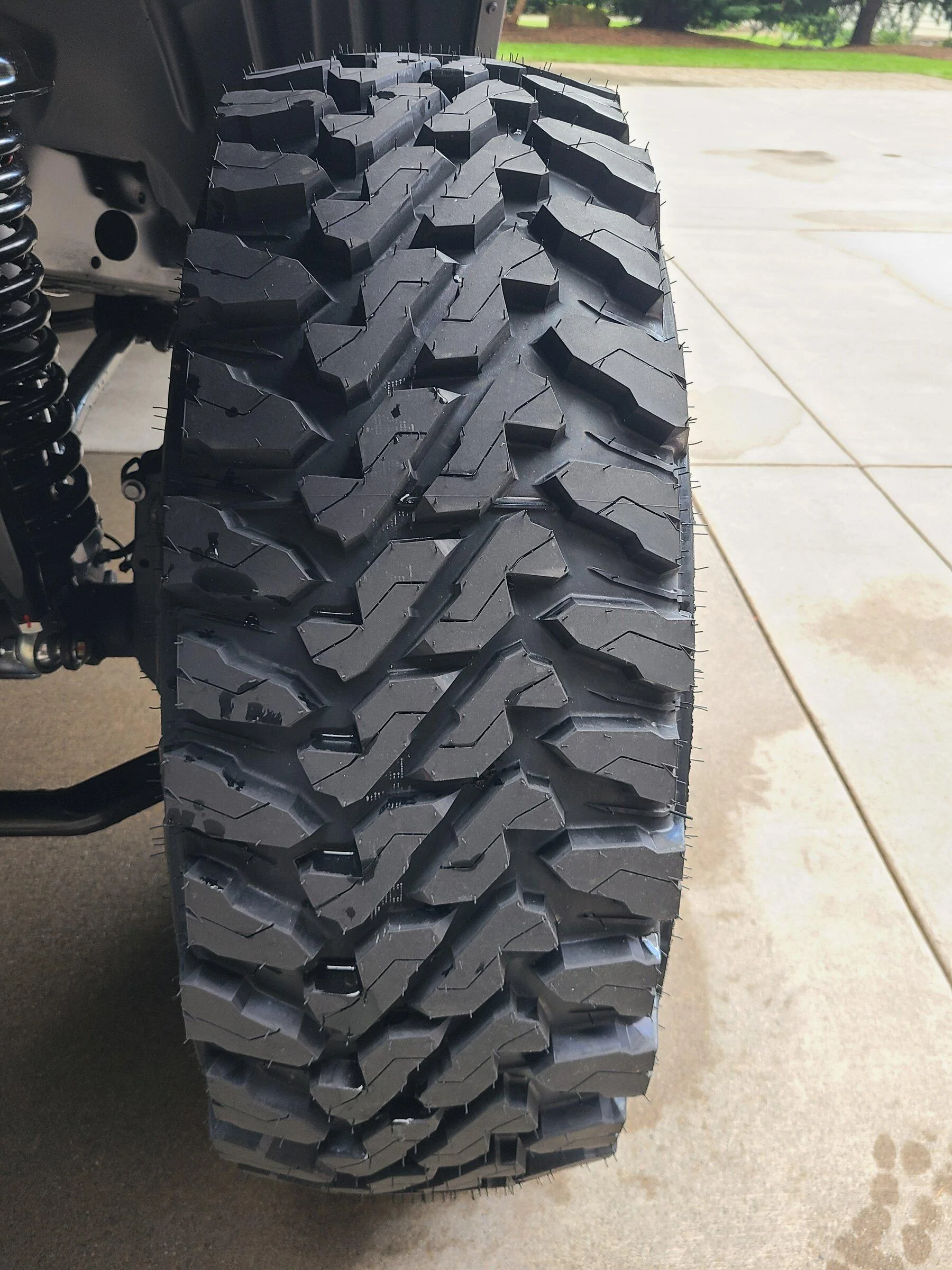

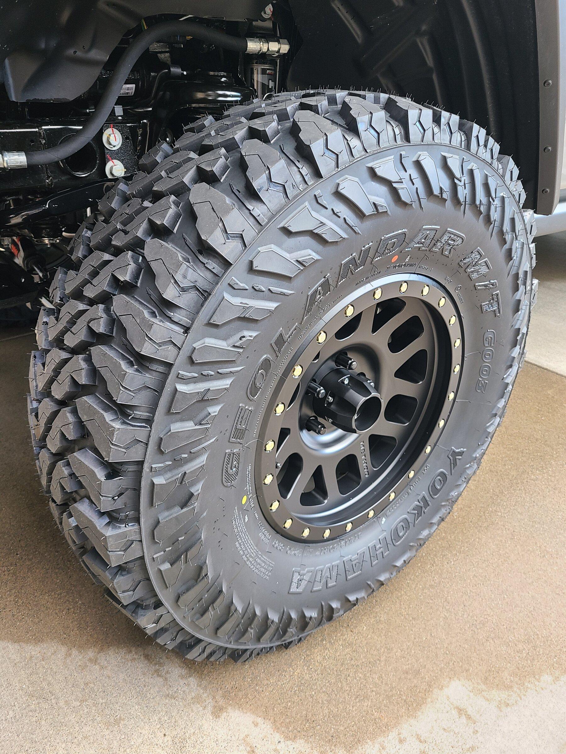

Quick update, Swapped the 37 Ridge Grapplers today for Geolander G003. vibration completely gone!
The real surprise is how smooth and quiet these new Yoko tires are! Crazy happy with the change. And the spare barely fits at 22 lbs of air... But it fits.
On to new things!

That spring bow in your first pic looks crazy... is that the camera lens?
