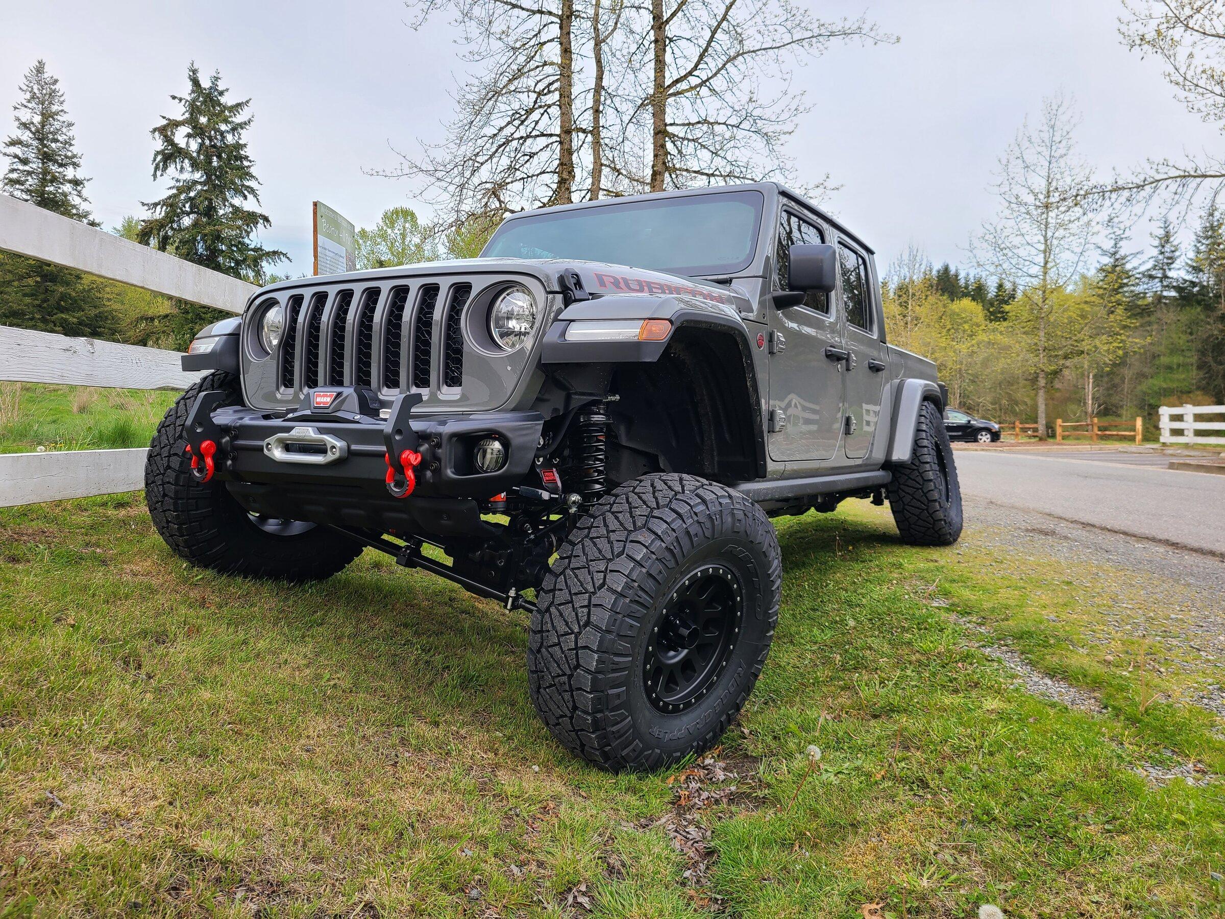

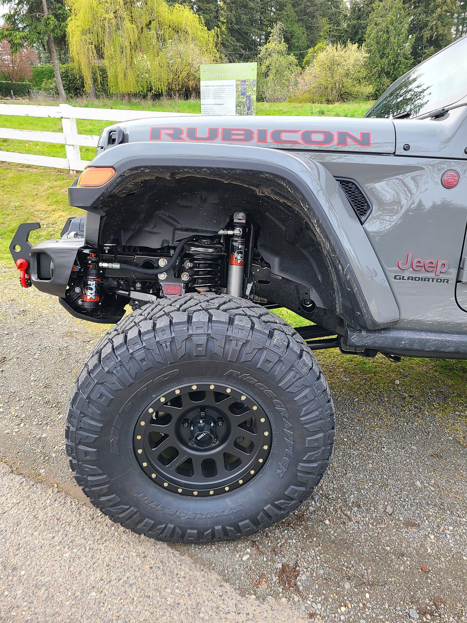

So I just built up a Rubicon with a RK 3 inch X-factor lift and 37 inch Nitto Ridge Grapplers. I am experiencing the exact same vibration as the OP. It happens like clockwork every time from 24-29 MPH going up in speed and going down in speed. It does not really ripple through the steering wheel It is sound and general vibration. It also happens in those ranges when put into neutral with no drivetrain input. This makes me believe that it is tread based and not a balance or driveline/train issue. It feels and sounds more like a resonance from the tread pattern. The tires are brand new and I do plan to go by Discount tire and have them check the balance again but I don't really feel like this is a balance issue as it doesn't happen at any other range of speed all the way up to 80 MPH. It is silky smooth at all other speeds. I put the factory tires back on and the vibration goes away so it is definitely Grappler related.
Anyone have any other finds or input on this?
Jeep Gladiator Vibration from 20-25 mph on 37s, common issue? 20220501_184534
My Dealership had the exact same conclusion. They said it was the thread of the tires being uneven.
