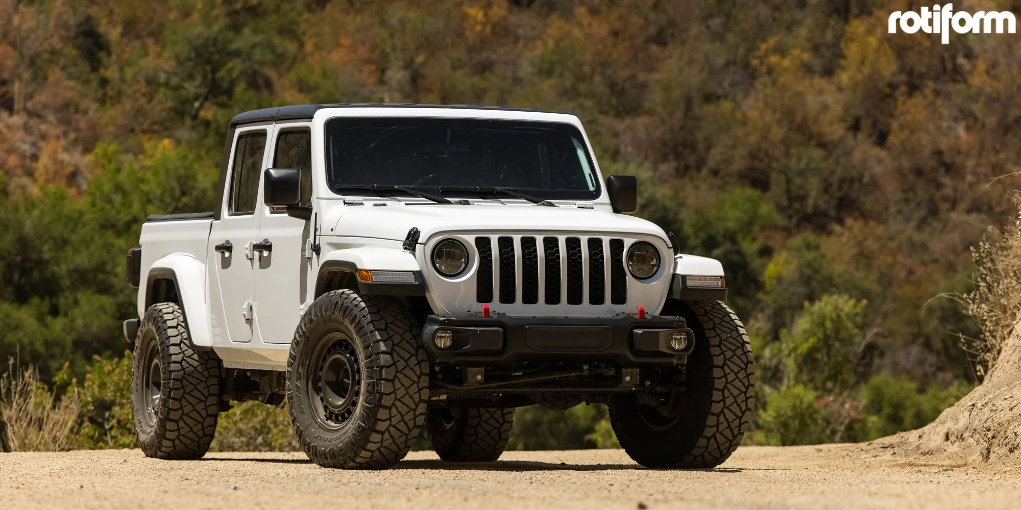

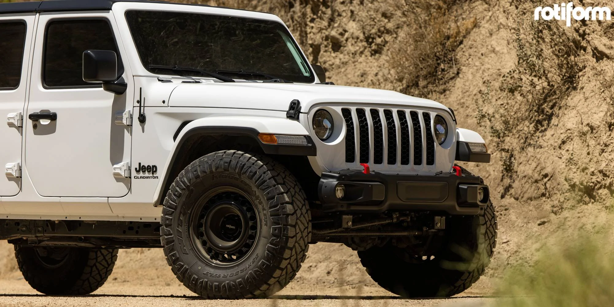

Check out Rotiform STL wheels. They have the steel wheel look, but are actually aluminum so you're saving quite a bit of weight compared to the steel wheels.
That looks great.
