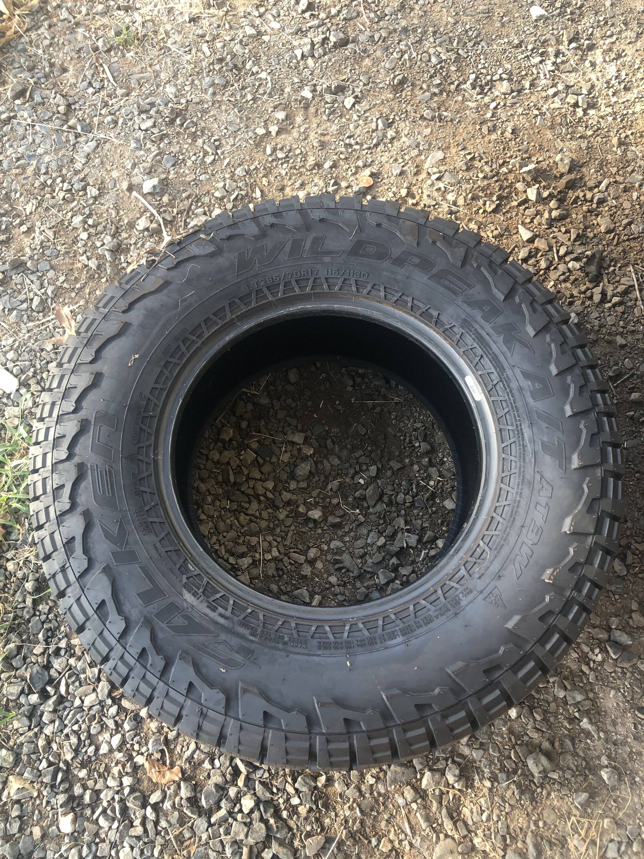

If you just need one tire let me know. I have a spare that has never been on ground except when I pulled it from under truck.

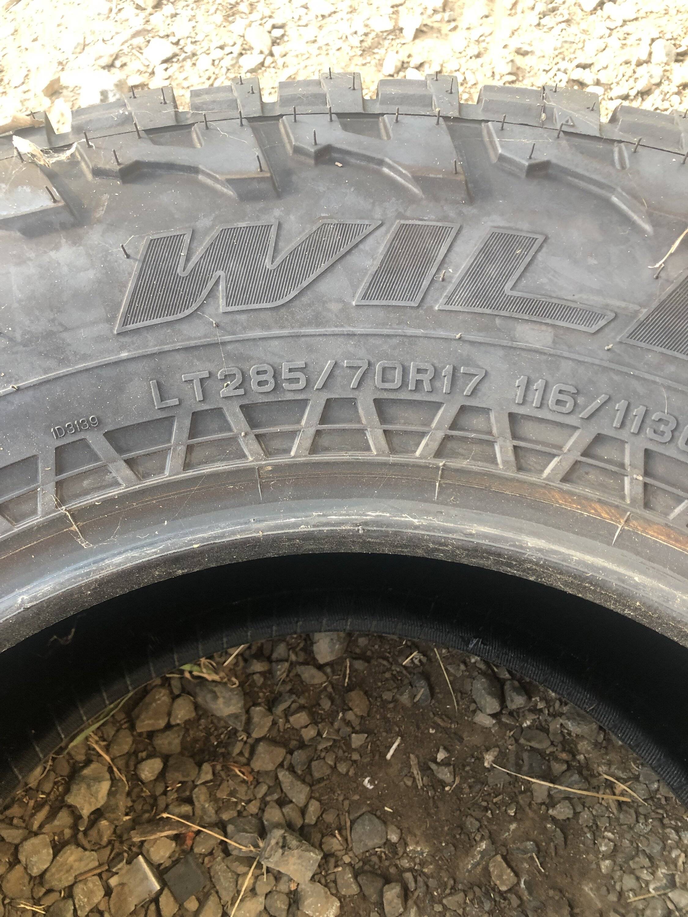

Same as the ones you have?
Jeep Gladiator Severe Shake Starts at 47 MPH IMG_7635
Jeep Gladiator Severe Shake Starts at 47 MPH IMG_7636

I sold 4 of them so this one is just hanging around if it will help you out.
