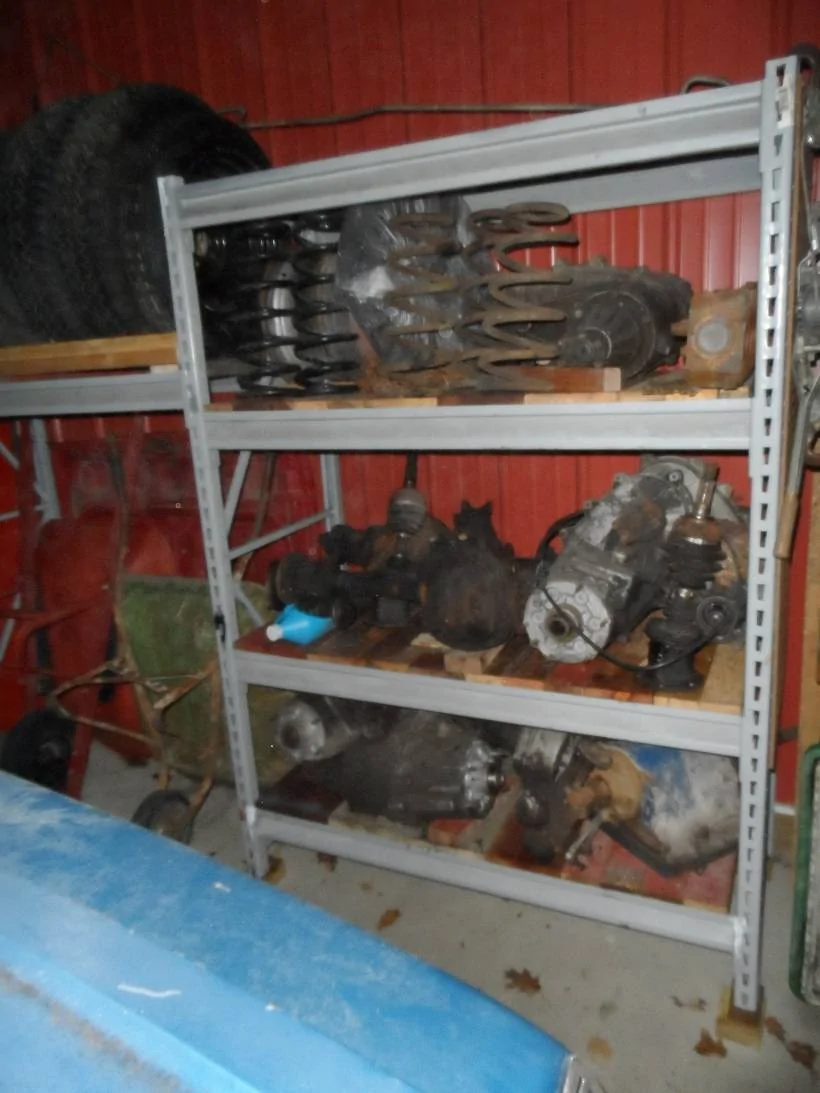

"Back in the day" words than mean I'm old, you'd have to get a front tire up on a curb and have two friends help you shift into 4H...............
What garbage did you drive with a transfer case that bad?
248
40,500
54,073
He might have had one of these - and I ended up with them for parts or repair.
Some of the Dodge trucks and Jeeps I worked on in the 70s and 80 were worn that bad, but people kept on driving them.
