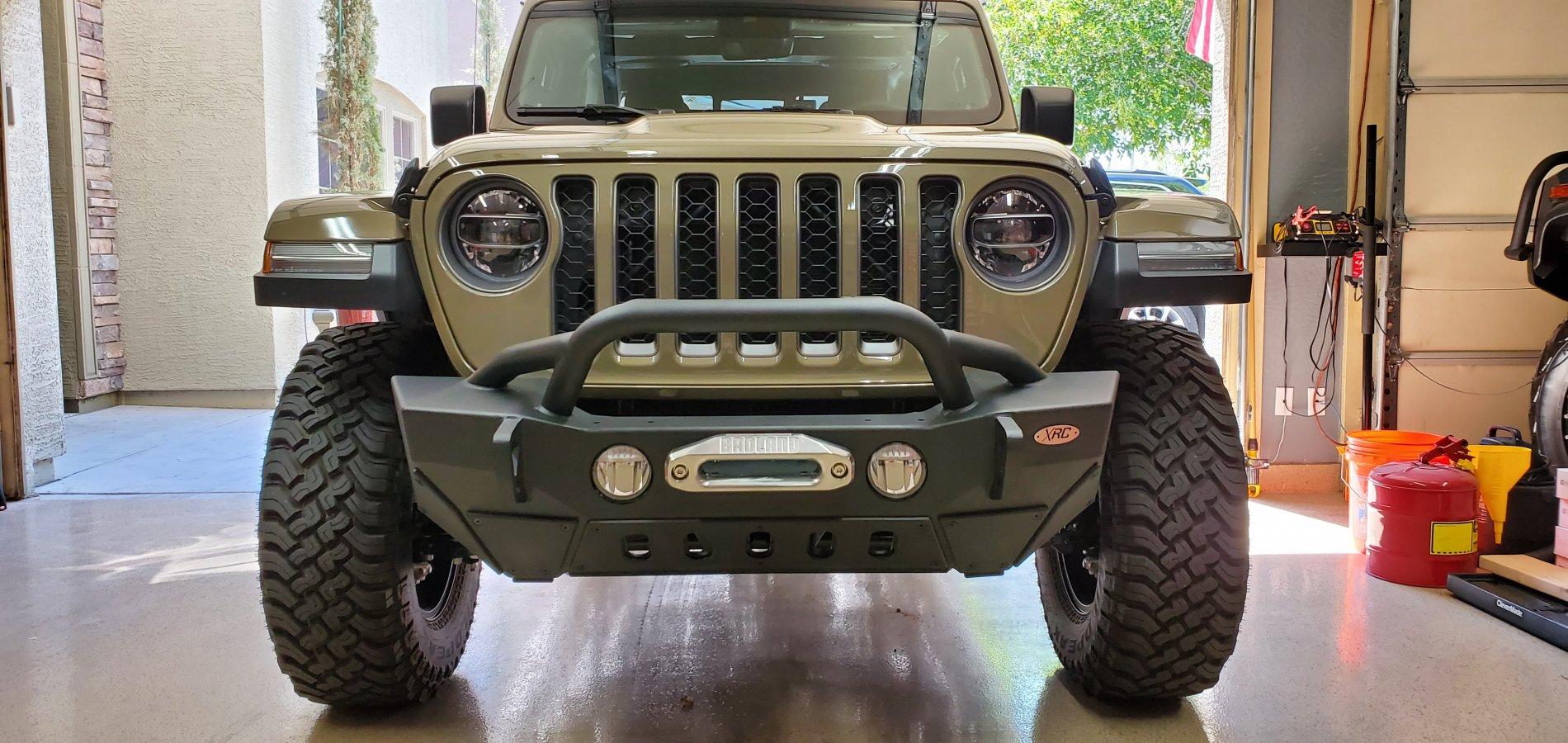

Smittybilt Gen 2 with winch and lights

I've been reading on the Wrangler forums about this bumper. Now I am torn between this and the Arcus. On the Wrangler forums people were stating they had to cut the frame rails to get the bumper installed. I read through the JT install instructions and they did not mention cutting anything. Did you have to cut anything during the install?

No sir, no cutting at all , slipped on smoothly and actually an easy install. Pretty heavy for one person, especially with the winch bolted on.

Thanks, I appreciate the reply! I think this bumper is a major contender against the Arcus!

Installed the Gen 2 Smittybilt today. I was slightly annoyed to find out the lower support brackets don't work with the Rubicons-only those with plastic skids. I called Smittybilt and they said, "there are not provisions for the Rubicons." They have asked me for a bunch of pictures. There needs to be a new bracket to tie into the steel skid mounts for these bumpers.

Just in case others have the same issue. I received an email back from Smittybilt. Here's what you do: I just completely finished mine. So the steel skid plate brackets, the ones with 2 bolts on each side have to be removed. Then you can gain access through the bottom of the lower frame portion. Apparently they include (which the instructions do not mention) bolts/nuts/washers to utilize the non-threaded hole. After doing that the lower brackets mounted perfect. Make sure to loosen the 6 frame bolts up top because the lower mounts will pull the bumper slightly up.
