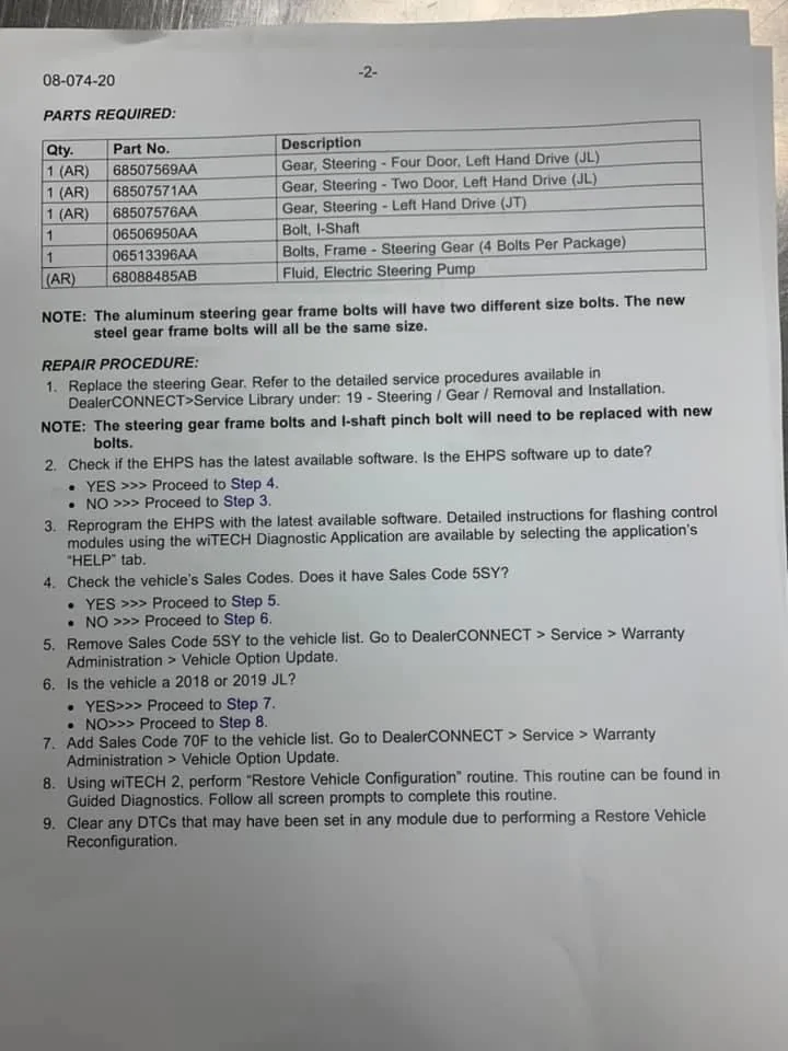

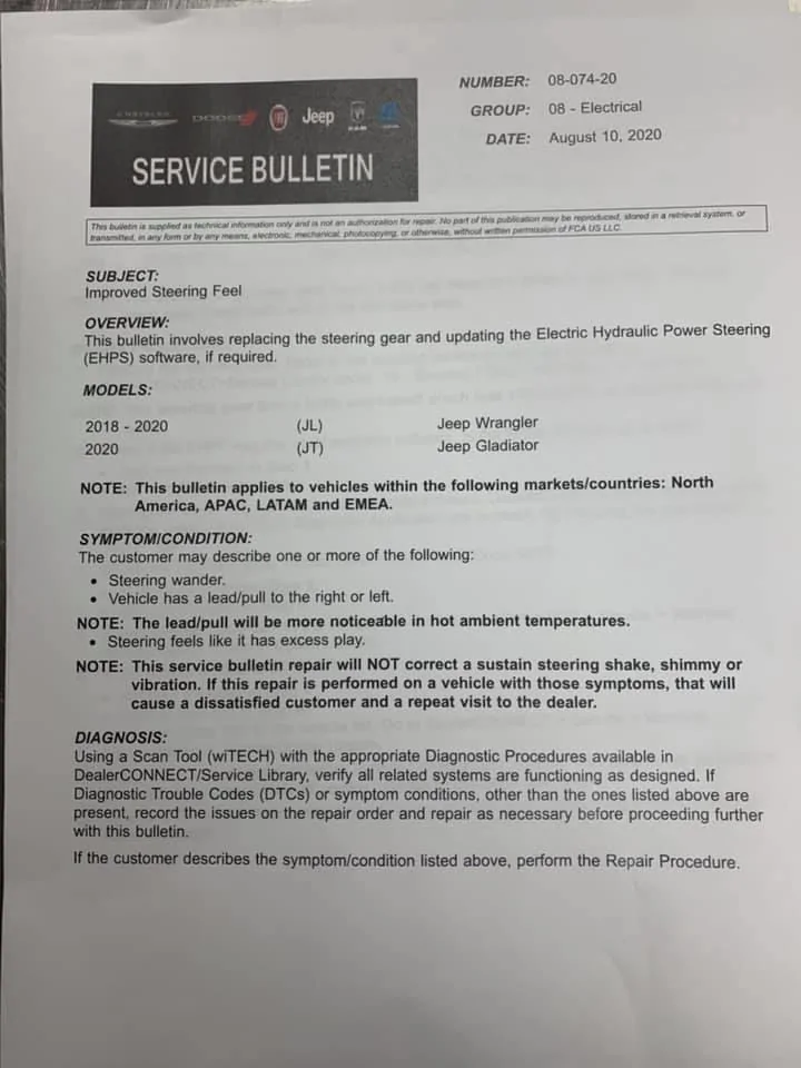

It's the steering box as stated above. Replace it under warranty as stated in the TSB.

I got the TSB done and definitely improved things. I wouldn’t say drastically, but things are noticeably better.
I had the TSB completed before the lift. I didnt want to to hear it from the dealer. Last night I put my stock stabilizer back on. Still pulls to the right... Not a drift as you'd expect, its a lane change as before. So I can rule out the stabilizer.

Sounds like the TSB for the steering box. Mine has this issue and I am getting the new box.
