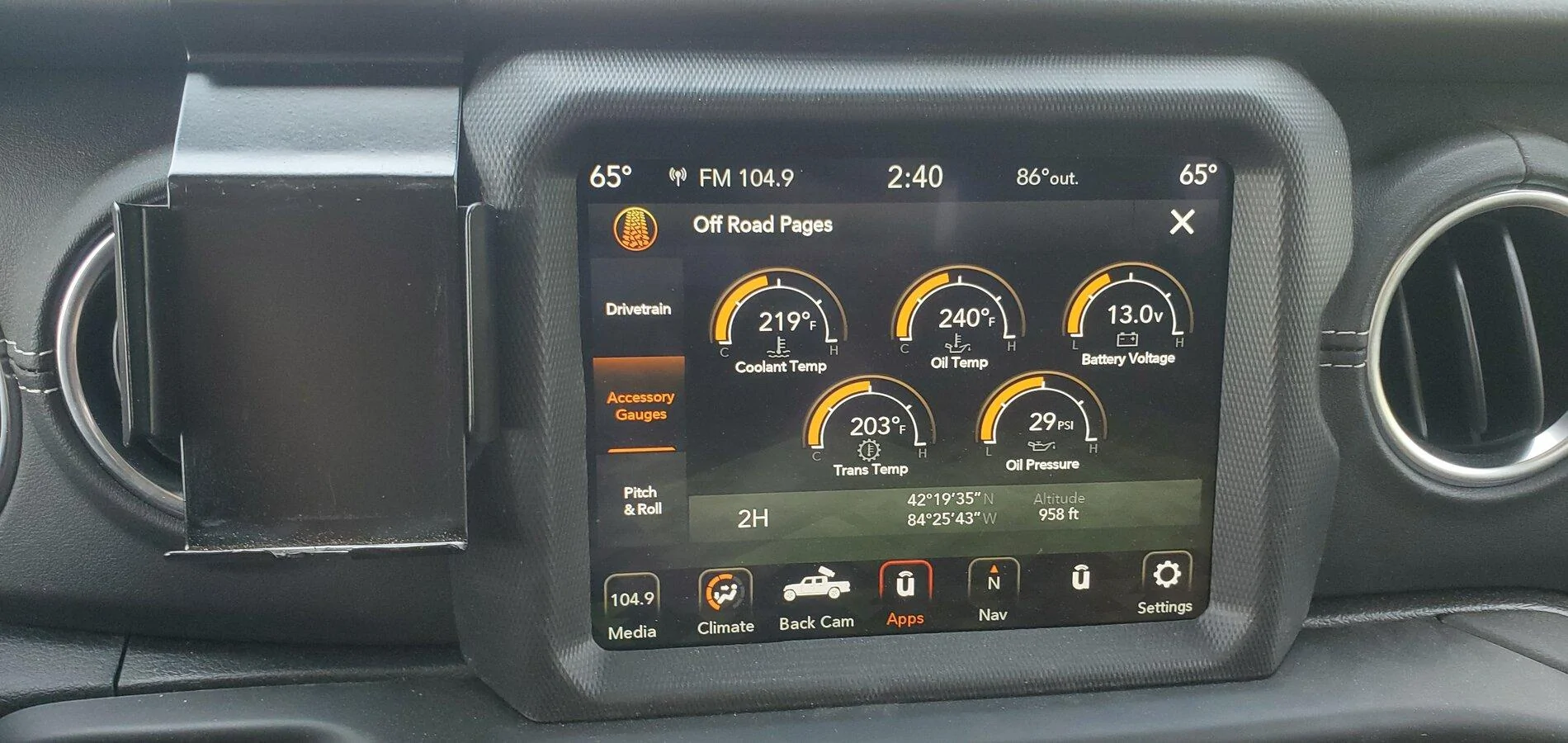

Im right there with you and your frustrations. I don't think I overheated but it threw a "service electronic throttle control" message and derated the shit out it. Doing 65mph in 88f on gentle hills. Once i cycled the key it would go back to full power but happened repeatedly. It would probably do 90mph if I asked it but any load over 60 seconds and it would fault. ?
Jeep Gladiator So disappointed in this Diesel platform; wish there was a return policy. 20210704_180556
Jeep Gladiator So disappointed in this Diesel platform; wish there was a return policy. 20210704_144023
