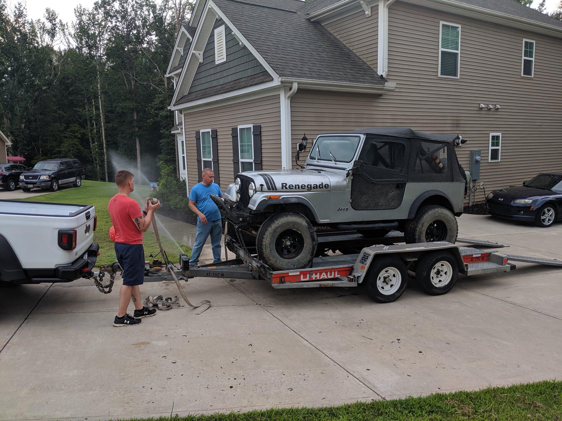

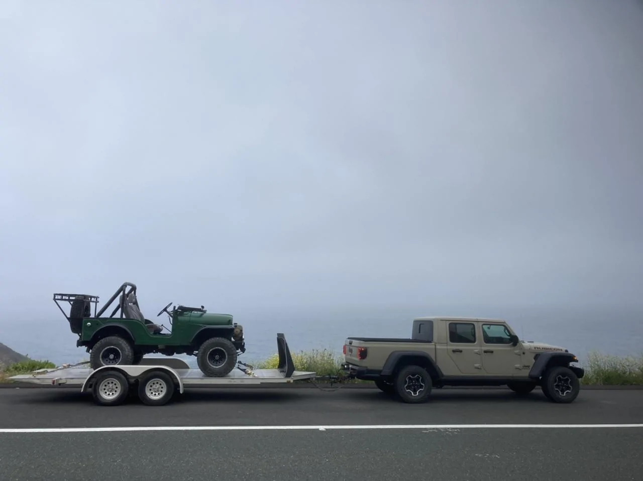

10500 GVW. I will update with the weight of the glad and empty trailer. I was surprised, the trailer is aluminum and I thought the 1956 CJ5 would be light. It towed from the pacific to Tahoe effortlessly and averaged 12.9 mpg. Oh, and that is 30lbs in the airlift bags.

Truck and empty trailer weighed 7340 lbs. The CJ5 is heavier than I guessed!

250 lb winch?? Maybe it was just the sheetmetal was thicker back then, didn't know you could fit 3200 lbs in a CJ5. Neat Jeep and wow that is a nice trailer! Oh and the Glad ain't bad either. Such a great paint color.

The CJ5 definitely has thicker sheet metal, and it also has a Matkins frame, which I am sure is pretty heavy. And an SM465 transmission, which is also a heavy chunk of steel and cast iron. The Warn 8274 has rope on it, to save weight, haha.

Tilt bed, right? 1500 pounds empty?
Beautiful looking combo - Jeep pulling trailer with classic Jeep.

Thank you. Yes it is a all aluminum tilt bed “Texas Roll Back” trailer that I borrow from a friend. He has it for some restored MG convertibles that are pretty low.

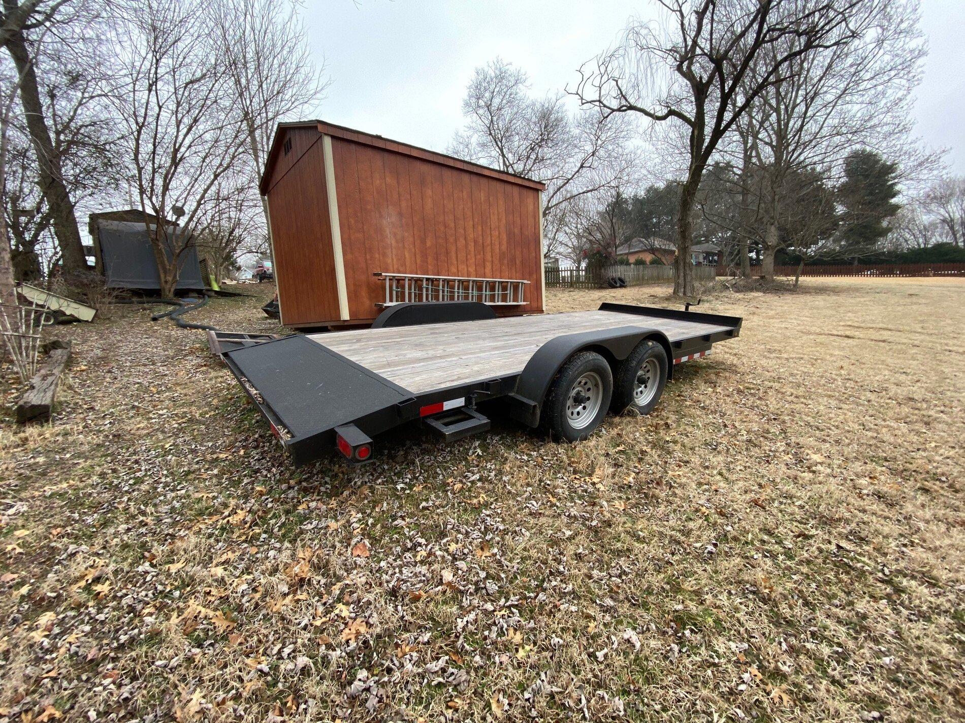

I've owned some trailers over the years, I liked my PJ 18' car hauler, but............ and the steel ramps killed my back lifting them around. And it weighed over 2,000 empty.
When truck shopping and talking the JT, my wife really wanted the overland ride and features. I explained that it only had a 6,000 pound tow rating and my trailer and car would get close to that. She said - so get a lighter trailer.
So I did - aluma 18' tilt bed. 1500 pounds without the tool box and spare, so I figure it's no more than 1600 with the 5 or 6 pound aluminum tool box and the spare tire attached.
So Aluma 18' trailer at 1600 pounds, car at 3200-3300, depending on which car, I'm 4800-4900 pounds. That's at least 1,000 under tow rating.
10% of that for tongue weight is say 480-500 pounds so I've taken less than half the payload for tongue weight.
I won't kill the tow rating numbers but the engine's ability is still on my mind with the Overland gearing. I may be shifting manually to keep it from hunting gears all the time on our hills.

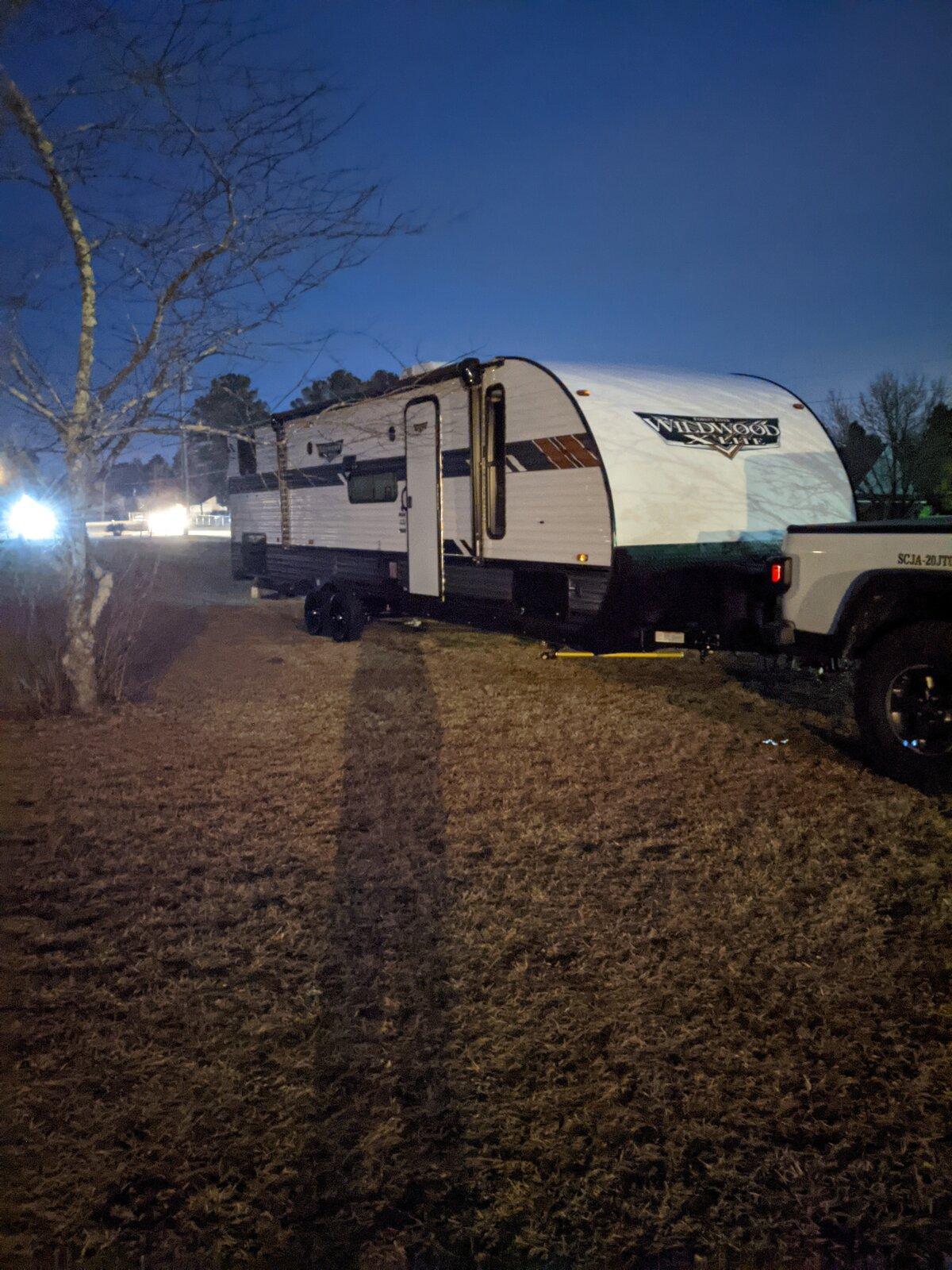

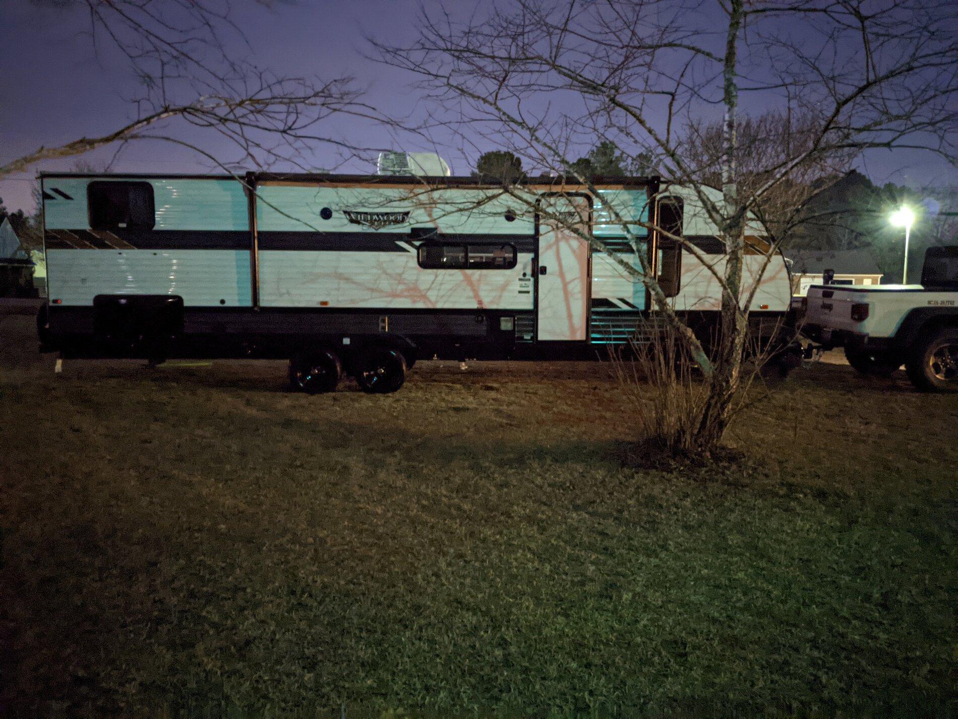

I have towed this over 1000 miles round trip so far and no issues what so ever. Before you ask, those are 37's on 5:13 gears with a pulsar superchip and tazer mini programer (though this has caused issues with the daytime running lights which power the turn cameras on the trailer). As for the car dolley, no issues towing that either.

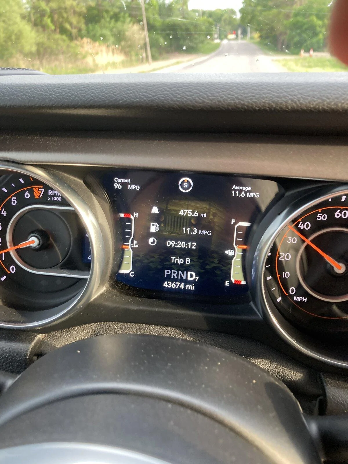

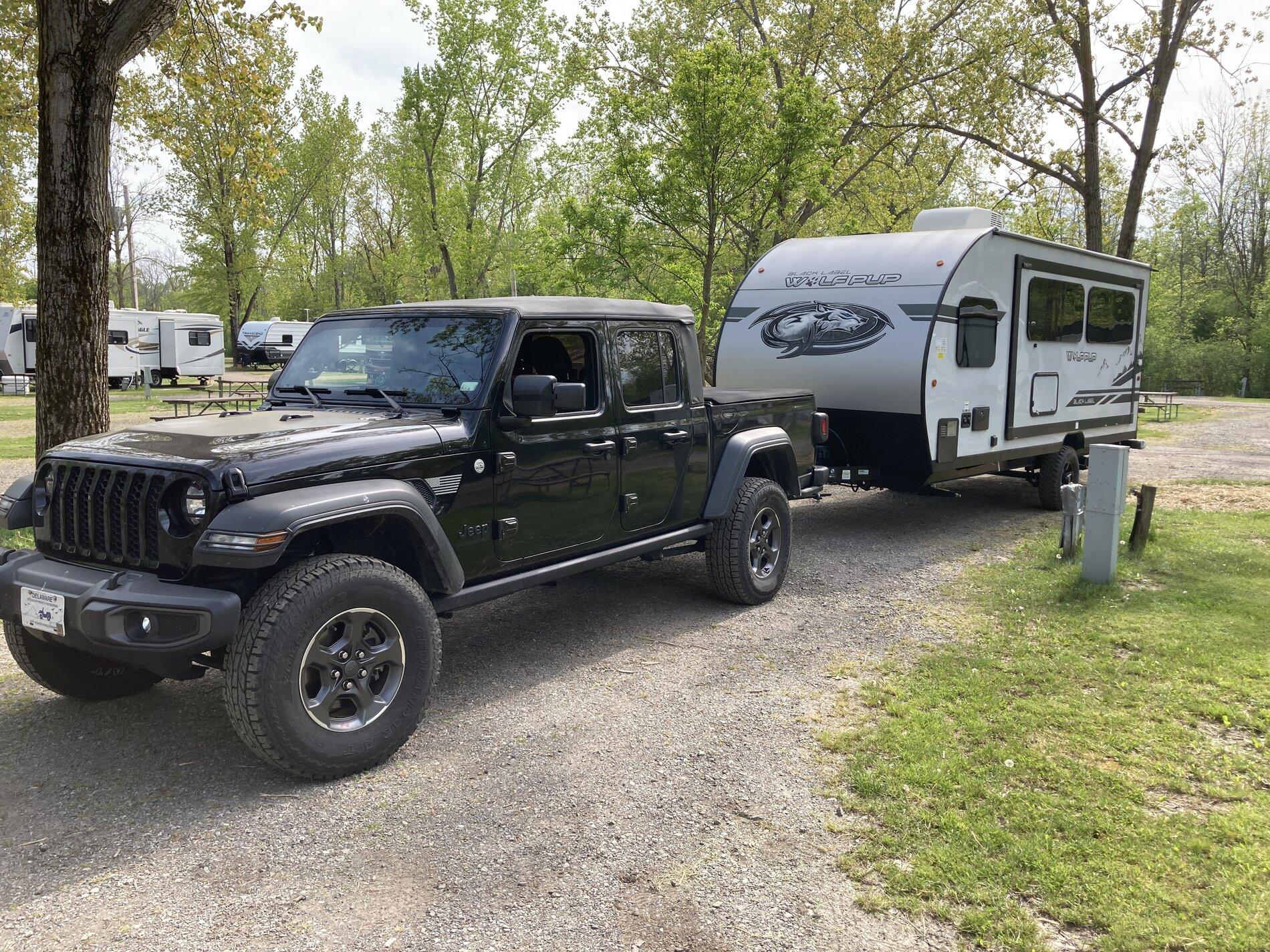

Took the wolf pup to Niagara falls. 475 miles one way. Averaged 11mpg! I was trialing this additive called fuelox and im feeling like it made a difference since a lot of folks seem to fet lower mpg..I went through mountain passes on my way north from delaware to upstate new york. Even then I was getting 9 while hanging out in 4th gear for some inclines. In addition to the fuelox i had my airlift bags inflated to 40psi and they made a world of difference in the ride quality.

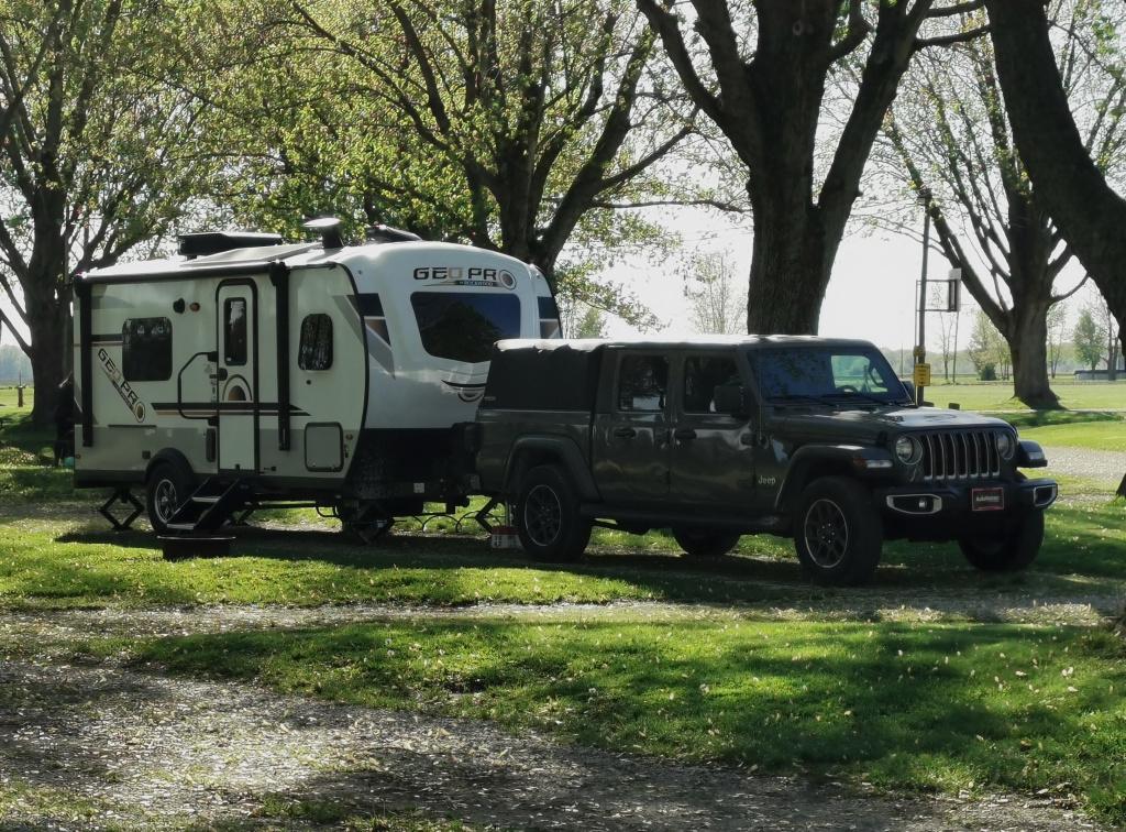

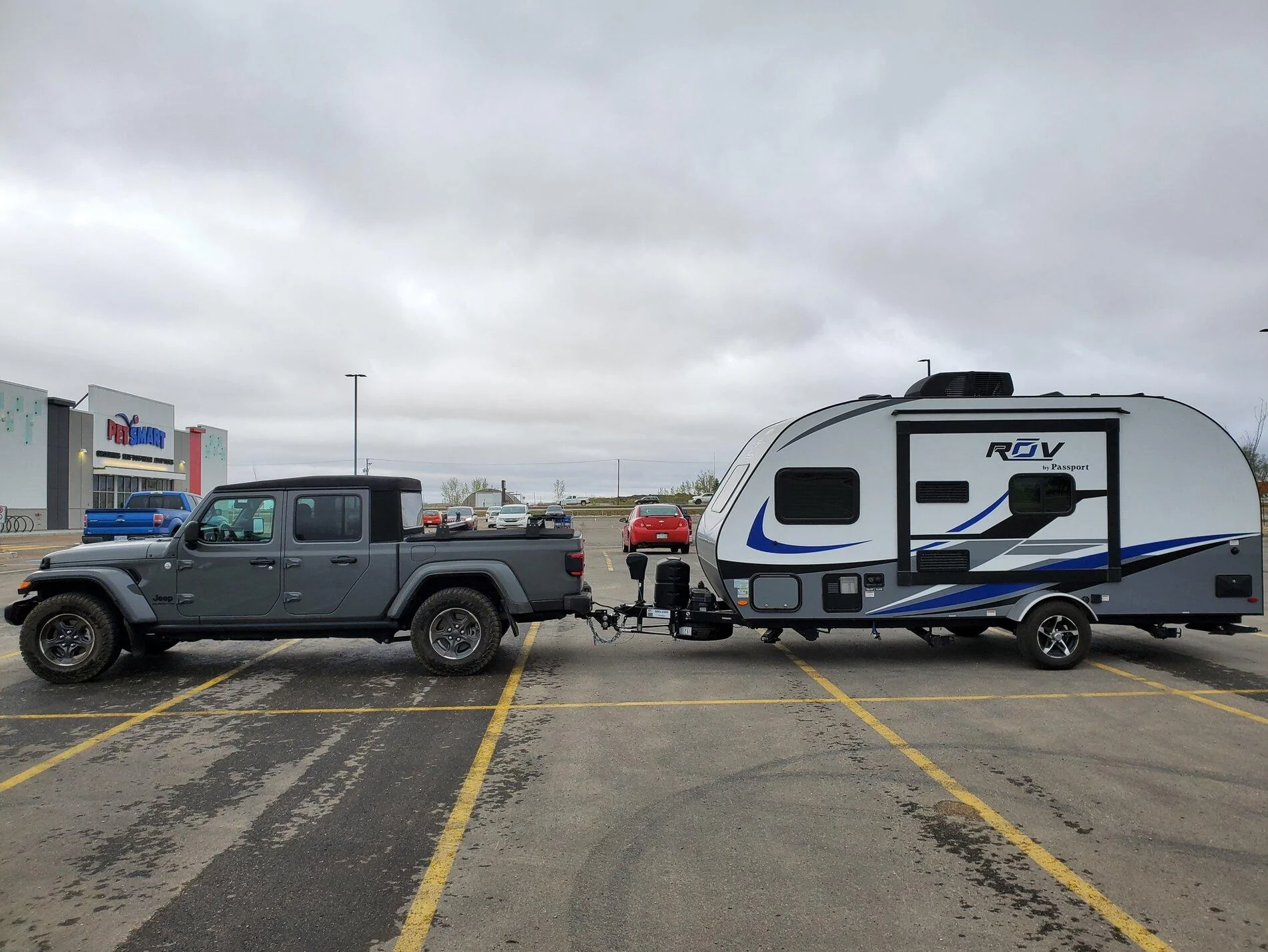

So I took this on a three hundred mile round trip this pass weekend and parked it at Maumee Bay State park by Toledo. I live on the other side of the state and it was mostly level driving. I averaged 18.1 MPG and was on cruze set to 60 MPH most of the way. Only one long grade hill it dropped to 6th gear but the rest of the time it ran in 8th & 7th. Loaded with camping gear in bed and trailer I grossed 7560#. Camper dry w/tongue weight is 2500#.
I left the camper there while I went up to Flint MI to shoot. I passed through Toledo going as well as coming back, never saw a Gladiator on the road but I did see several Broncos for the first time. I would have thought if ever there is a place to see a Gladiator on the road it would be there.
