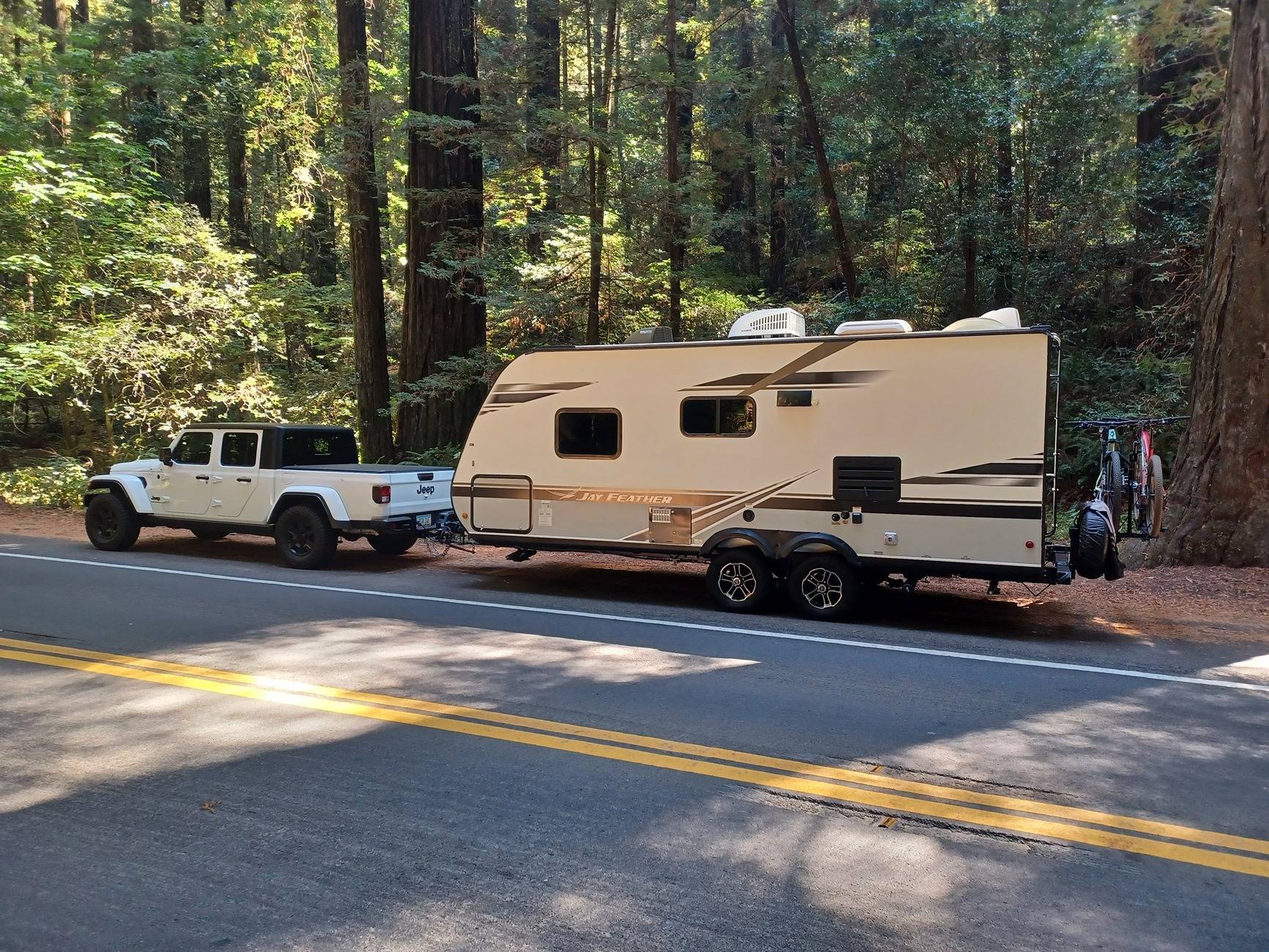

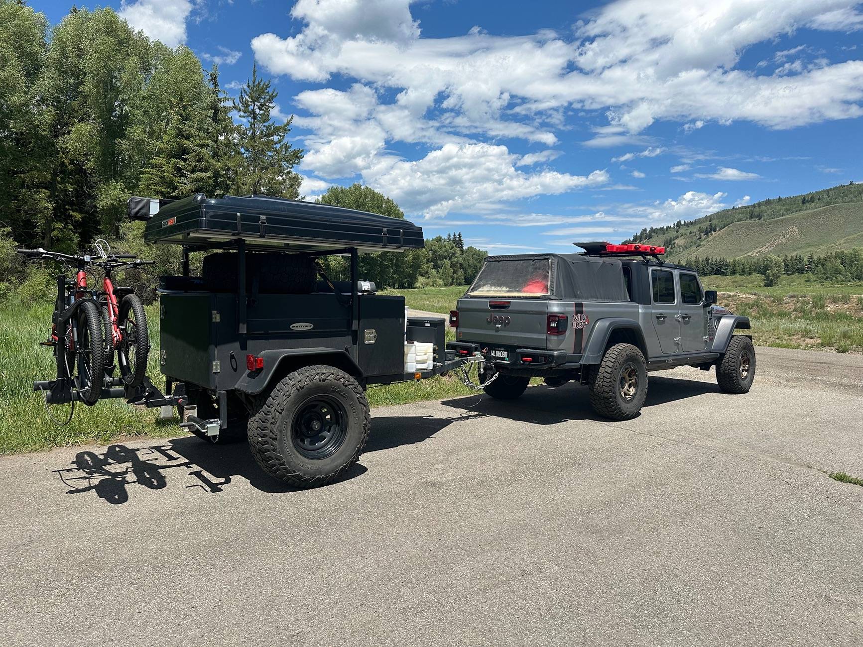

My Max Tow Pkg Gladiator on this trip with 2 people, 1 small dog, full tank of fuel, generator, recover box, firewood, chairs, traction boards, inflatable stand up paddle board, Inflatable Kayak and 4 gallons of extra fuel, was 50lbs under the gvwr including the hitch and tongue weight. Trailer weighs 5100 fully loaded.
It tows the trailer with the above weights just fine at 60mph and climbs hills fine at about 4k rpm. I averaged about 11mpg on a 4k mile trip which included a lot of elevation gain and altitude. I have 33" tires.

Can you show me your bike rack set up? Looking to put on on my trailer for 4 bikes.
MTB58
Marty
Mar 16, 2024
118
295
Prescott, AZ
2023 Sport S Max Tow
Sales Mgmt

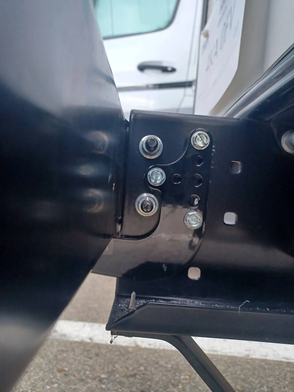

My trailer is in storage right now, so I won't be able to take any photos yet.

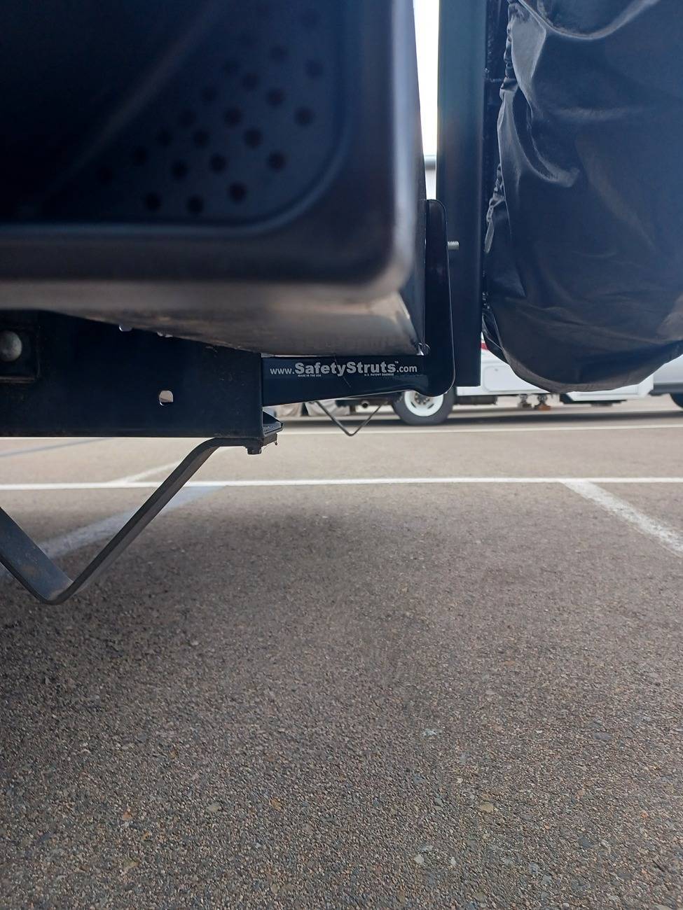

For my lightweight Carbon MTB's I used a bumper mounted receiver hitch mounted on top of the bumper which is very limited on it's weight capacity because it's mounted on the very flimsy bumper. I reinforced the bumper with Saftey Stuts which are designed to help the rv bumper from breaking off due to the extra weight. Total weight for my two bikes and bike carrier was around 100 lbs.
I have since purchased an adjustable width reciver hitch and had my friend who owns a fabrication shop weld it onto the trailer frame with the receiver part on the top of the bumper. I had it done this way because I don't want to drag the bike carrier entering or leaving gas stations or driveways. The hitch is strictly for bike carriers or cargo carriers, because even though it's a receiver hitch welded to the trailer frame it will not support towing.
If you plan on carrying 4 bikes you will definitely need a welded in receiver hitch. Something else you will need to pay close attention to is the type of bike carrier you have. Most bike carriers are not rated for the back of motorhomes or trailers due to all the extra bouncing they are subjected to. I am currently using a Rocky Mounts 2 bike carrier.
Another thing to consider is the weight on the back of the trailer will lessen the tongue weight on the tow vehicle, probably not pound for pound but it will lessen the weight and could change the towing characteristics of your trailer.
Lots of stuff to thing about just to carry 2 or 4 bicycles maybe 200lbs total.
If I get a chance I will go over to the storage yard and take a couple of pictures for you of the new receiver hitch.

This is exactly the advice I was looking for!!! I was worried about just mounting a bolt on receiver to the bumper. I was thinking about finding a weld in receiver as well. I also had never seen or heard about the safety struts. Looking into those now. Thanks a ton!!!!

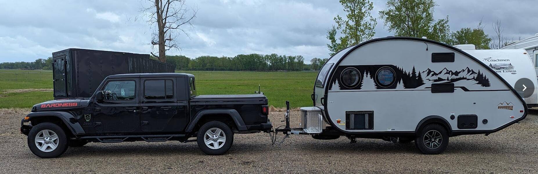

Our rig as of last May, there's been a few minor changes, new wheels / tires on the Jeep, a better bike carrier on the tongue of the camper...
Jeep Gladiator So, what is everybody towing? 1746377651956-x6
2022 with tow package (wish I'd known about max tow) and a 2022 nuCamp T@B 400 Boondock

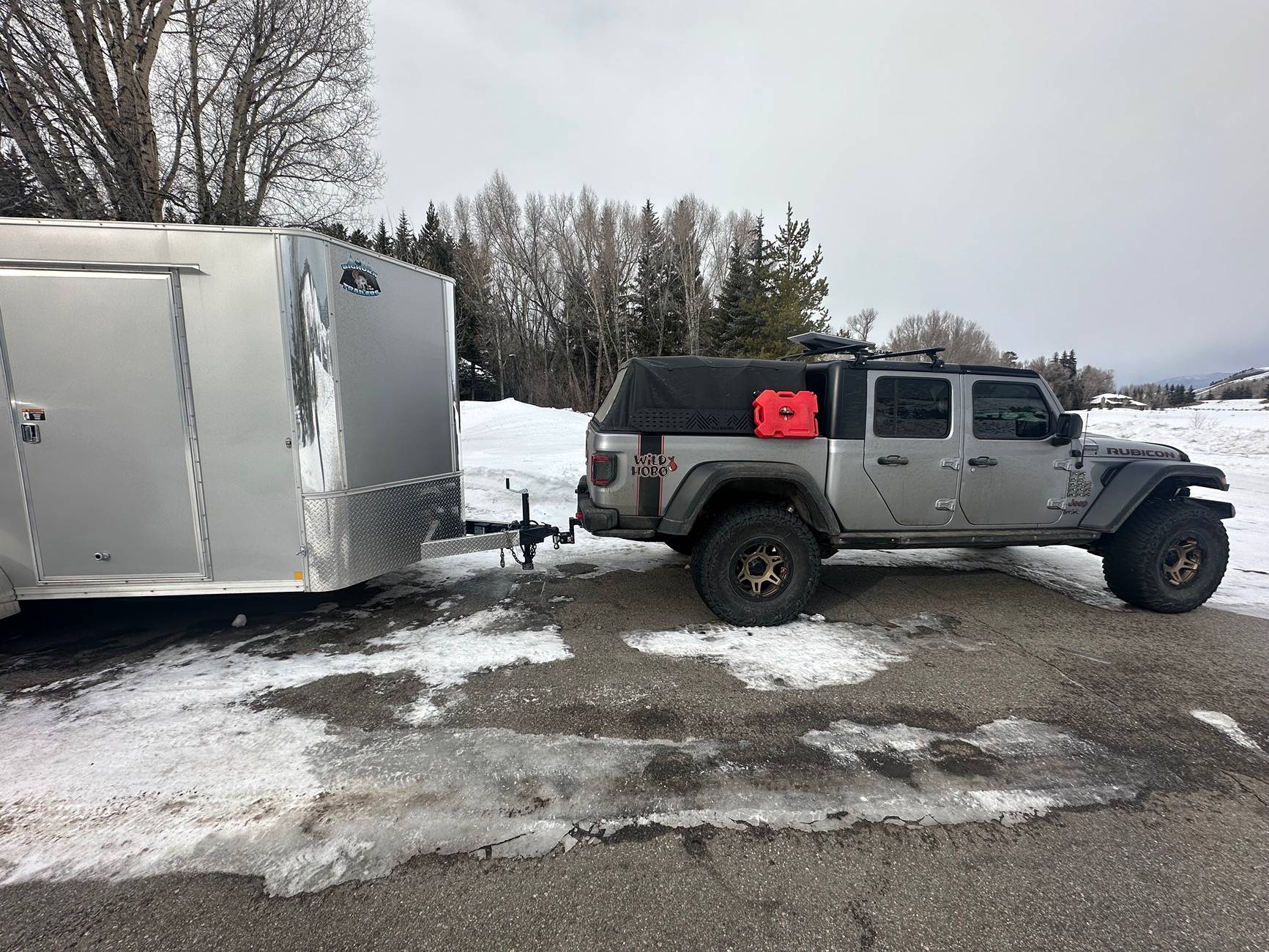

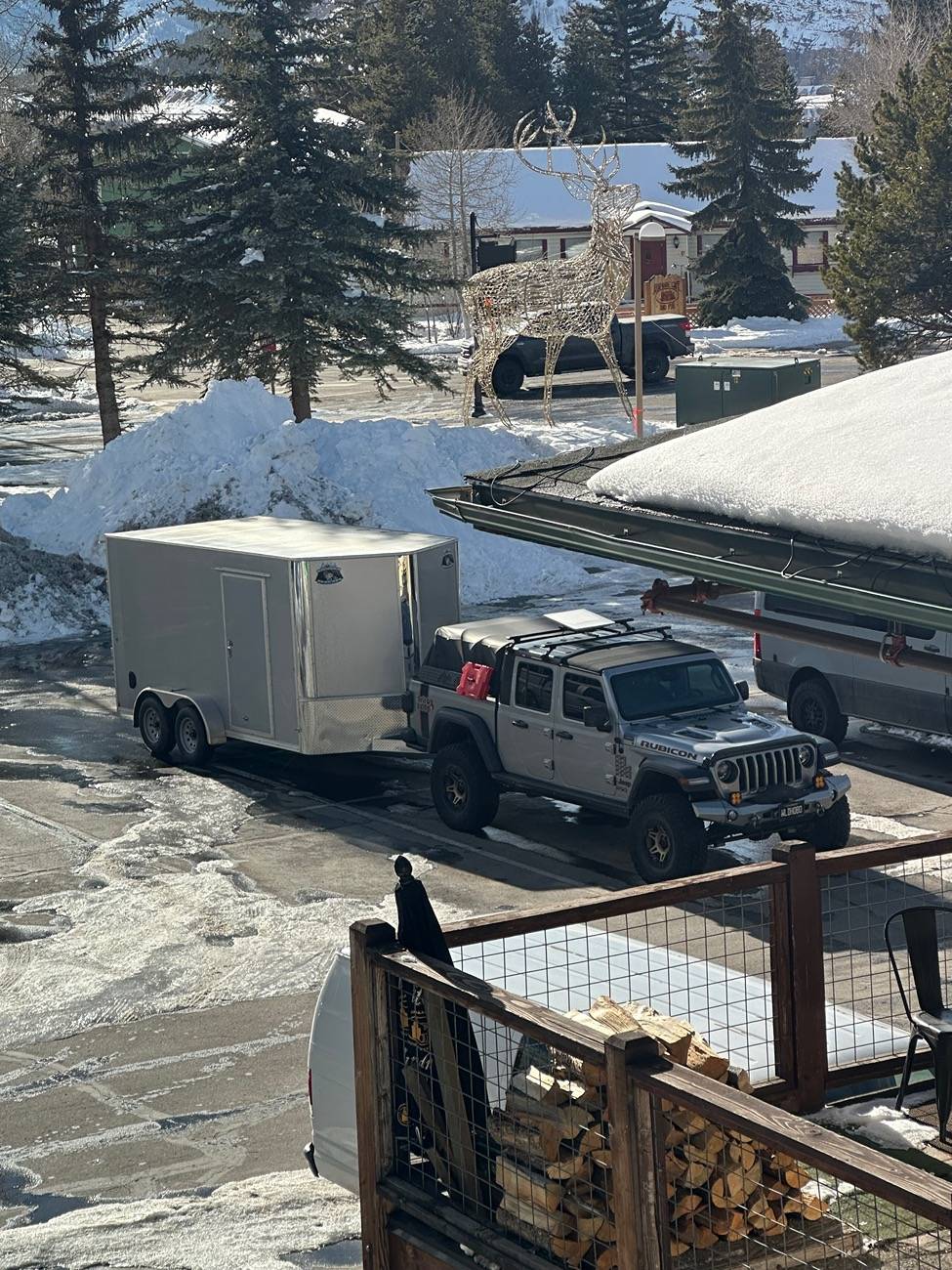

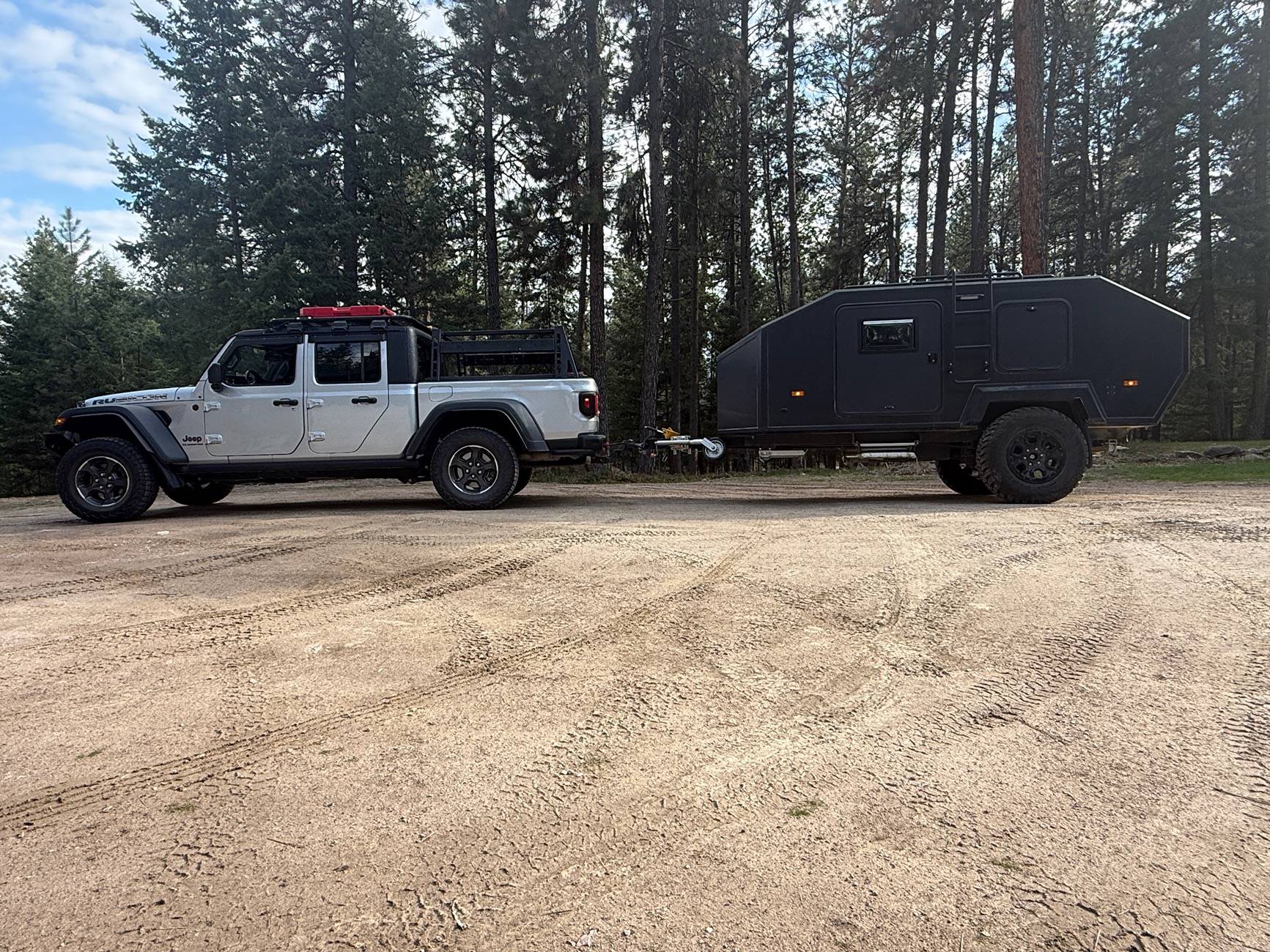

Smittybilt Scout on 37” Mickey Thomsons. Something like 3,300lb gvwr
14’ tandem enclosed cargo w/ 7,000gvwr

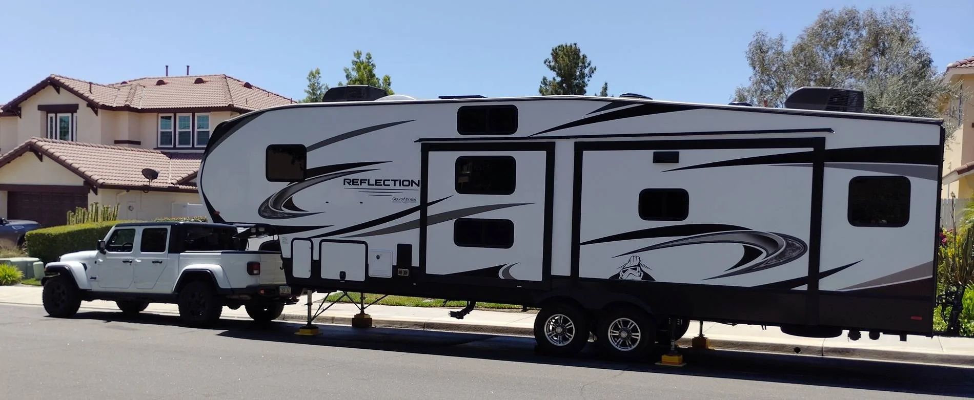

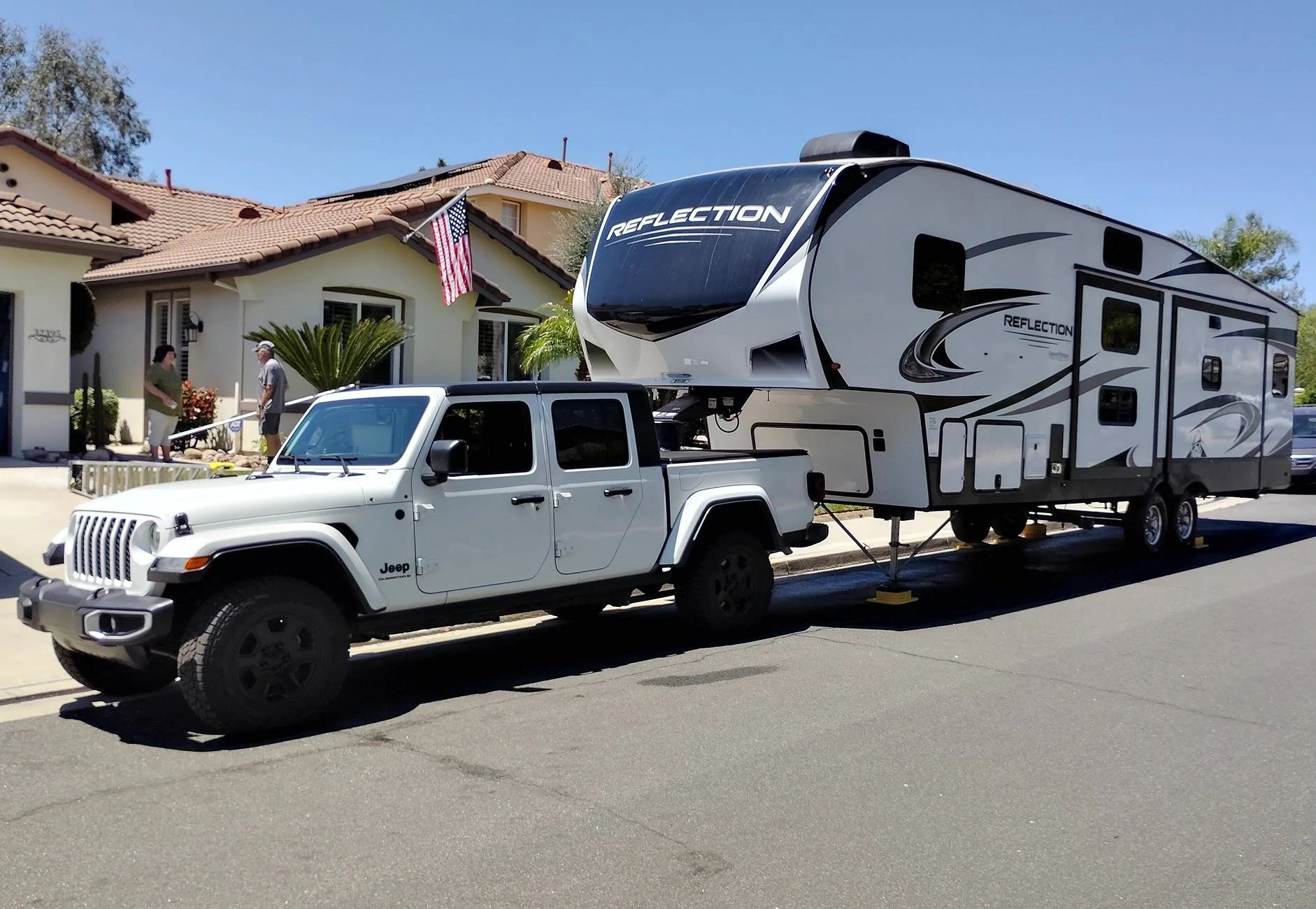

Just bought a new trailer, thank goodness I have Max Tow 5th Wheel edition with air bags.
Pin weight 2300, 12,000lbs loaded, average 13mpg at 75mph and I don't even know I'm towing anything.
40,493
54,044

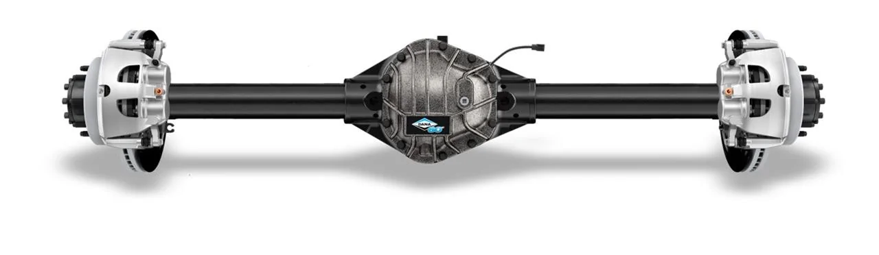

Just curious - WHICH axle is under that again?
Poser!
