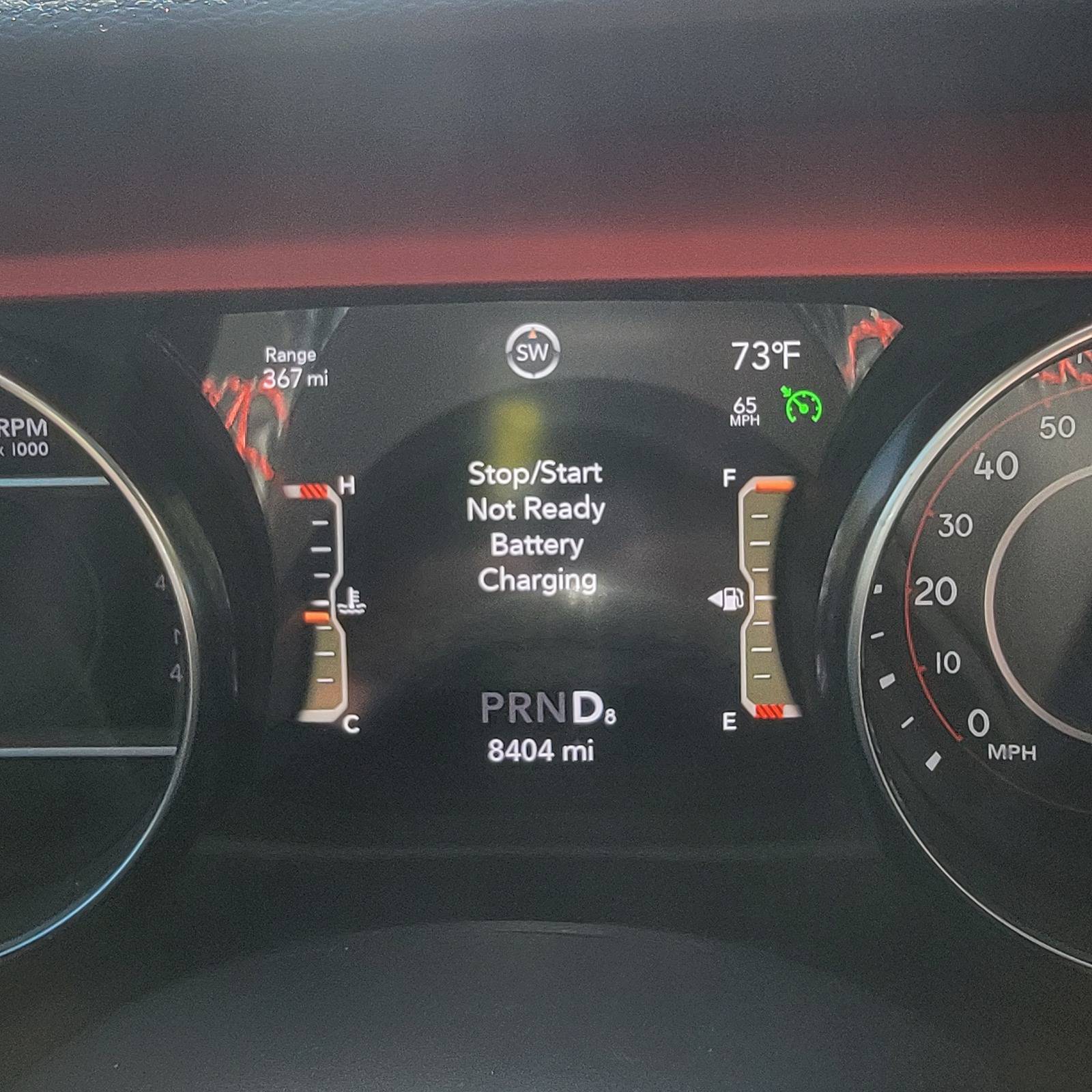

This information isn't accurate. It will tell you "battery charging" quite frequently. It doesn't need to get to the breaking point to tell you that, just a state lower than ESS's operational threshold based on IBS information. Once the IBS indicates the batteries have recharged enough, the system will start working.
The "AUX Switches Unavailable" message is more a result of the overall system status at start-up, not an ongoing ESS monitoring situation. But I agree that seeing that message is a good indicator that batteries likely aren't holding charge like they should.
When the EVIC tells you nothing under the 'not ready' message, like OP is experiencing, it could be literally anything that doesn't have a pre-programmed message. I would agree that batteries would be my #1 suspect, but let's not say it's the only suspect, or that the EVIC will never tell you the battery needs charging.

Yes, I read this, and it's incorrect:
It will show various messages for conditions that keep ESS from activating. It does not show specific messages for anything battery related, just the ESS not ready message.
I'm trying to clarify what happens for those reading this thread as I can already see it's being misinterpreted. You've got OP thinking that since the EVIC isn't giving a reason for 'start stop not ready' that it immediately means the battery is the issue, and that the EVIC will never show a battery-related message until it's completely crapped out.

Well, you are, whether you want to believe it or not. Not saying you didn't experience what you experienced, but the EVIC 100% can and will often show battery-related messages. @SargeDiesel already posted a picture of that very thing. Your choice to accept that or not.
I'm just here trying to help by making sure we're all sharing the right information rather than trying to create new facts from anecdotal experience. I totally believe that you may have never received that message, but let's not turn that into "it will not show you a message". That's just not right.
