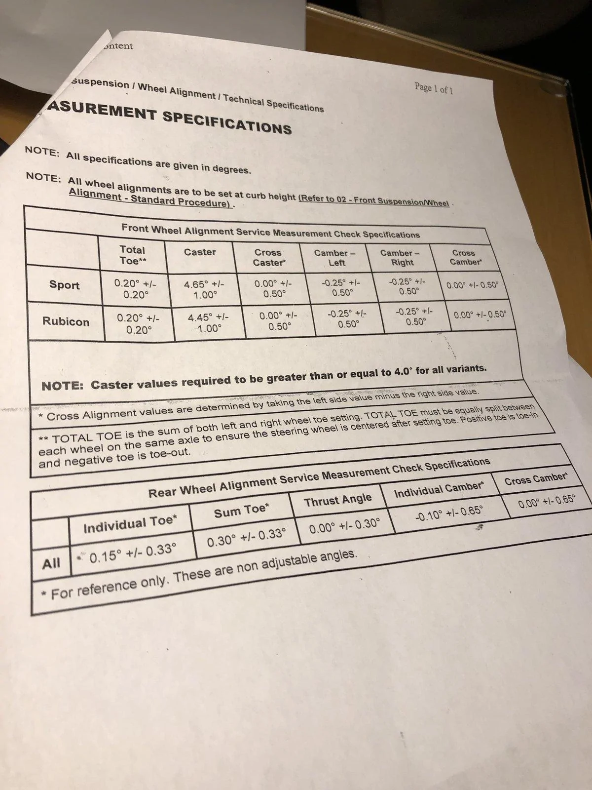

I have the same issue. Steering wheel must be 2-4 degrees turned to the left to go straight or else it will drift right.
Had the alignment checked and all was within spec for what can be adjusted. Rear toe might be the culprit.

According to FCA, toe is within spec tolerance. :(I’ll see if the wheel is the culprit.
I'd argue a bit with the FCA people. Drive wheels tend to toe-IN under load, or while driving so to have toe-IN on a rear wheel that is driving the vehicle is counter-intuitive. They should be neutral (0 toe) to a slight toe-out so that when driving they pull in and achieve near 0 toe.
Front wheels on rear wheel drive vehicles you want a bit of toe-IN when stationary as they will tend to pull out when being DRIVEN. You should not normally have toe-out on the front wheels of a rear wheel drive vehicle.
Granted it's not a lot on that chart - but it's the difference that counts, too. If one is toe-out and the other toe-in it would tend to dog-track if too far exaggerated.
I don't know if they'll keep those "specs" or not but knowing auto history and having worked in the field for decades, doing tons of alignments (granted, pre-1990 vehicles to be fair), I've seen companies change specs mid-stream. Good example is my SX4 - the TSM (technical service manual) came out early model year 1982 (so late 1981) - all of the alignment equipment companies, book companies like Chilton, Motors and others used that spec. They changed the spec a fair amount with a TSM supplement in late 1982 model year BUT all of the book companies to THIS DAY have the old spec -and guess what spec the alignment equipment makers use and publish...... yeah, the old spec. They had issues with the first specs and found things were much better with the later specs and yet to this very day, only people like me with the supplement know the correct specs for that car. And the alignment shops refuse to deviate from their published specs in their computers even if I show them the bloody book!
