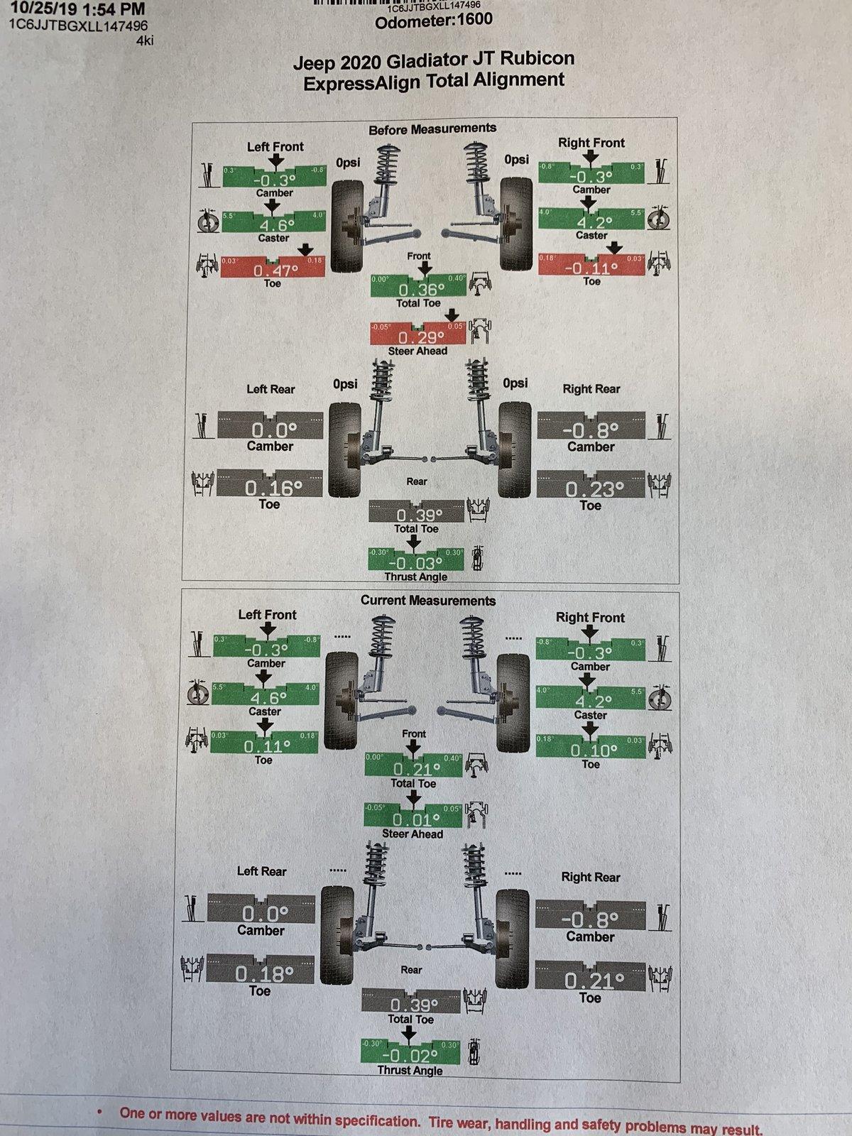

Been following this post and another one, didn’t wanna say much until I had a chance to really get a feel as to what mine was doing. I had a 9 hour drive home with mine after purchase (bone stock JTR) and I honestly wasn’t sure I was gonna make it, it was windy and the trucks were blowing me all over the road but as night came the wind and trucks died down and it was almost a dream to drive, still the occasional wander but wasn’t bad, hey it’s a box right? Next morning I aired the tires down from 40 something to 36 or 38 and it was much better but still wandered. Soon after I installed new wheels and 35” Ridge Grapplers, played with air pressure and got a little better. What I honestly felt was in ideal weather conditions it handled just fine, tracked straight as an arrow no wander, get it in windyconditions or semi trucks and it was very frustrating. After reading on this post and the other post and various FB ones I decided to have the alignment checked. See attachment below of the before and after, I also had them check the torquesettings, some were correct and a few took a half turn to torque. So the ride home from the alignment shop was ideal, steering took less input and was notably tighter and it didn’t wander, any steering input was instant. Did several miles highway around semi trucks and it was a completely different experience. I am100% satisfied with what was done that I could just leave it alone and drive it how it is however I am curious as to what airpressure will do so I will experiment with that, I also wanna see what a steering stabilizer will effect so I may try one as well but in no way do I feel I need one. I also wanna add that I used the alignment specs given on here and requested the total 20° toe, didn’t want to just get it close. Hope this helps.

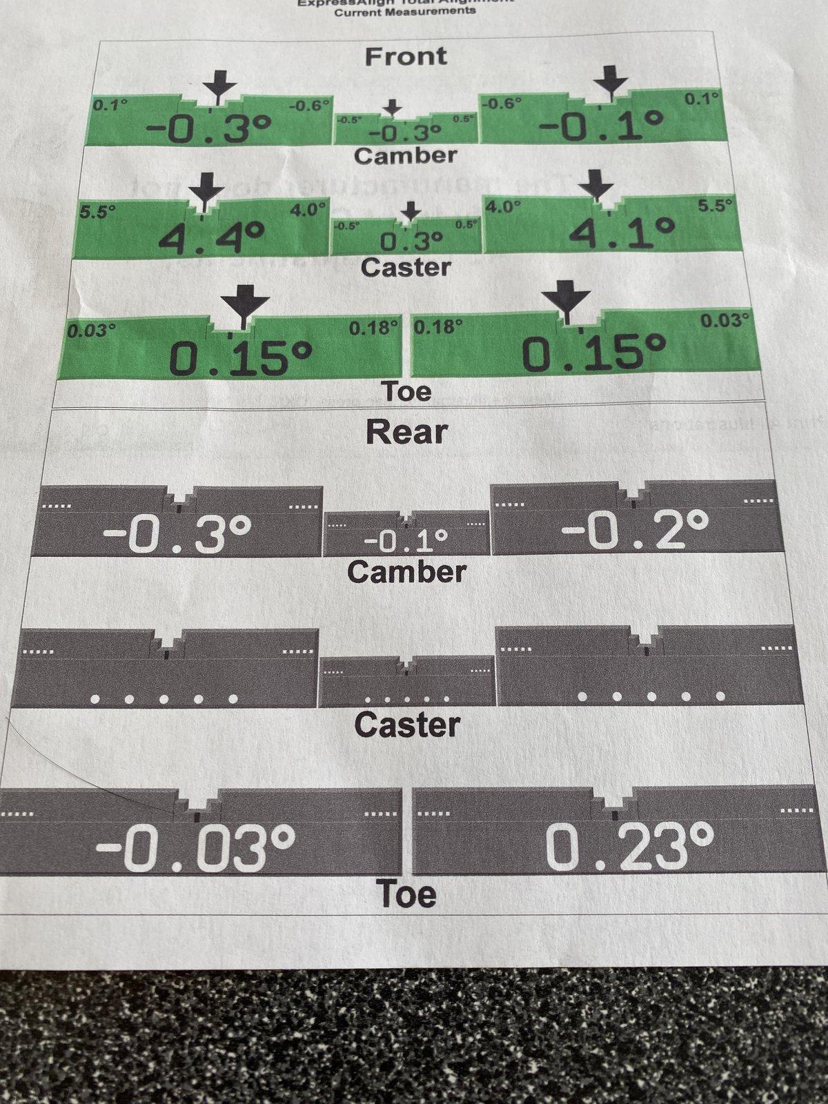

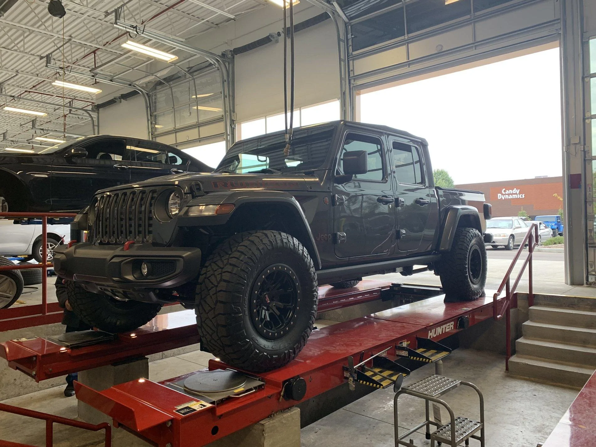

Picked up my LE today and test drove it, was very windy drifted to the right but not bad. Tires have been replaced to 315/70/17 which is a 34.4x12.7 (35) from the stock 32.7x11.2 (33). Tire pressures 35-37 cold. Stock Wheels.
Jeep had 30 miles on it, put it on the alignment rack and referred to the supplemental FCA alignment specs. Toe was off a significant amount, toed in. Left side Caster was out of range.
Once we got our readings we made adjustments and as the toe and steer ahead fell in to place so did the Caster.

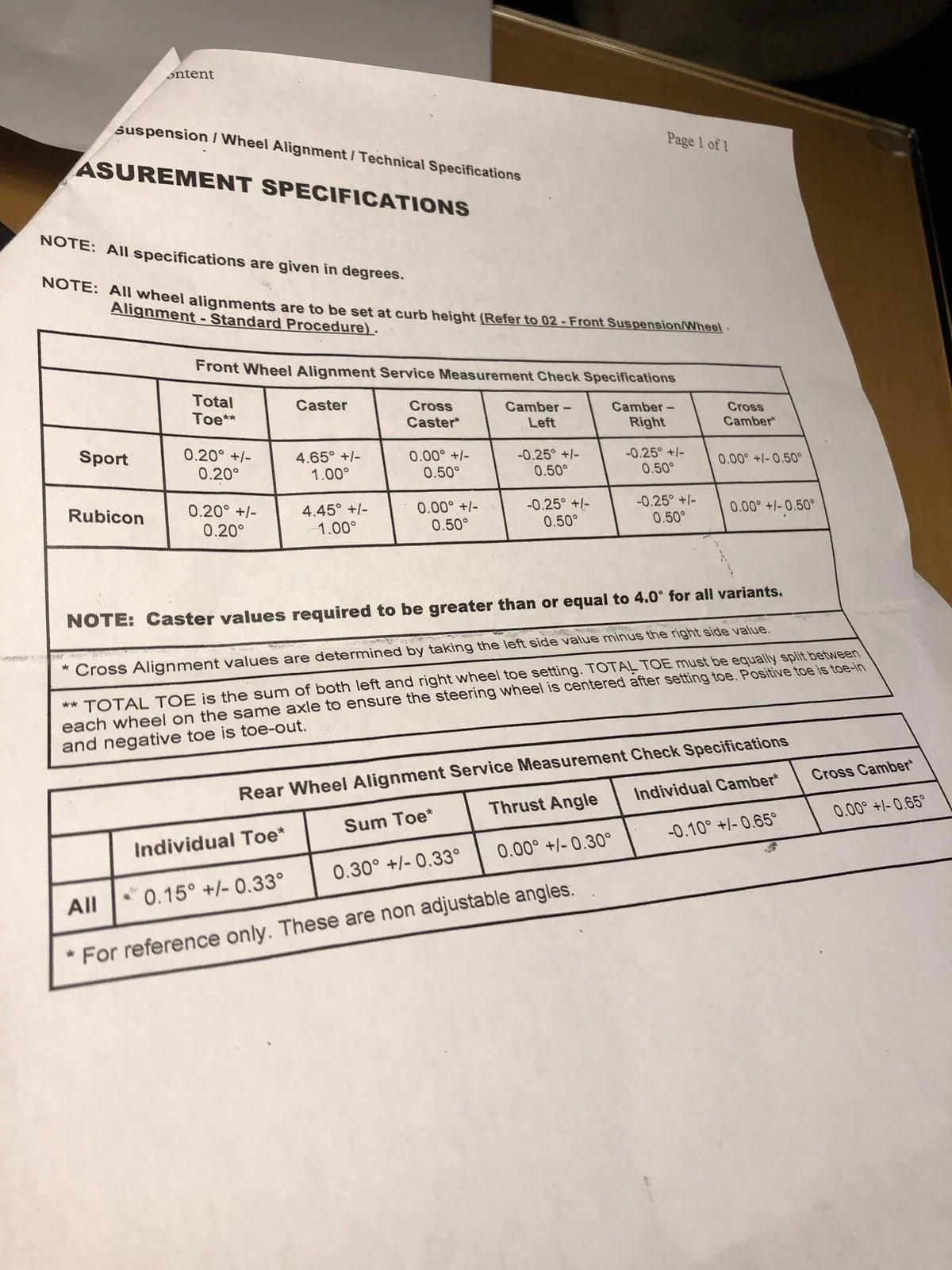

Please see the FCA Supplemental Alignment Specs, notice the Caster numbers, mine is at the bare minimum range of what FCA wants to see. THESE ARE NOT THE NUMBERS AN ALIGNMENT MACHINE WILL SHOW YOU, THESE NEW NUMBERS ARE TOO NEW TO BE IN THE MACHINE.
For those of you with lifted JT's remember the Jeep goes up the axle rolls back and the caster number goes down. If mine is stock and I am at the bare min then lifted Jeeps will be off the spec chart. Would it effect steering in a negative way? Who knows I have seen these coil spring solid axle Jeeps do some strange stuff. When the stuff is in spec it tends to be ok IN MY EXPERIENCE!!
