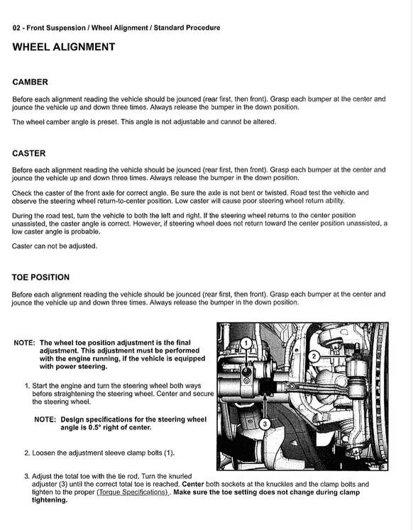

I was looking at this thread and noticed my cross caster alignment is slightly out of spec 0.6 vs +/- 0.5. I posted the alignment here : https://www.jeepgladiatorforum.com/forum/threads/loose-steering.16550/page-20#post-398047
I called a dealer and they said there is no caster adjustment? So what do you do if it's out of spec?
Jeep Gladiator Steering Issue with your JT- some info for you Screen Shot 2019-12-03 at 5.30.55 PM
"Cross caster" or the DIFFERENCE in caster between left and right cannot be changed, period. Axle swap is the only way.
CASTER can be changed with different lower control arms but, for example, if you change the caster .5 on one side it changes it .5 on the other side too since you are turning a solid TUBE. You cannot change the left and right independently.
So if the difference should be .5 with one side being .5 higher than the other and the difference is much more, you can't change the difference, not at all.
Camber also cannot be changed - period. Only IFS allows this. Camber is built into the axle components.
So two things can't possibly be changed- CAMBER and the DIFFERENCE in caster, or "cross caster".
Caster can be changed, lower control arm change (but not to factory stock as those are all identical - you'd have to change to adjustable or lift kit arms)
Take a long cardboard tube - can you move only one end of it with the top of the tube farther ahead than the other? No. You can move both at once the exact same amount.
The front axle is a long solid tube for all practical purposes.

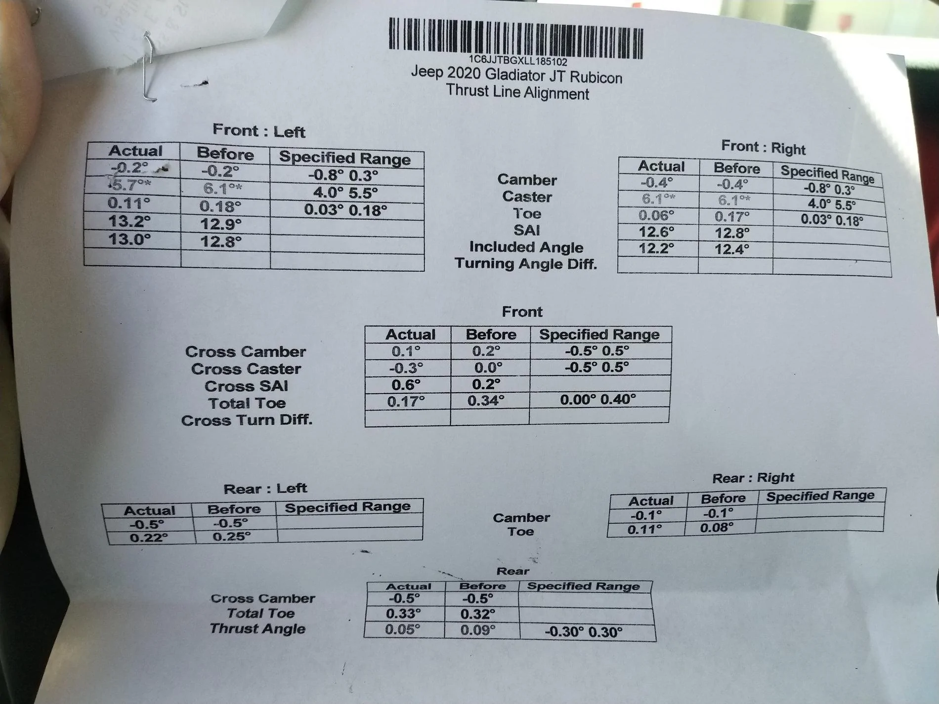

Been following this post and another one, didn’t wanna say much until I had a chance to really get a feel as to what mine was doing. I had a 9 hour drive home with mine after purchase (bone stock JTR) and I honestly wasn’t sure I was gonna make it, it was windy and the trucks were blowing me all over the road but as night came the wind and trucks died down and it was almost a dream to drive, still the occasional wander but wasn’t bad, hey it’s a box right? Next morning I aired the tires down from 40 something to 36 or 38 and it was much better but still wandered. Soon after I installed new wheels and 35” Ridge Grapplers, played with air pressure and got a little better. What I honestly felt was in ideal weather conditions it handled just fine, tracked straight as an arrow no wander, get it in windyconditions or semi trucks and it was very frustrating. After reading on this post and the other post and various FB ones I decided to have the alignment checked. See attachment below of the before and after, I also had them check the torquesettings, some were correct and a few took a half turn to torque. So the ride home from the alignment shop was ideal, steering took less input and was notably tighter and it didn’t wander, any steering input was instant. Did several miles highway around semi trucks and it was a completely different experience. I am100% satisfied with what was done that I could just leave it alone and drive it how it is however I am curious as to what airpressure will do so I will experiment with that, I also wanna see what a steering stabilizer will effect so I may try one as well but in no way do I feel I need one. I also wanna add that I used the alignment specs given on here and requested the total 20° toe, didn’t want to just get it close. Hope this helps.

That’s crazy, I’ve never been able to get my alignment from any dealership that precise before, everything being almost dead center, would love the same results on mine.
