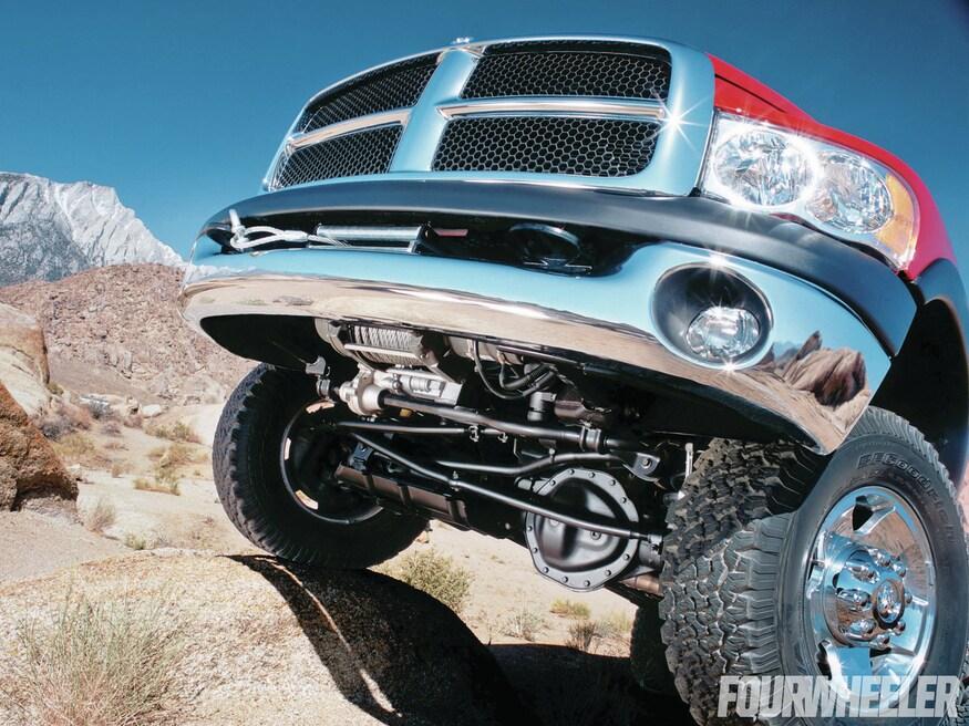

Dodge Power Wagon AAM solid axle
Solid Axle Awesomeness
First off, I must say that I have driven some great riding and handling solid-axle trucks and SUVs. The one that comes to mind first is the ’11 Ford Super Duty F-250. The suspension engineers nailed it. At that year’s Pickup Truck of the Year competition, I was stunned by the trucks manners at speed, whether around town or off-road. Even with its unsprung axle mass, the truck offered up civility and function that was on par with IFS pickups in my opinion. That truck destroyed the argument that IFS has vastly superior handling and ride quality.
The simplicity, ruggedness, and swapability of the solid axle are second to none.
My biggest gripe with IFS is its complexity. A solid axle has less moving parts and is easier to service, with no crossmembers clogging everything up. I also don’t like that the centersection in many new IFS rigs is made of aluminum. Solid-axle centersections are typically cast iron, which is more durable. Some IFS systems also have weaker steering systems than solid-axle-equipped rigs. The solid-axle steering also isn’t susceptible to extreme camber and toe changes under load and cycle as an IFS rig.

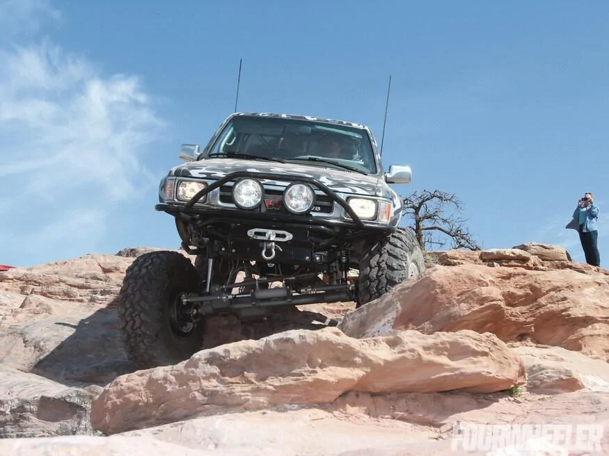

Some IFS rigs utilize torsion bars, which can create a catch point off-road. And when lifting an IFS rig with torsion bars the bars either have to be lowered amidships or raised at the frontend to compensate for the lift. And speaking of lifts, a solid-axle rig is far easier and less expensive to lift than an IFS-equipped rig. And on the subject of modifications, let’s say you’ve added larger tires to your truck or you’re demanding more from it in a work environment. With a solid-axle rig you can get a larger centersection that is capable of handling more abuse by simply swapping in a heavier-duty axle. Not so with IFS. Unless you want to spend a boatload of money to re-engineer your entire IFS system (or swap to a solid axle) you have to stay with the differential that came on your rig.
When it comes to off-road travel, as one side of the solid axle is forced up or down, the other side is forced in the opposite direction. IFS doesn’t operate this way because each side is working independently. This means that the solid axle has more chance of traction than with an IFS rig.
Summary: In most situations the solid axle is the hot ticket for 4x4s, whether they’re used for work or play. The simplicity, ruggedness, and swapability of the solid axle are second to none. –Ken Brubaker
