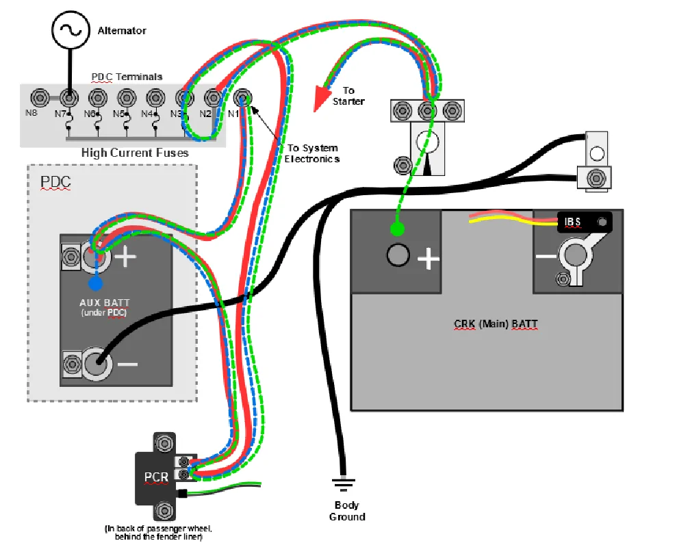

The factory switches aren't dependent on the aux battery status either - they are dependent on battery voltage - including the main.
I've said this a dozen times - my wife's JLU will give her a message "aux switches unavailable" and her JLU doesn't even HAVE an aux battery. It's a 4xe.
If the battery voltage gets too low it disables the switches until the battery is charged again.
I'd bet the others are set that way as well.
people need to drop this thought that aux battery = aux switches. Aux only means auxiliary, and the switches do NOT run from that battery alone. Both batteries are connected together.
Frankly, I'd want my switches to not work if the battery voltage got too low - it might prevent being stranded somewhere. Smart engineering on Jeep's part.
The AUX switches are dependent on the AUX battery, but it's the check logic in the computer that enforces AUX battery level so the AUX switches can draw off the main. I hope with all this blow back on the EV mandates, there will be a similar recoil on all the auto stop/start crap as well......
40,442
53,860
Sorry, the aux switches depend on battery voltage, the average of the pair, not the aux battery.
There is NO AUX BATTERY on a 4xe, and yet you get the same message.
Since the batteries are connected in parallel at all times - your logic is totally lost.
There is no way for them to be switched from the aux battery to the main since both are connected to each other. Not sure where you get the BS from that they rely on the aux battery.
gee, look at this - there's no way for the aux switches to work off any singe battery, they ALWAYS work off the pair, and it's total battery voltage that matters, not the aux battery.
There's no way in any "logic in the computer" to determine where the loads are coming from - it's always both. (except for milliseconds during an ESS restart)
Logic in the computer :LOL:
